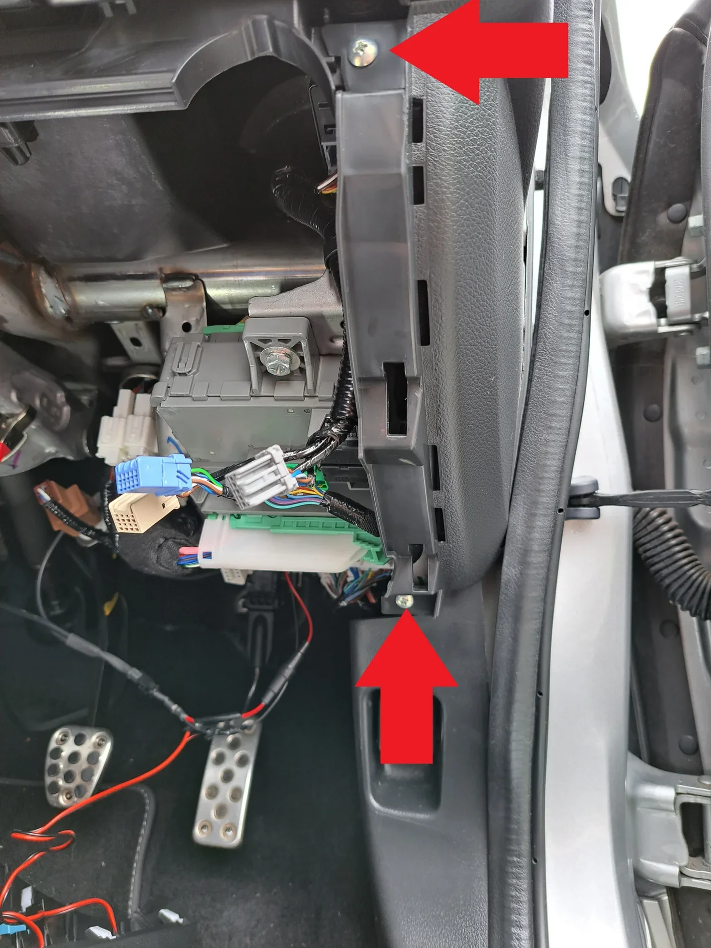

Now you will see the fusebox under the dash. #1 is the Switched Accessory fuse, so the obvious choice for the ACC wire. #32 on mine is empty and has a constant live feed. Although the Earth point looks like its into plastic the bolt goes through to a metal bracket behind that is attached to the dashboard frame and earthed through the car, I tested it for continuity.
Fuse links and earth connected.

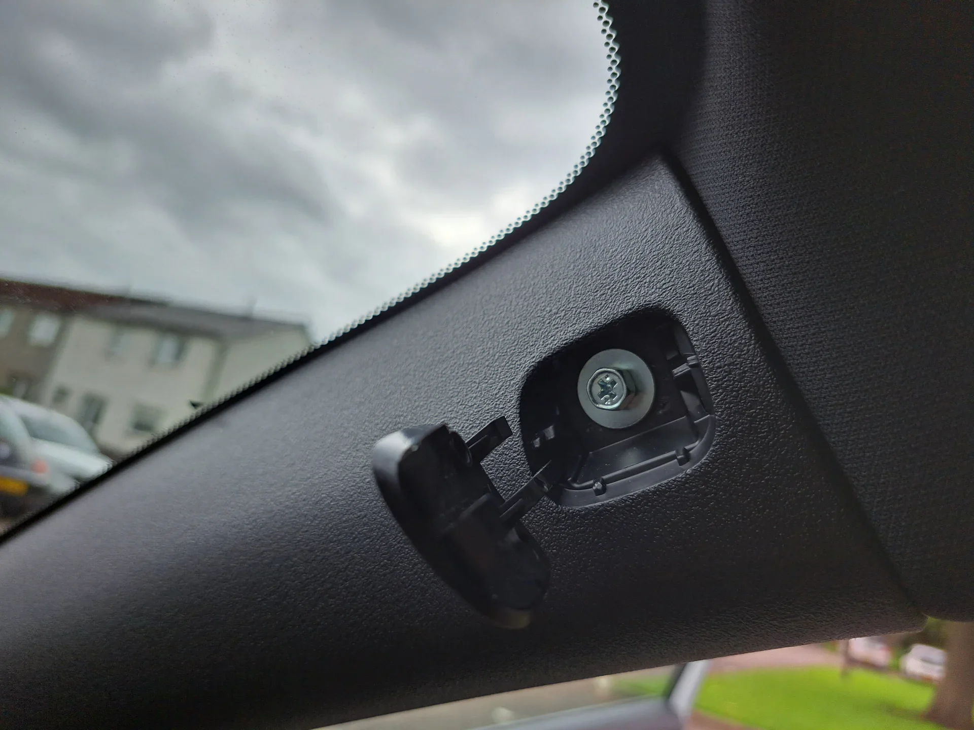

Next you need to remove the A pillar cover. Using a trim tool prise off this cover, there is a screw behind it.

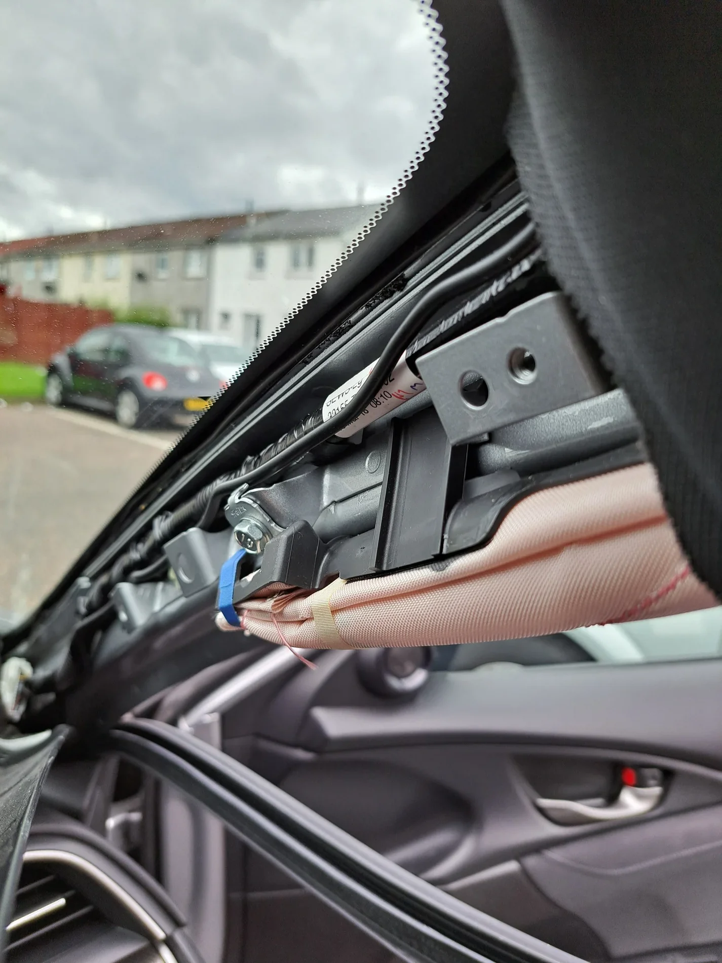

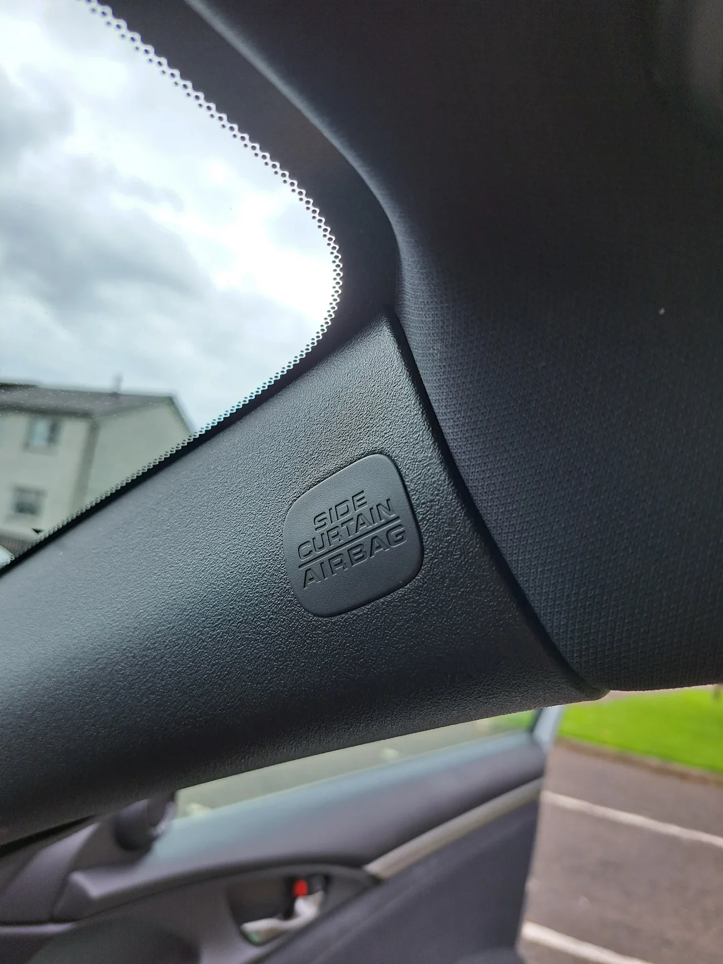

Pay attention to the airbag and route the cable up the A pillar then behind the head lining and connect to your dashcam.
