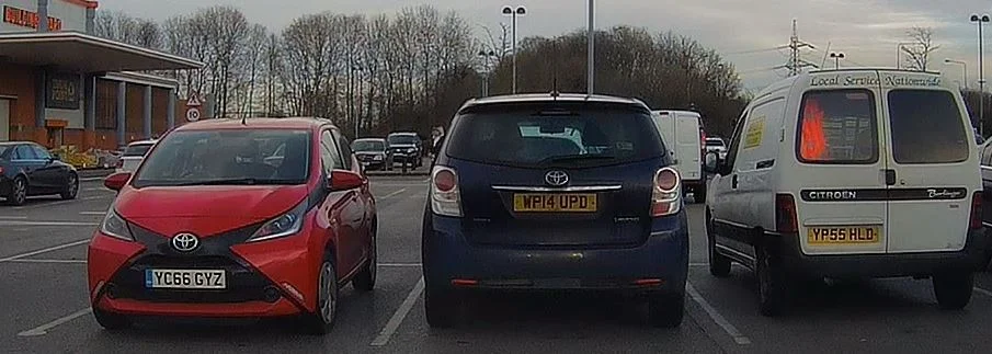

First off I'm going to look at static scenes both day & night to get a feel for the respective video detail, noise and dynamic range without any subject movement.
Daytime - 100% Crops

The F1 shows off its 4K resolution with far greater resolved detail than the Maxi. The F1 also has the best colour reproduction both day and night.

Day - Bright (1080p30)
In brighter conditions, the F1 running the highest bitrate preserves the most detail and accurate colour. The A129 loses detail through video compression and has muted colours. The Maxi sits in-between the two.
F1
y4mKSXv3Fd-ZipbedoiNJ4NBWDfFsisXZzYoZQBfMY63Kyz_IPT2K6JftNqQpq1CZ4JeHQHfofiXI1tHYX_XQLLYLe7JETk8rpWHIXHJoaEbi2VFdPA15JXHTGkv5Vog0ZXKN2H_ev0dTuCH9yoUZKE1VVs4rj6bwR-aB3OAVOV4ZqkRXq-Czy46NqiJRxovH70mgh9snmQMG7Z-uLXujahSQ
Maxi
y4mbwC_ZAKSUNuuQ10MqD1ltA282rTLljhG7SPuNoLYpjpO2L2QF-2oIfcXe5npg8ed_znWs5eLZe-y3VWNMfCeD3ZrfrfJNUZMxfaCNxBfqHGOttJPj0BXLUJVeHYLH4PdOLms3LQO_gwXaoDU4YZTgipQJsKCcUH-ky17uupZkk331c2uvStTYTG2g8gPnGjeFkieiONJf5NAVCf2_YR4wQ
A129
y4mr1FCUz51mMbw2xnclspJqx8csk9L40K5bm6pVNPIu7JmcihanJrWNWMcy3IQslNxLbY9Fe8xZIQMx9mmxBPLhMZCAk2yLJMoT1nsz7SF1jh0nzYfUc8pzhp23n8MtHi0Ia5elP7tjGUha-2NpORd_Fli-tK4Dj5Aj69nmqcPShv2nHJtguSKBhLx6-ZgkYRXymTGdh47hLwKF8IEG2sWfQ
