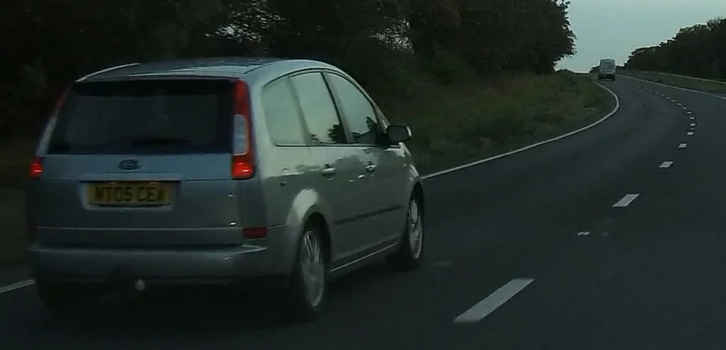

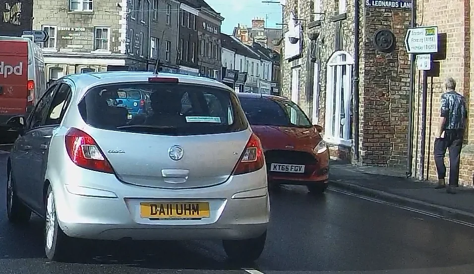

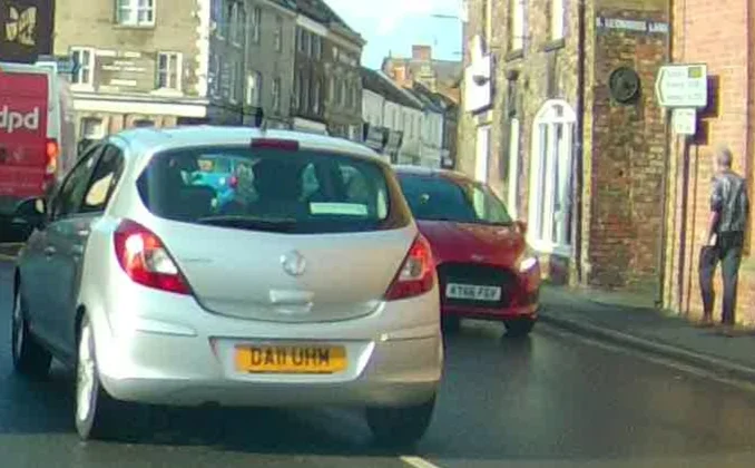

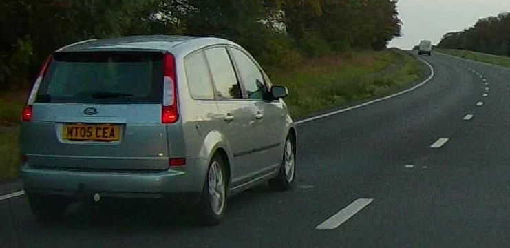

Daytime Video Comparison
F1C - 4k 30fps (29.97fps) - Superfine quality - 71.9Mb/s - h264
Maxi - 2.7k 30fps - Extreme quality - 60.1Mb/s - MJPG
Both cameras - No CPL / EV+0 / Default image adjustment settings
Side-by-side videos compiled at 4K resolution, so the Maxi 2.7k video has been upscaled to 4K
F1C has higher resolution, and resolves more detail
Maxi has lower contrast and/or better dynamic range for brighter shadows
100% Crop Samples
F1C
Maxi
F1C
Maxi

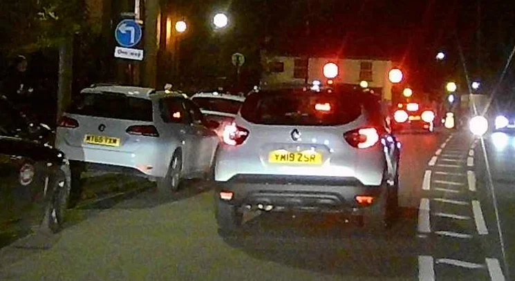

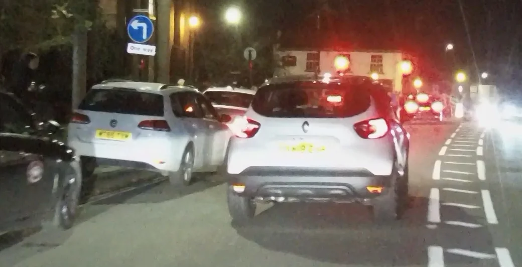

Night Video Comparisons
F1C is brighter, but loses highlight detail
Maxi has more noise, but less motion blur
Maxi exposure is more sensitive to bright highlights, at the expense of a darker overall scene
100% Crop Samples
F1C
Maxi
