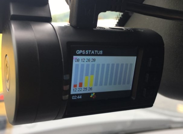

This is also around the maximum I got on a 1hr drive yesterday:

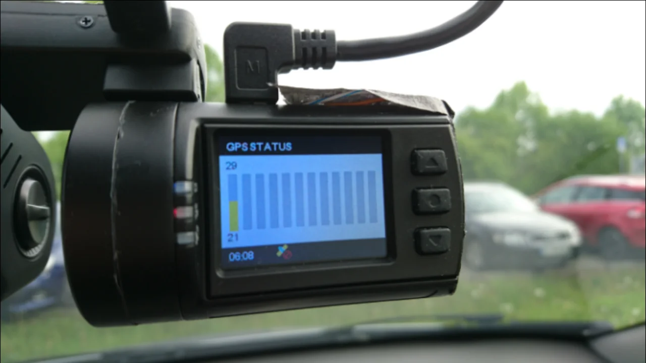

Ive found out why my 0906 doesnt get a gps fix. The other dashcam is too close to the gps bracket. After removing the Sg9665gc I get a valid signal
How do i get the camera to display the number of satellites like that ?
Hold ok button in and keep holding when you power on. To exit, power off.
Okay THX

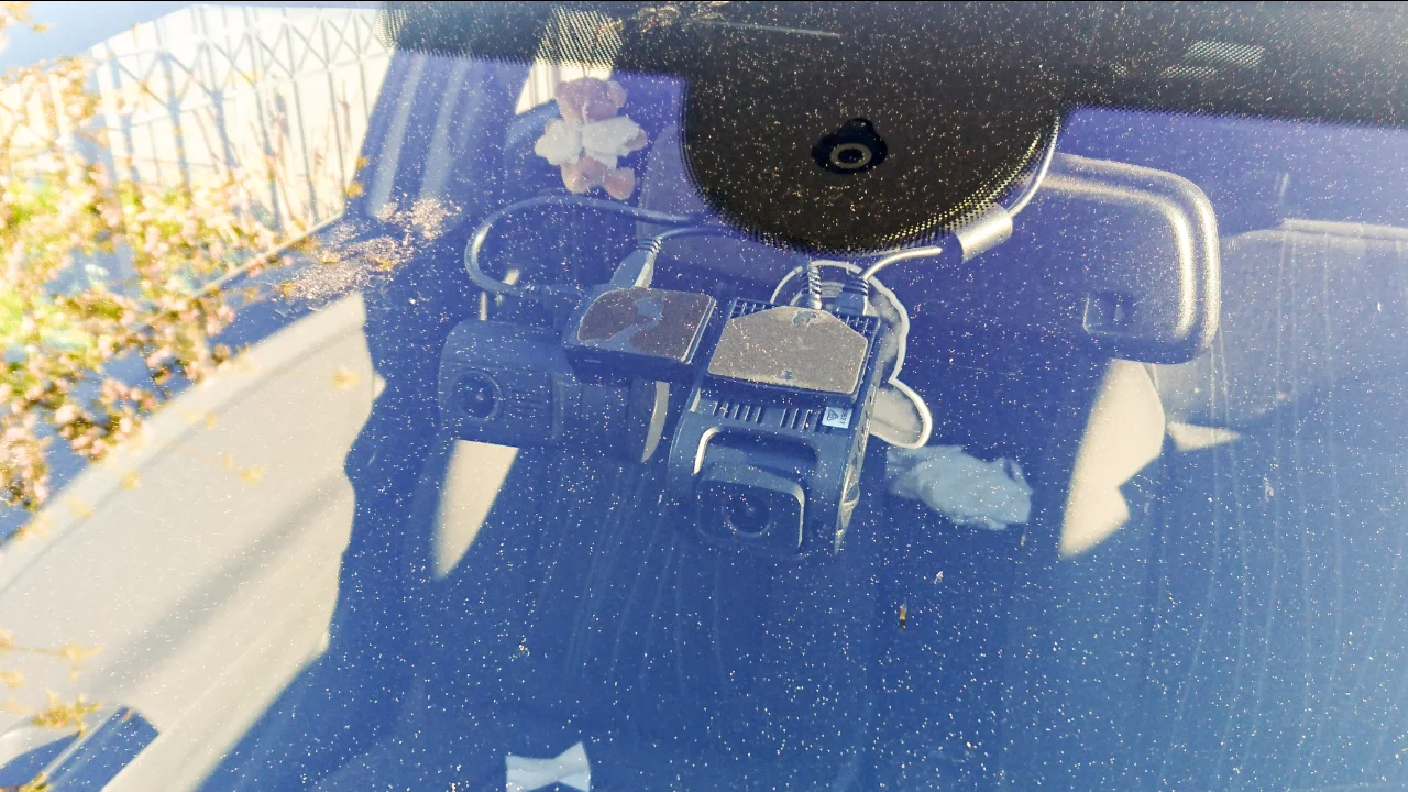

As you can see by the pic too, the 0906 are not really right up against the SG9665GC V3, and its GPS mouse are further to the left in the upper corner of windscreen.

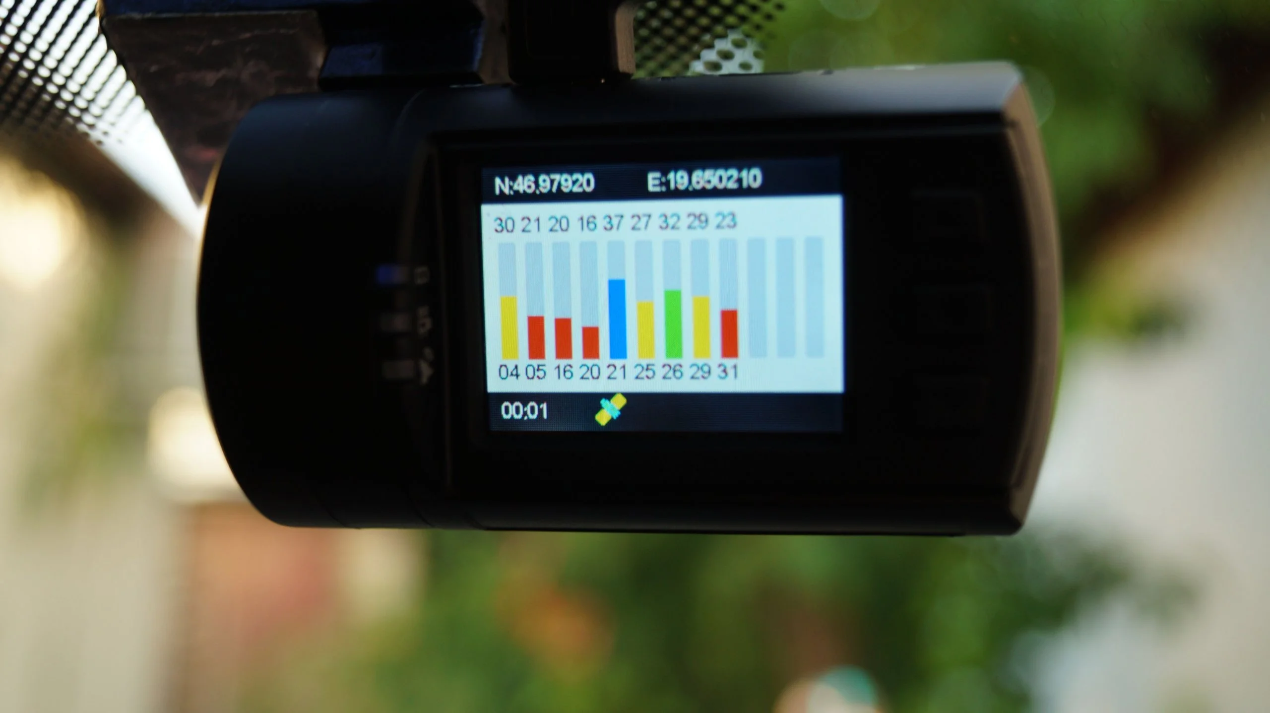

Took less than 1 minute for this cold boot.
O you can also see the warped plastic next to the LED's from my heating up camera for refocusing.
That is why the mini dash camera is much more difficult to design, produce, and maintain.
even a small GPS will suffer us a lot.
If you remove the rear cam, you will found the blue bars grow a lot.
means, the rear cam also bring interference to the GPS.
