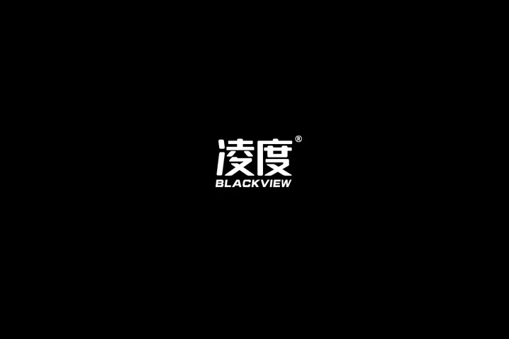

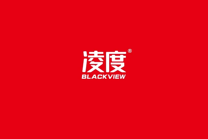

I am using the 1138 and my start-up/shutdown images were changed to LINGDU*.jpg
mine is 1138 (metric)
Did you tried to replace the images? With success? Where did you get your firmware, because mine is from the Shenzen DOME (these well known google docs links), and after update to the 1138 my startup/shutdown screens changed to the LINGDU ones.
The images in the folder rtosfs, (LINGDU_ON and LINGDU_OFF) are not the start/shutdown images.
THEY ARE ...my mistake

If you say that the LINGDU screens aren't those which the camera uses, then the guide is wrong. There's no other suspicious files for start-up/shutdown screens other than these LINGDU ones.
Do you use the 1138 FW? Did you tried to change the screens?
There are my start-up and shutdown screens after 1138 FW update:
