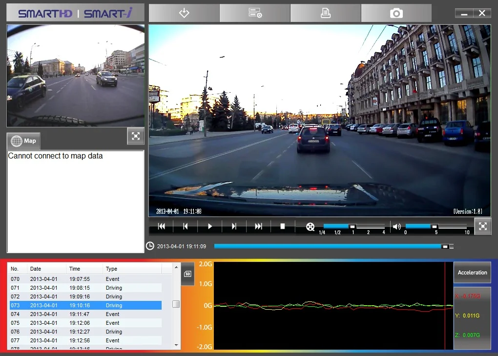

Software:
The english version of Smart-i PC Viewer is included on the provided SD Card. After installing, when you will start the program you will see some Google warning about some API key. I don't have the GPS module so I don't care about Google Maps. After closing the Google message you need to press the SD Card icon and to wait about 5 minutes until the PC Viewer will find your SD Card connected to the PC. I think all korean PC Viewers have this stupid idea to automatic search for SD Card. Why not offering a user manual option to browse for the SD Card location?

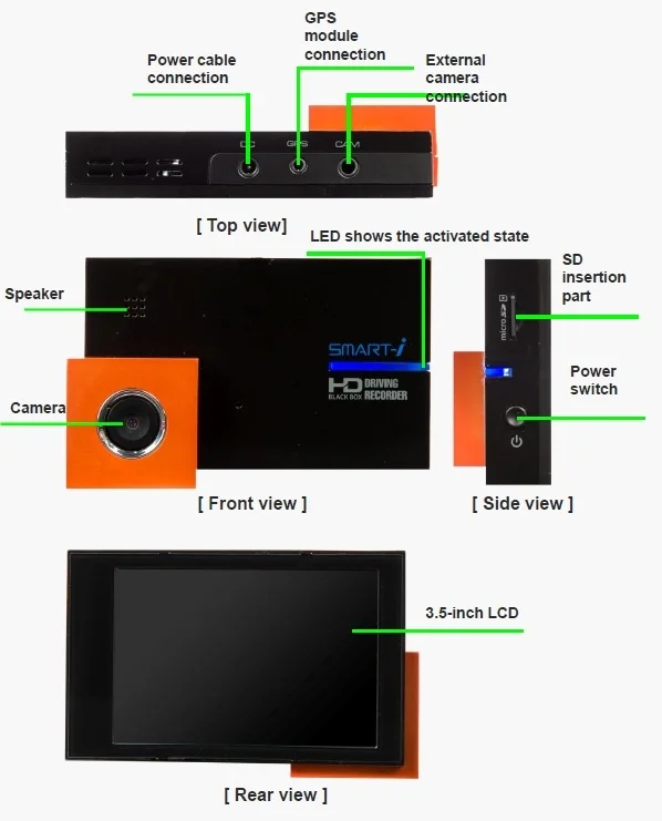

- power button
- micro SD Card easy to remove
- cable connectors are on top an this is OK and the cables are 90 degrees angled which is also OK
- good air vent holes

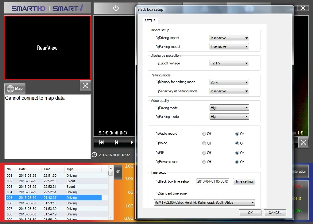

- power battery discharge protection offered in the firmware settings

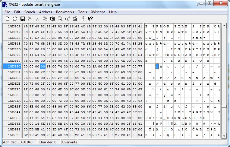

- PC viewer not updated after their Google API key expired.

Software:

- power button
