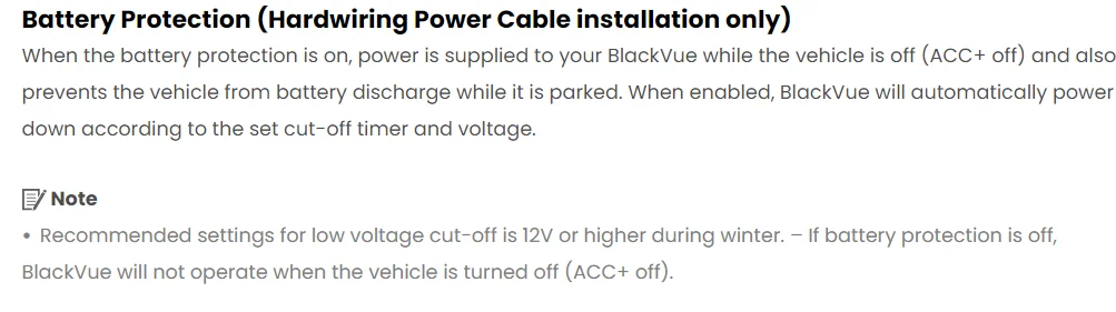

But my new camera keeps turning off, as soon as I turn off the ignition. The battery protection in the BlackVue app is set to off, so I can’t really understand my issues?

The battery protection ( OFF ) you mention, i assume that is the low voltage cut off in those cameras, could you try and select some voltage instead of OFF and see what happen then.
Seem like Blackvue are getting a lot of flack lately due to changes in the APP.
The same thing happens :/ That’s why I decided to turn it off in the settings

Since you say, the behaviour is similar in the other car, can you go through the settings section once again and also the wiring that you have done for the hardwiring kit.
