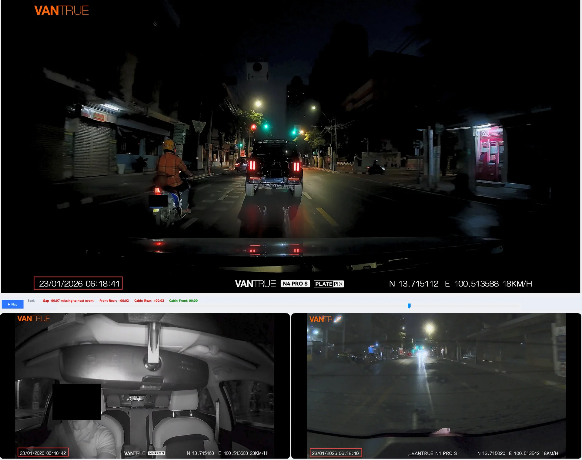

I've had this issue for a while now, but didn't notice it until recently when I was looking through the clips and started noticing there were big chunks of clips that were missing. It looks to me like most of the time the front and cabin cams are synced but there are times when they start to be out of sync.
Surprisingly, the front and cabin cam also appeared to be out of sync, although this is much less frequent and the out of sync isn't so large.
A few things can happen once the out of sync starts:
1) The system manage to bring things back into sync and the cameras continue to work as though nothing happens.
2) The system fails to bring the cameras back in sync and loses a few seconds of all footage on all cams for "some time". This duration can be from 2-3 seconds to over a minute.
3) The system fails to bring the cameras back in sync and the rear camera stops recording altogether. Sometimes, it come back on line while others, it just stays off until the engine is off & the cameras are also turned off.
