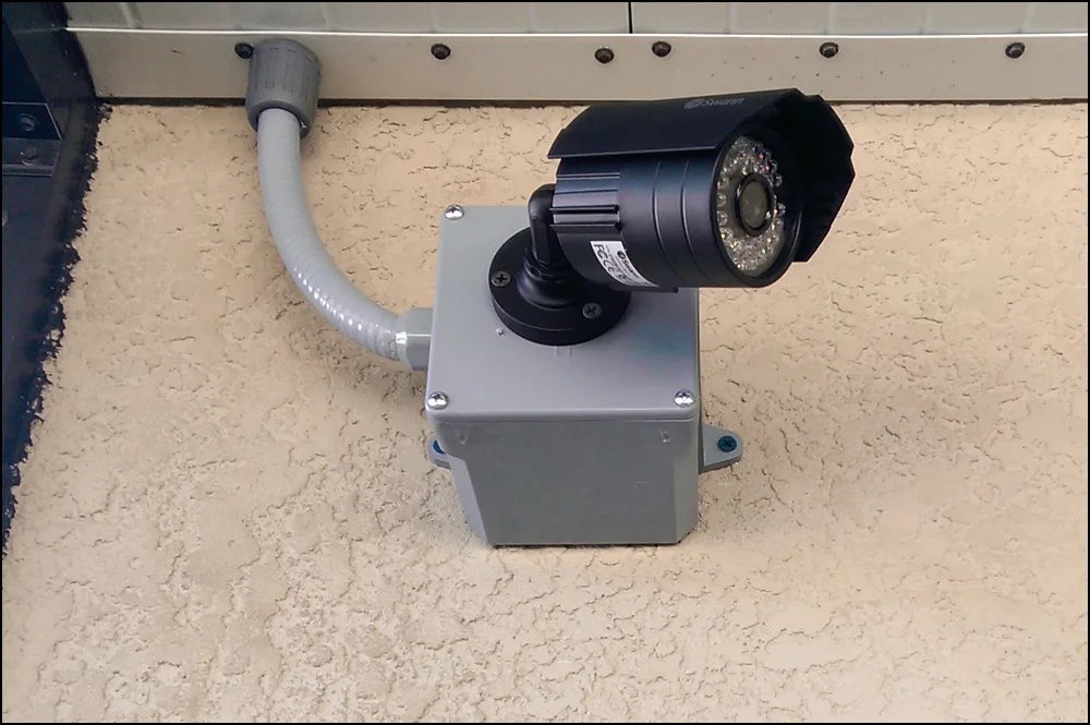

As for concerns about a network cable sticking out through your wall, this is usually addressed by installing your wiring inside some form of conduit. The conduit also protects from the elements.

BTW Tony, speaking of using conduit to run CCTV wiring, I failed to mention one of the primary reasons it is used on surveillance systems. Not only does it prevent anyone from having hardwired access to your network from outside the house and protect the wiring from the elements, but it also precludes the possibility that some crook can come along and easily cut your CCTV cabling before they rob your dwelling.

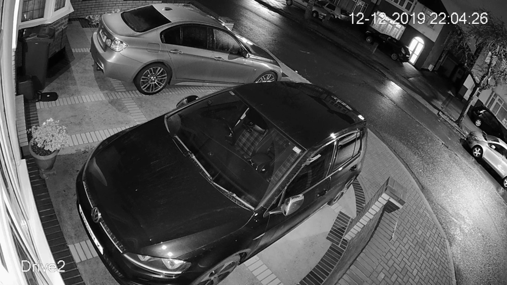

Old thread I know but I installed CCTV around my house around 6 months ago and went with Blue Iris for the surveillance software running on a Windows 10 desktop and currently have 6 Duhua 2Mp Starlight cams. I too have a NAS but I wanted the NVR and all cabling in the loft. Also on some NAS each cam is licensed separately so the costs soon add up.
I’ve been more than happy with Blue Iris, I only run it in a simple/basic config but there is loads that it can do should the need arise. For example I have cloned 3 of my cams and have applied different motion detection rules to the clones and the real cams.
The Starlight cams also have really good low light performance which is something I was specifically after. When I purchased my cams there was only the 2Mp cams but since the last few months 4Mp versions have been released so I’m planning on replacing the 2 front cams with the 4Mp versions at some stage.
