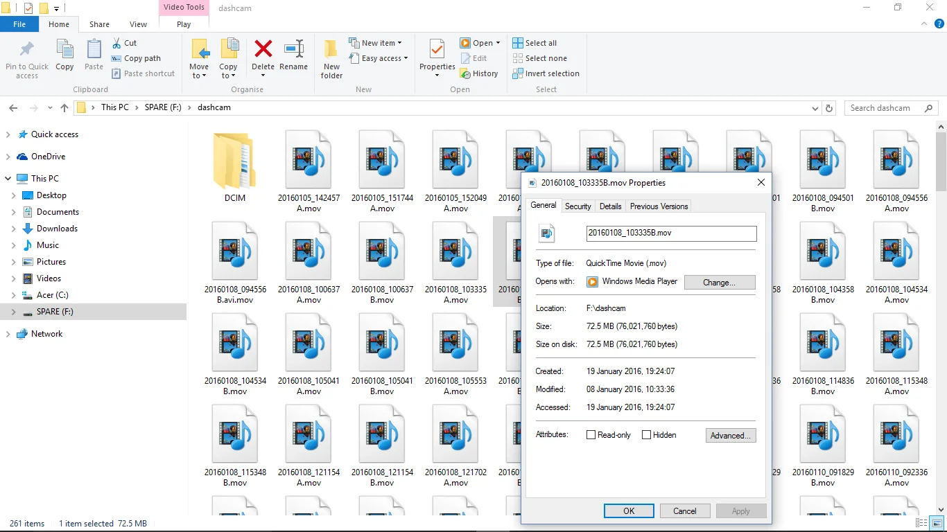

How's the file identified in Windows Explorer? Quick Time file, VLC media file or other type of file?

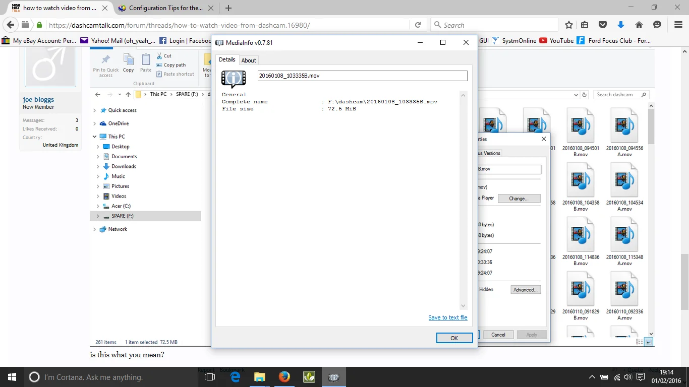

Can you post a screen shot of the file properties or the MediaInfo details, if you have K-Lite's codec pack installed?
is this what you mean?
i have installed k-lite
no its does not show any details at all on the details tab

The file you show is a B file, so it's probably from the rear camera. Have you checked an A file's info? If all the files are like that, they're all corrupted. As you can see, there's no video or audio info, that's why the media players are unable to play them.

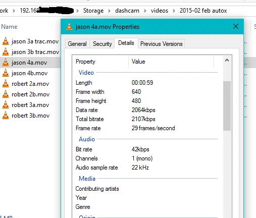

my B files from the rear cam also show info there. they are 720x480 @25fps, no matter what you have the front camera set to.
