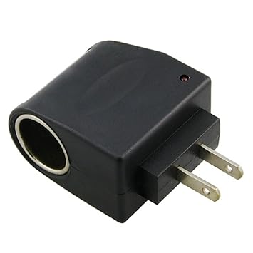

As far as I know, the camera was still connected to the power. I haven't been able to test my camera at home yet. Anyone know what kind of battery I would need to test it?

If your original cable not broken, Use cigarette adapter plug to outlet. It should work fine for testing.
