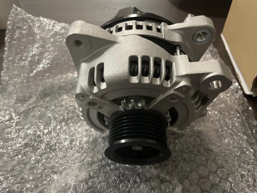

The new alternator arrived today. I think I’ll try to install it tomorrow. The pulley measured the same size as the existing one, so nothing to worry about there. Hopefully, everything goes smooth.
You'll find out soon enough but I would also check the plug is the same.
Yeah check plug too before you pull old one, if thats good too, then it is only the offset of the pulley that might be wrong,,,,, i have no ides never tried to swap something like this out, but i assume belt placement can vary in between car brand / models.
Yeah, it has the same plugs.

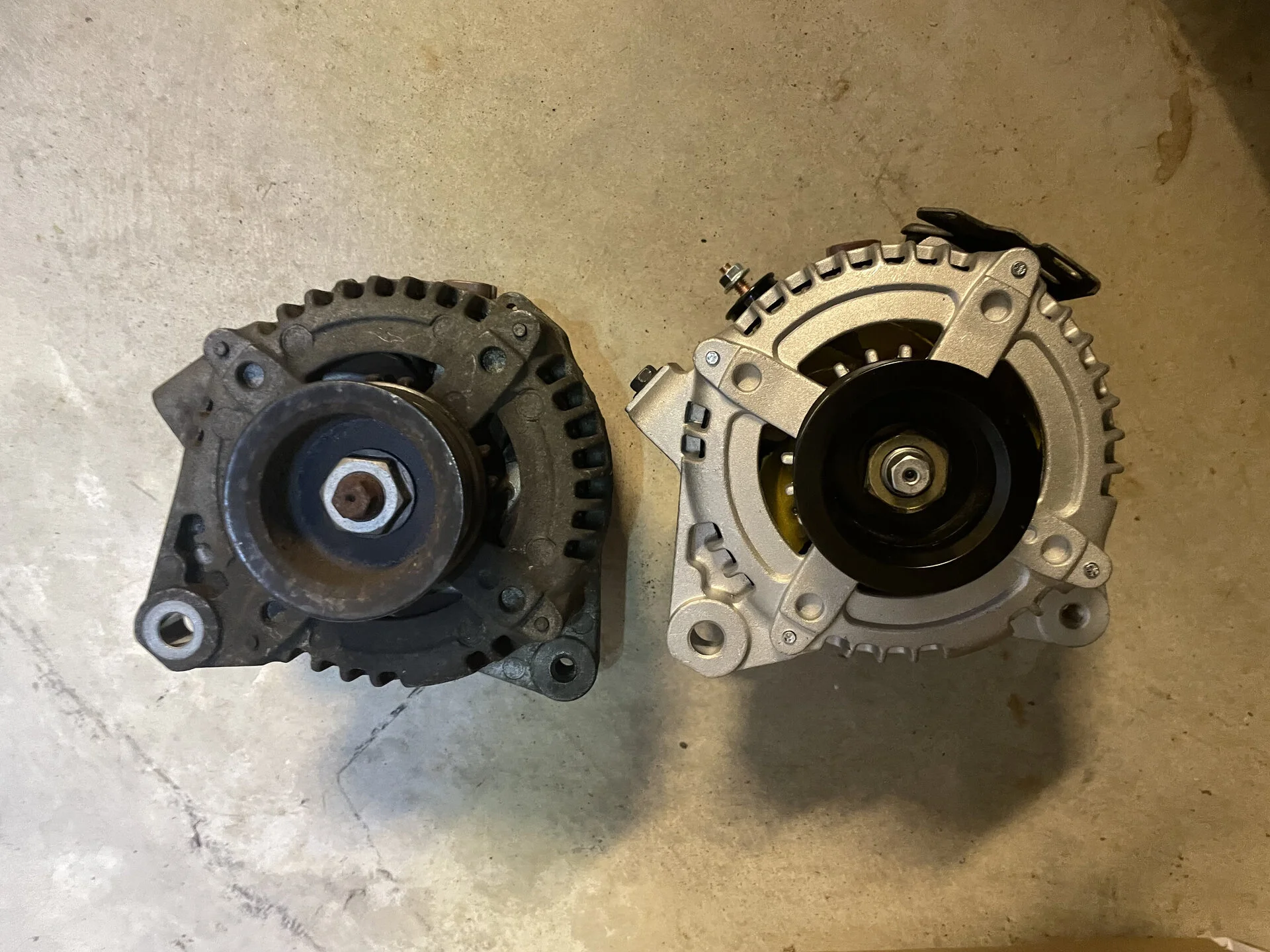

The pulley for the new alternator was slightly different than the pulley from the old alternator. The very outside of it seemed to have a wider diameter, but when I looked closer the inside grooves seemed to be the same diameter. I figured the inside grooves were what mattered since that's where the belt sits. On the old alternator the outside of it is kind of angled and flares out while the new one is mostly flat.

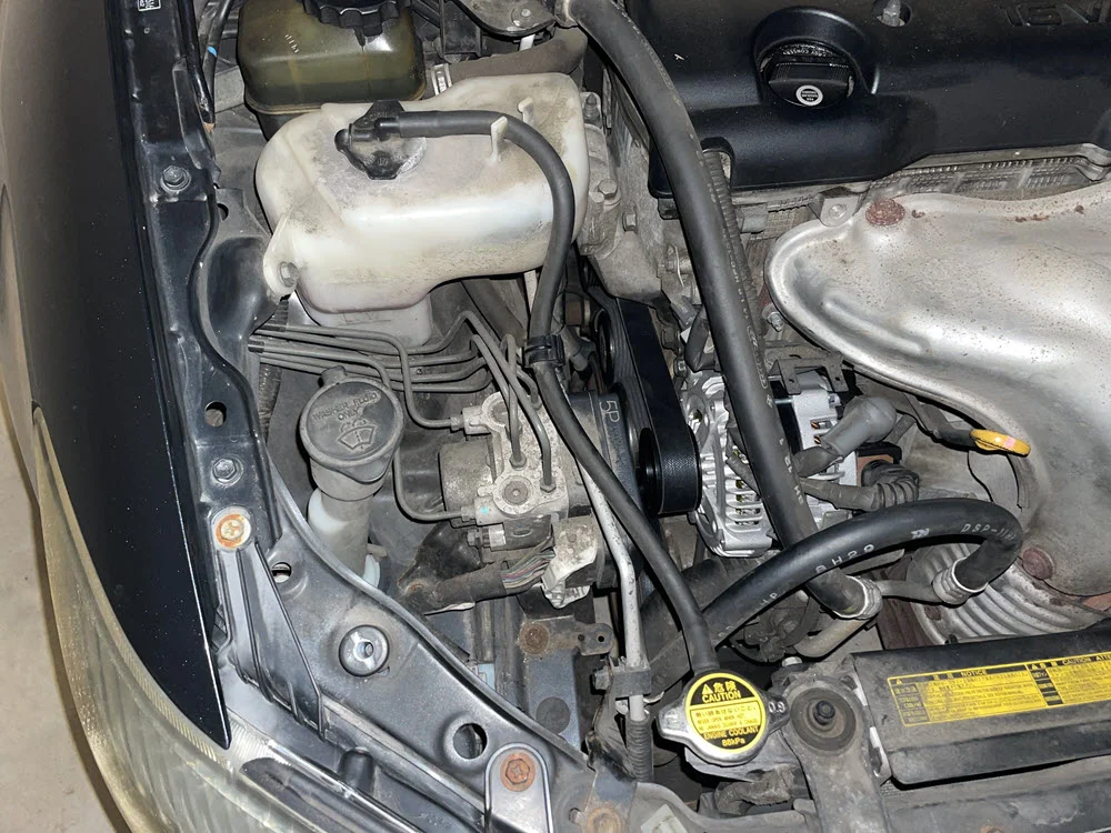

Here's a pic of it installed with a new belt:
