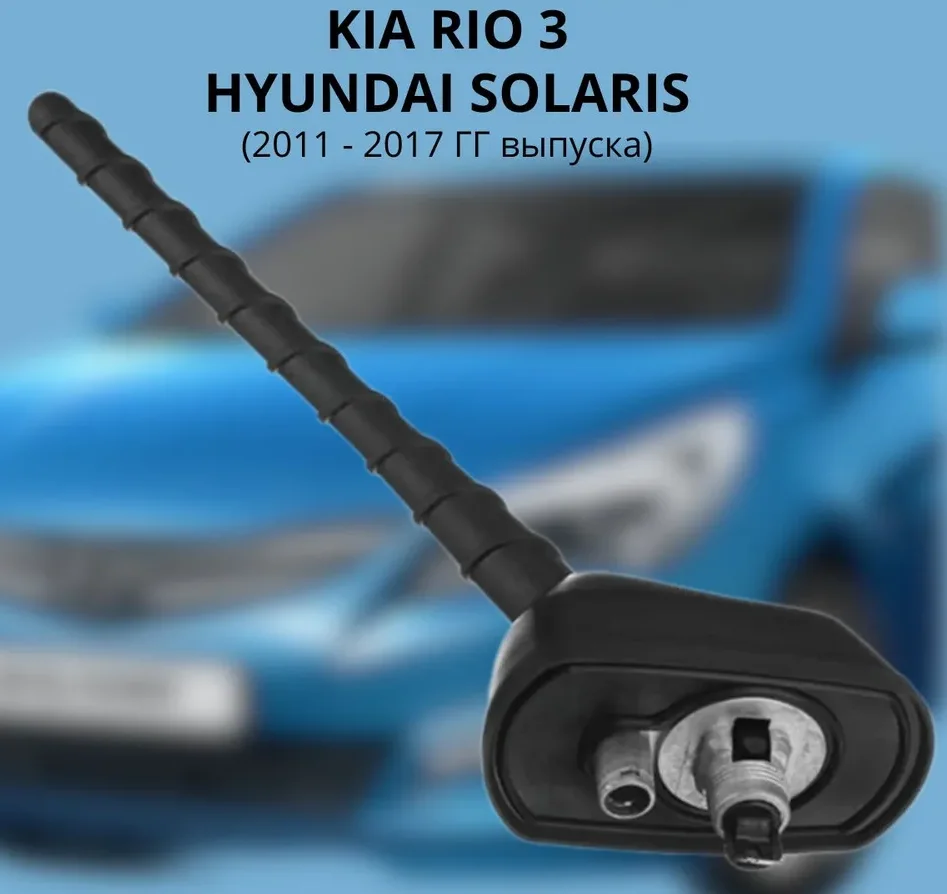

I have a this type of antenna
So I think I can made a hole and going into a cabin.
If you want to use a gap between rear window and car trunk I worried about how to fix long cable on edge of rear window. I did not know another gaps between rear window and car body. Made a additional holes in rear window sealing rubber is not a good idea I suppose.

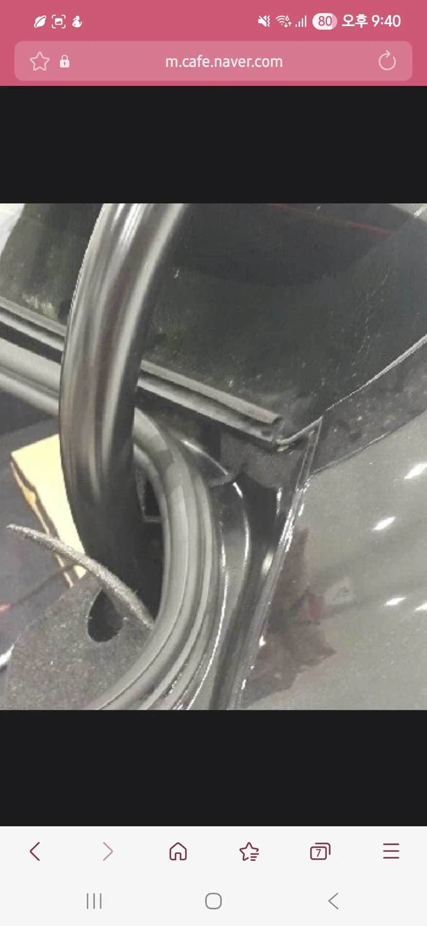

I'm planning to use the gap next to the glass to route the cable to the trunk. The problem is that while thin cables can fit through the gap, the thick connector section doesn't.
The Vantrue S1 Pro Max cable is much thicker and stiffer, and pulling it inside the car seems much more problematic to me.

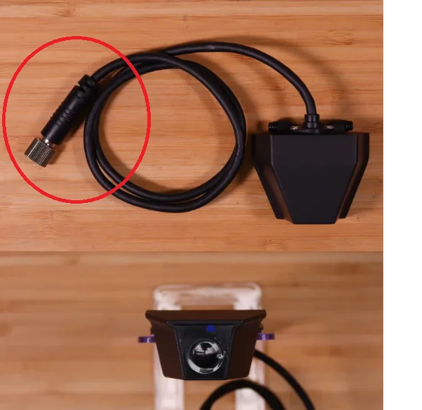

The RWC_400 has a built-in cable that is 50cm long. Is that not enough for you?
I plan to run the cable through the gap next to the glass. I can't fit the connector part. The cable from the waterproof camera needs to be at least 2.5 meters long to be able to run it through the gap next to the glass and into the trunk.
