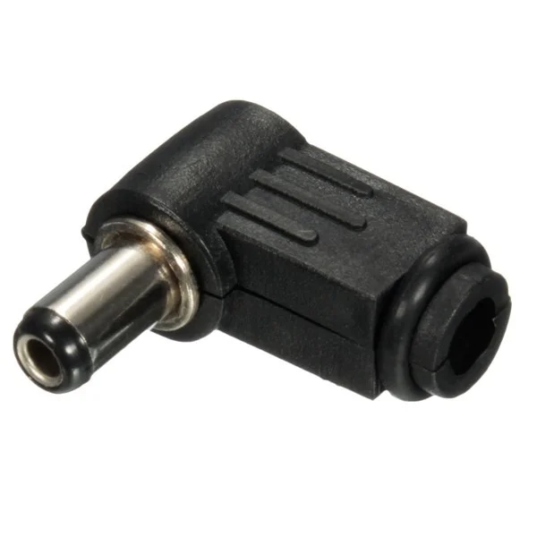

The TQKA power bank won't work for you since it only provides 5V output via USB-A female. There are numerous power banks that output 12V however, You'll find many listed on Amazon....HERE.
Most of these output via a 5.5mm power plug like in this photo. So what you'll need is a good shielded cable that can connect from a 5.5mm male plug to whatever your Blackvue requires.
