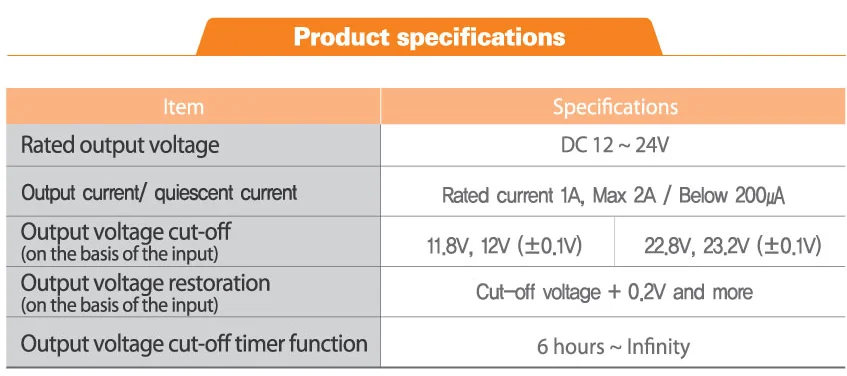

The Power Magic pro is rated capable to support 1 amp steady, with 2 amp for brief surge.
Your camera manual states: Current Consumption Approx. 4.8W, Varies depending on Wi-Fi usage.
If we assume the 4.8 watts rating is at 12 volts, then the amperage per camera is about 0.4 amps. Two camera draw about 0.8 amps.
The single power magic pro rating implies it could power both cameras, with a little margin to spare.
Note: Quiescent current is the current drawn by a circuit when it is not amplifying a signal or driving a load. This indicates the power consumed by the device for it to operate at idle, depending on design. This is approaching 50% as much power as the camera is using.
If someone has experience trying this, that would be more valuable that the calculation based on specs. The spec is sometimes optimistic.
