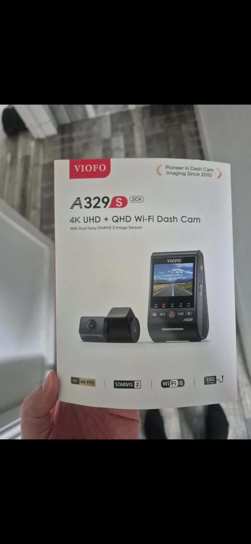

Also before I update the firmware, can others please confirm exactly which firmware files I should install for both my front/main camera and rear camera?
My box says A329S 2CH. Previously, VIOFO support checked my firmware and told me that my camera was A329WW and instructed me to use A329WW firmware.
However, the VIOFO app is now detecting a new firmware update as A329S_V2.2_260815 (89.34MB).
My currently installed firmware shown in the app is V2.1_260702.
Please confirm:
  1. Is my main/front camera currently configured as A329S or A329WW?
  2. Should I install FWA329S.bin V2.2_260815 or FWA329WW.bin V2.2_260815?
  3. Do I need a separate firmware file for my rear camera? If yes, please give me the exact filename/version.
  4. Do I need any LD98530A/B conversion file, or should I NOT use one?
  5. Is it safe for me to accept the A329S V2.2_260815 update currently being offered by the VIOFO app, despite previously being told my camera was A329WW?
I don't want to install anything until others can confirm the correct files for my exact camera configuration.
And also how exactly I do this via the computer and the exact link to the correct firmwear.
There is no firmware in A329S REAR CAMERA, (only front / main unit).
This is simply not true.
We figured this out last time we updated your firmware.
You have A329S 2CH REAR.
For some reason there was a mix up, and your camera was shipped with WW firmware.

FWA329S.bin V2.2_260815 is correct.
But, it looks like VIOFO website firmware page, and APP OTA firmware updates are currently down.
So, the easiest way to update is SD Card method.
Disregard, you don’t need this.

There is no firmware file for rear camera, and the load file is for converting for example A329S to A329T.
You can download the firmware for A329S front camera from this link to the root of your card for updating: https://we.tl/t-aZSRFpZxs291Rico
