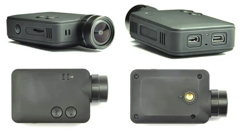

The first 2 JooVuu MODs are online now, will wait for your test footage and make more adjustments to tables. Looks like an interesting DVR, is the mounting bracket stable and durable enough for frequent quick attach / detachments?
Any over heating issues when 660 mAh battery is used on hot summer day?
The mount is a screw in fitting which is exactly the same as the mobius. Not sure about durability as I rarely take the camera out but it feels on par with the Mobius 1.
I have the capacitor version and even with this if the camera is in direct sunlight on a hot summers day 25c in the UK......the footage looks like the sharpness 2 clip that I sent you i.e. very soft and blurry. Once the camera cools down picture reverts to normal.
Haven't found any photos showing JVX internal view or Lens/sensor module out of camera. My guess they are attached to main circuit board. The reason I asked about hot weather over heating is there isn't much venting on that DVR which is a mistake in all designs. What you describe is common when Lens is threaded in plastic base which expands enough in microns causing Focus drift under high heat. It would be interesting to see the Lens housing base and mounting system.

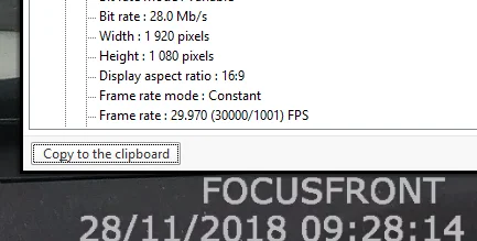

Right results for firmware_JVX_MOD-28CB_28Mbps+SharpB+DCTeam
Apologies for the poor weather....going to be like this for the next couple of days in the UK and apologies that I accidentally did 3 minute clips on 2 of the videos. WDR turned off on all of them
One thing I have noticed is that all the FWs including the stock ones are recording at 29fps not 29.97 or 30.00 as most of my other cameras do.....will that have an effect on the picture?

Looks like 29.97fps to me

Thanks for the JVX 28CB Beta footage, was important for me to get these to confirm Bitrate works and MP4 tag embeds. The 29.9fps has zero effect on IQ quality and normal for different cameras. Since I don't own this X suggest you record in highest resolution whatever that is, want to avoid using interpolated resolutions that wreck IQ. The Sharp4 looks good possibly improved. Really need bright blue sky and some parking lot video. Also need to see extreme Sharp levels so Sharp1 & Sharp5, even parking in front of house pointing at building across street will help and easier to record all 5 sharpness levels. I have 4TB of storage for DCTeam Test footage so 3min clips mean nothing but for others 1-2min clip Looping is best.
What you've shared helps enough to advance the adjustments, great work. Should have another sharpness MOD later today.
