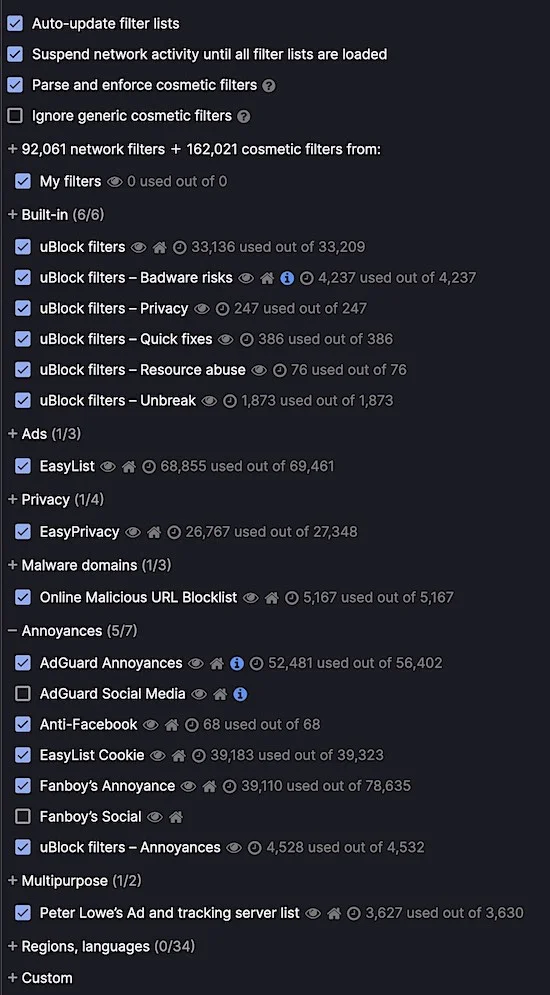

uBlock Origin is an excellent tool for enhancing online privacy, increasing security and thwarting targeted advertising.
Among its various features and capabilities, it uses a wide array of user selectable filter lists from many sources to block behavioral marketing firms, malware and advertising. Of the three items you listed, uBlock is probably the primary tool that is protecting you from seeing any targeted advertisements.
Another good way to way to preserve your privacy is to use a privacy oriented search engine rather than Google. DuckDuckGo and Startpage are good but there are other interesting search engines worth exploring as well.
uBlock Origin filter lists:

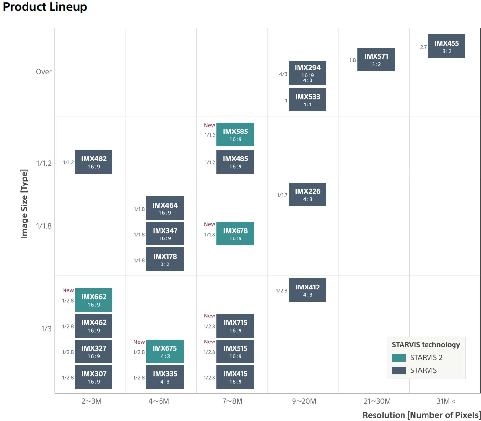

What dashcams on the market use the Starvis 2 sensors?
I don't think any are yet, not sure that Sony are even in mass production yet, of the dashcam suitable sensors anyway. They are on their way though.
I'm expecting a 2K Dashcam with Starvis 2 sensor using IMX675 to be released first before a 4K one.
I don't even see any 4K Starvis 2 sensor that is 1/2.8 listed...Sure, there is 1/1.8 and 1/1.2 but those will be much more expensive.
Sony did a paper launch of IMX675 last month with expected sample ship date August 2022. I'm sure that we will see one about 2 years from now sometime in 2024 once all the engineering and testing from Viofo and others have come into place.
If you read the link below, you will also see that Sony is comparing IMX675 to IMX335, meaning this is essentially it's replacement or Starvis 2 equivalent.
