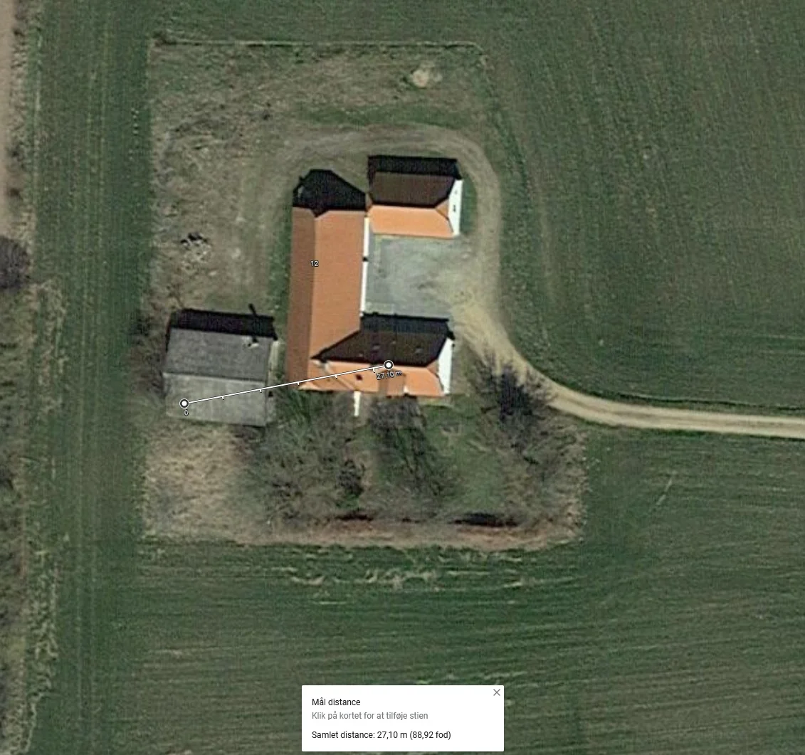

How many feet/meters?
Not sure 20 - 30 M i think.

The barn is close enough to the building to just run Cat5 cable. A basic IP camera and an NVR and they'd be all set! They don't need Wifi.

Yeah i know the distance are not super big, but as i have almost 0 experience with wifi i do not know its reach
Sitting in my parked car in the back yard i can actually see my wifi router which is on the other side of the building facing the road, but i suppose it also have a stronger signal than a little camera.
If the camera had a antenna you could screw off, and put on the end of a wire, and so have it even closer to the building i assume that would be enough, at least if doing something like that is OK with a camera, but i would assume so.
I suppose i could put my phone in the barn in hotspot mode, and then try to see if i could connect to it with my laptop from the house.

Phones don't have the greatest antennas either, so the phone is a reasonable test.
My wifi reaches 40 meters to my phone, although with only one wall in the way,
You may be able to move your wifi router to a better location, more central to the house+barn, or maybe just raise it up a bit to get significant extra range.
Easiest solution may be to add a wifi-extender. I don't know what is allowed in your country, but here our internet providers sell "official" wifi extenders (at excessive prices) that can be positioned around the house to cover blind spots and just need pairing to the official router, that should be enough to cover the barn.
