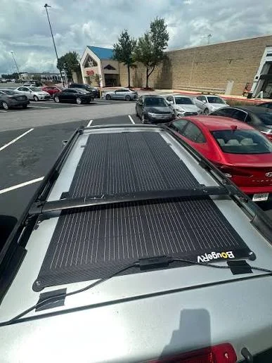

@Maximum
What kind of car do you have?
Can you put a solar panel on the roof?
A solar panel will give you “unlimited” parking mode operation.
@Chuck McCoy
It’s a Citroën hatchback, so I don’t have roof rails like in your examples.
I’m not against the solar idea, but I wouldn’t want to drill into the roof or use a mounting method that could scratch or damage the paint. My other concern is how to route the cable into the car without compromising the factory seals.
If there’s a clean, fully reversible way to mount and wire a solar panel on a hatchback without damaging the car, I’d definitely consider it.
I've seen paper thin magnetic solar panels.
No drilling required.
You can find the right location to "squeeze" the power wire in-between the rear hatch.
