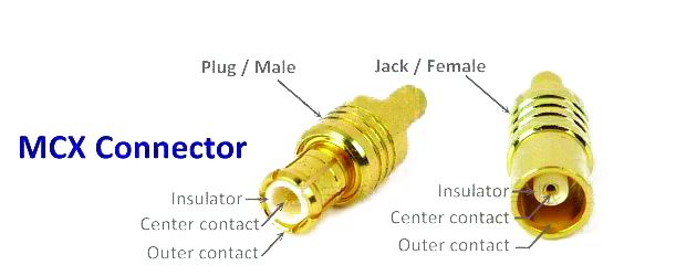

Not sure what the cable is, although the diameter (and so the minimun bend radius) are similar to RG-174. The real issue is likely the connectors which are a sort I've never encountered before. If those are proprietary in nature we will have to rely entirely on Viofo for our cables, but such as that almost never happens as there's a large array of connectors already made for use with various coax, and using those in production is always much cheaper and more profitable for the manufacturer of the device.

A quick search makes me think they may be an MMCX plug, looks similar in pictures but I haven't measured. MMCX Datasheet

yeah I haven't seen it, I'm sure it would be an off the shelf connector though, not something you're going to see in your local electronics store or whatever as it's very specific use case

There do seem to be extension cables fairly widely available, seem to be used for some radio control stuff.
(I'm not 100% sure that is what it is.)

Definitely not MCX. I don'r have the dimensions to check, but it does look more like MMCX based on what I've seen at this point. My reference book on connectors is in storage somewhere, haven't used or seen it in ages. My digital caliper is there too so I wouldn't be able to confirm anything at this point.
