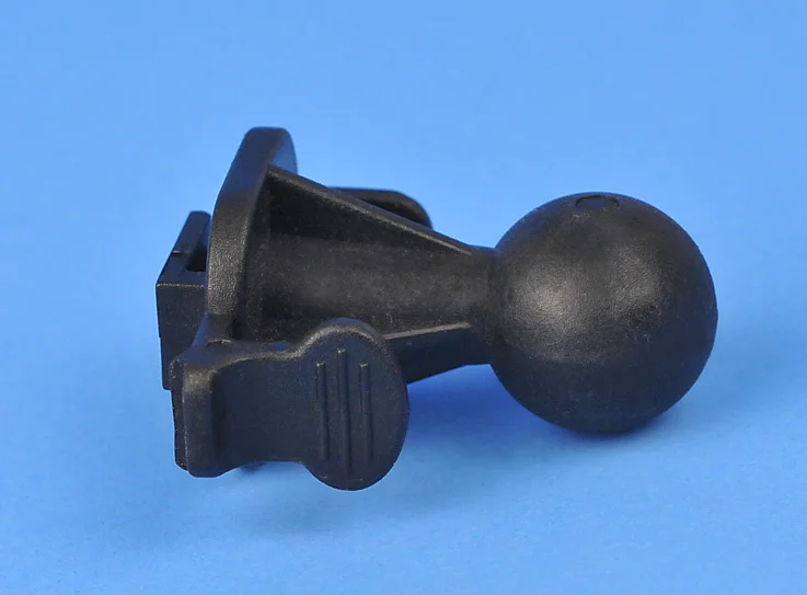

So, my original idea as suggested in the Pre-order thread was to simply cut down and modify a standard widely available adhesive tripod mount like the one on the left below that many of us are familiar with and that's exactly what I did with two of them. For the sake of designation I call the first one "the Mini".

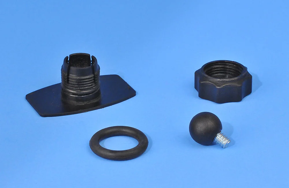

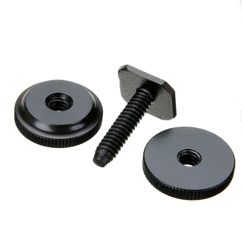

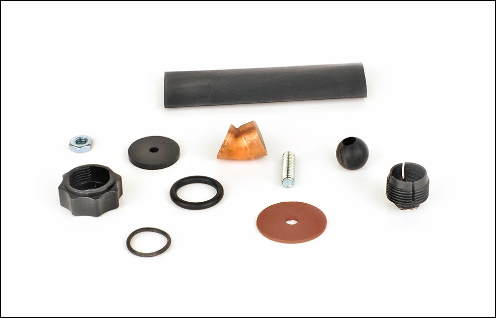

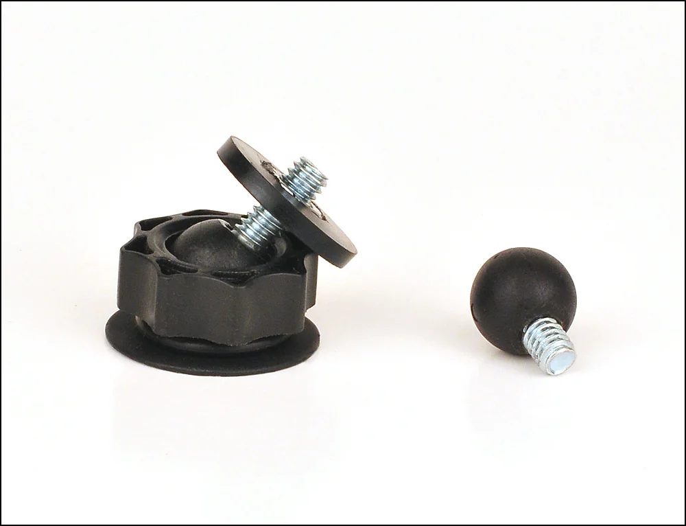

Here are the basic components. As you'll see, some of these parts eventually got swapped around with the other mounts I've made. I added a locking platform I made from a hard rubber bin washer which I drilled to accommodate a glued-in thin 1/4-20 hex nut as seen above. The idea was to make a secure locking platform that is thinner than the ones that came with the mounts I started with. The basic idea with this mount was to eliminate the raised center column of the original to lower the height of the tripod mount.
One important thing to mention is that all of the mounts I have to shown here required modifying the original ball that inserts into the socket to create a lower profile or taller profile threaded mounting stalk, depending on the requirements.

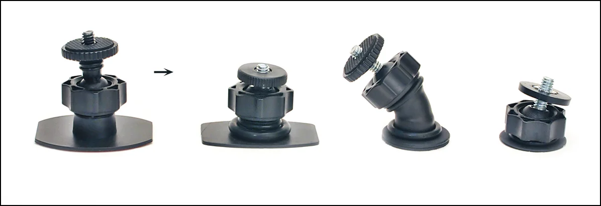

I sawed the ball off this old unused mount and drilled it out to accept a 1/4-20 threaded shaft.

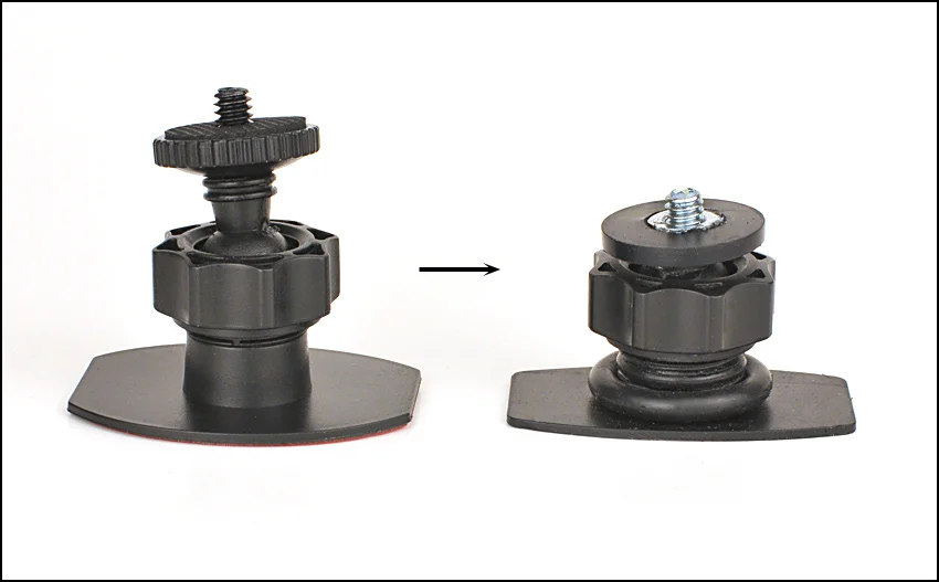

The first mount came out rather well but after it was complete I concluded it was still too tall for how I intend to use it ("ceiling mounted" side facing camera) so I decided to see just how low a profile mount I could get away with building and still have it functional for my needs. It seems that if you cut off the bottom third of the socket ball it will still fit and function just fine. This discovery made me realize I could achieve a MUCH lower profile design. Meanwhile, I realized the first "too tall" mount I made will be a perfect low profile replacement for my current rear facing Mobius camera mount.

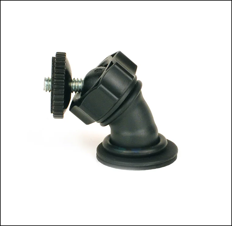

This iteration resulted in what I refer to as the "Nano" seen below.
I was mindful of a point brought up by @jokiin in the above mentioned JooVuu-X Pre-order discussion, that, "the challenge I've seen from the shorter ones is they don't have enough adjustment to compensate for the windscreen angle and end up pointing too far down". However, I discovered in the process of doing this project that you can achieve all the angle of tilt you will probably need as long as you provide a long enough threaded stalk. If you need less tilt and still want the lowest profile mount, just swap in a ball with a shorter 14/-20 threaded stalk. With the "Nano" low profile mount I can achieve a maximum tilt of 45 degrees if desired using the long stalk.

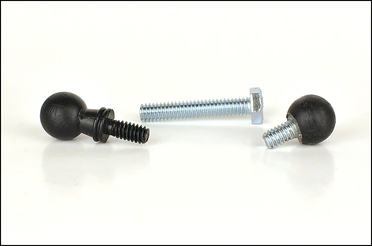

I used the balls from several of these mounts I bought on eBay from a small but excellent supplier in China (3 for less than 5 bucks!) and I cannibalized some older ball and joint mounts from now defunct cameras by installing my own 1/4-20 threaded columns.
Here are the basic parts that went into this one. The base is worthy of some discussion. I drilled countersunk holes in a steel fender washer and then used small torx screws and epoxy glue to put the whole thing together, so it is very strong. The idea behind using a steel washer for the base makes the whole mount attachable with neodymium magnets if so desired, or 3M VHB tape, or Dual-Lock tape. With magnets it has a very strong hold and is one of the basic design features on the two mounts here with a round metal base.

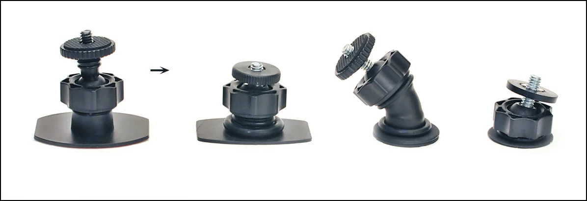

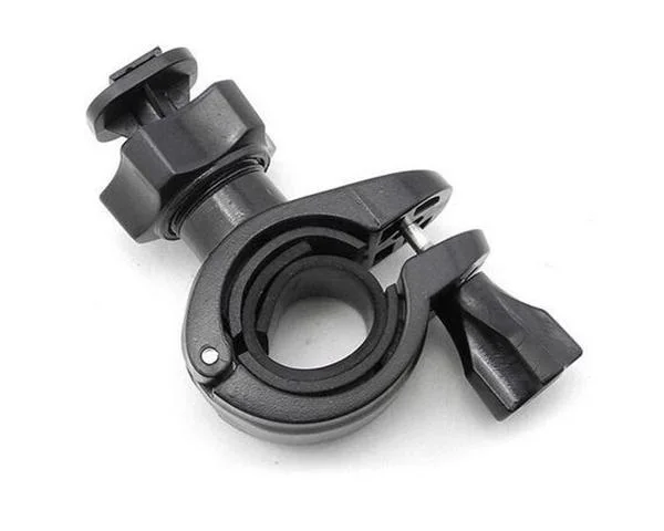

For obvious reasons this third one is called the “90” as it can mount a camera on a 90 degree angle. This means that with the right camera you could use this mount effectively on a vertical windscreen or side window.
A lot more parts went into this one. Here are some, but not all of them as the project evolved as I worked on it. The brick red disk is one of the steel washers I used that has been painted with metal primer before it got a coat of black Rust-O-Leum camouflage paint.
As with the other mounts I used rubber O rings partly as a cosmetic embellishment but also to cover the seams between the parts.

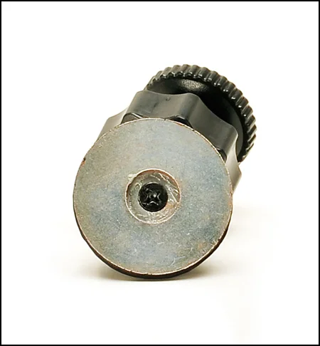

Also as before, this mount has a steel bottom, so it can be mounted magnetically. I used two washers so that I could recess the screw. The screw is epoxy glued into the center column and the second washer is epoxy glued to the first. The idea was to make it very strong so that however it gets mounted, either with a neodymium magnet or with 3M VHB tape or even Dual-Lock Tape it will never come apart.

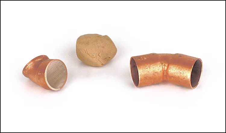

The center column is made from a copper plumbing elbow that I cut down to the desired height and angle. I filled the copper elbow with sandable and drillable epoxy putty which gave me something very strong to screw into, both for mounting the washers to the base of the column and for screwing the ball socket cup to the top. The use of an epoxy filled copper metal elbow gives the DIY mini mount a nice heft and feel in the hand.
At first I was just going to just paint the copper pipe black but I got the cool idea to sheath it with heat shrink rubber tubing and it came out really nice.
