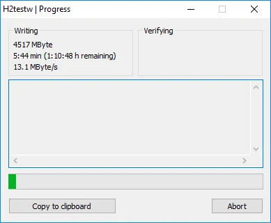

i tried SD Formatetter,after that i was test my sd card with h2testw. - everything is ok. One thing is that on writting on card speed is 5-6 mb\s . is it ok? i looked that UHS-1 class10 must be 10 mb/s. Read when veryfing was 25-26 mb/s. (sd was in cardreader in laptop)
I just make one more test in program " Check Flash 1.17.0" - write speed is 10,25 mb\s, read 85 mb/s
Then i putted in dashcam and formatted as you say. Now i'm testting for a few days. and will repost you about.thank you

that's a good sign, you shouldn't however be getting low speed messages from the camera, your h2testw results are slow also so even though you have a genuine card it could still be that you have a problem card

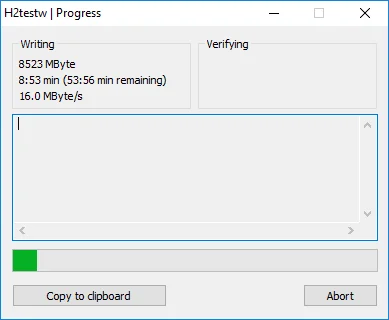

I just formated one more time with GuiFormat, and run h2testw, the write speed is 10. is it ok ?

oh, it grows up slowly, after above 5 minutes. incredible.....

16 - fiberoptic :)))
