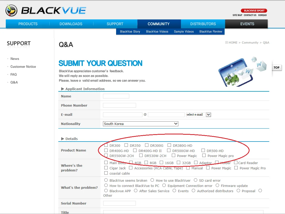

My bad. No 600 listed on the contact for for help I should have said lol.
