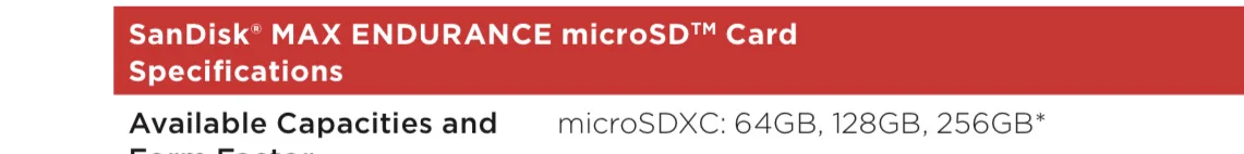

Best to go with Sandisk Max Endurance cards if available - that's the only card I don't have any issues along with Viofo and Vantrue own memory cards.
Ah I see... I was trying to see if there were any affordable alternate options, but I guess there's really no choice but to go with the Max Endurance.
