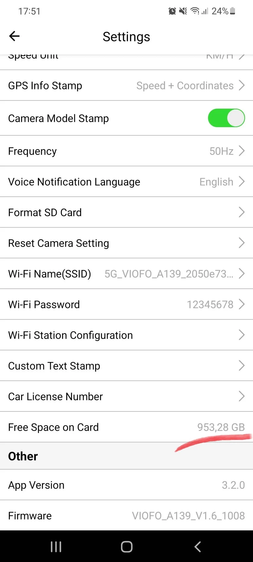

If Viofo app gives an error, you need to do a quick format using Windows and then Viofo app formats the memory card without giving an error.
Wow this worked, thank you. I will report back when the card is full.

I got the constant beeps today with my 1TB. Restart did not fix. I tried formatting on the app and it said format failed. I checked the card on a PC and it is fine.
