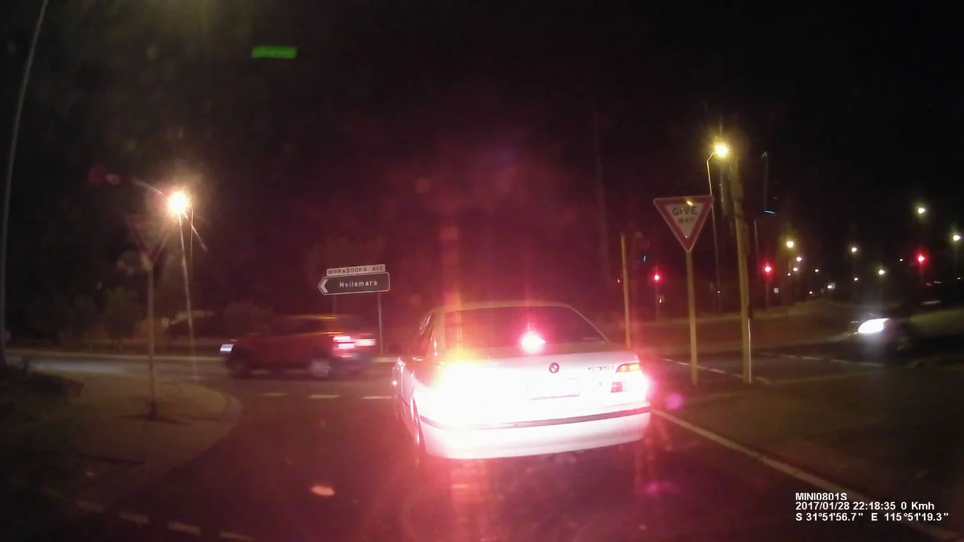

  • Night-time footage is bordering on unusable, reflections are severe (see sample footage on YouTube) with licence plates washed out completely no matter how I positioned the camera. Graininess of the image only compounded the issue.

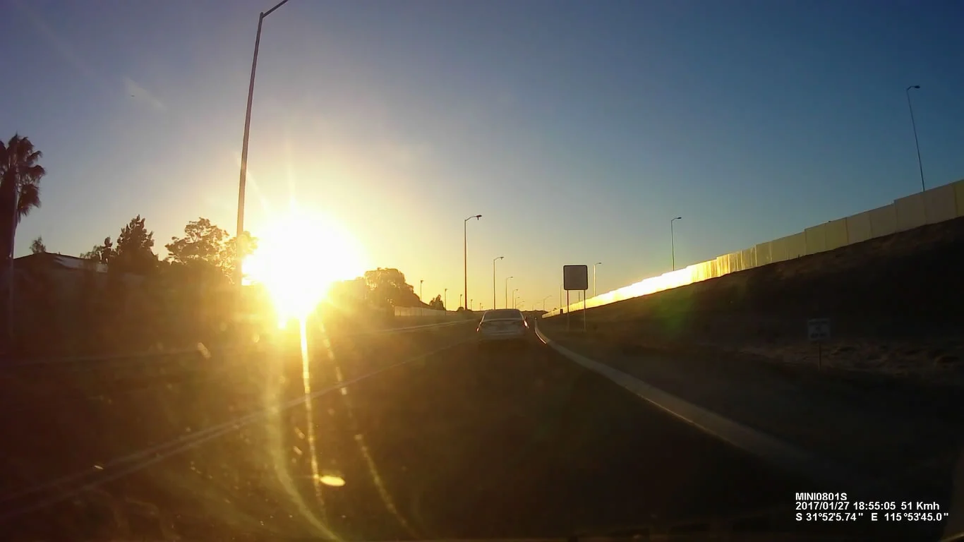

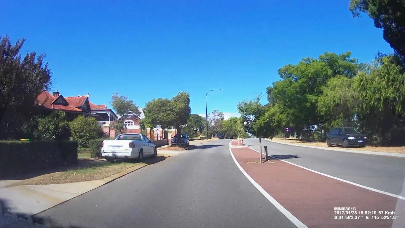

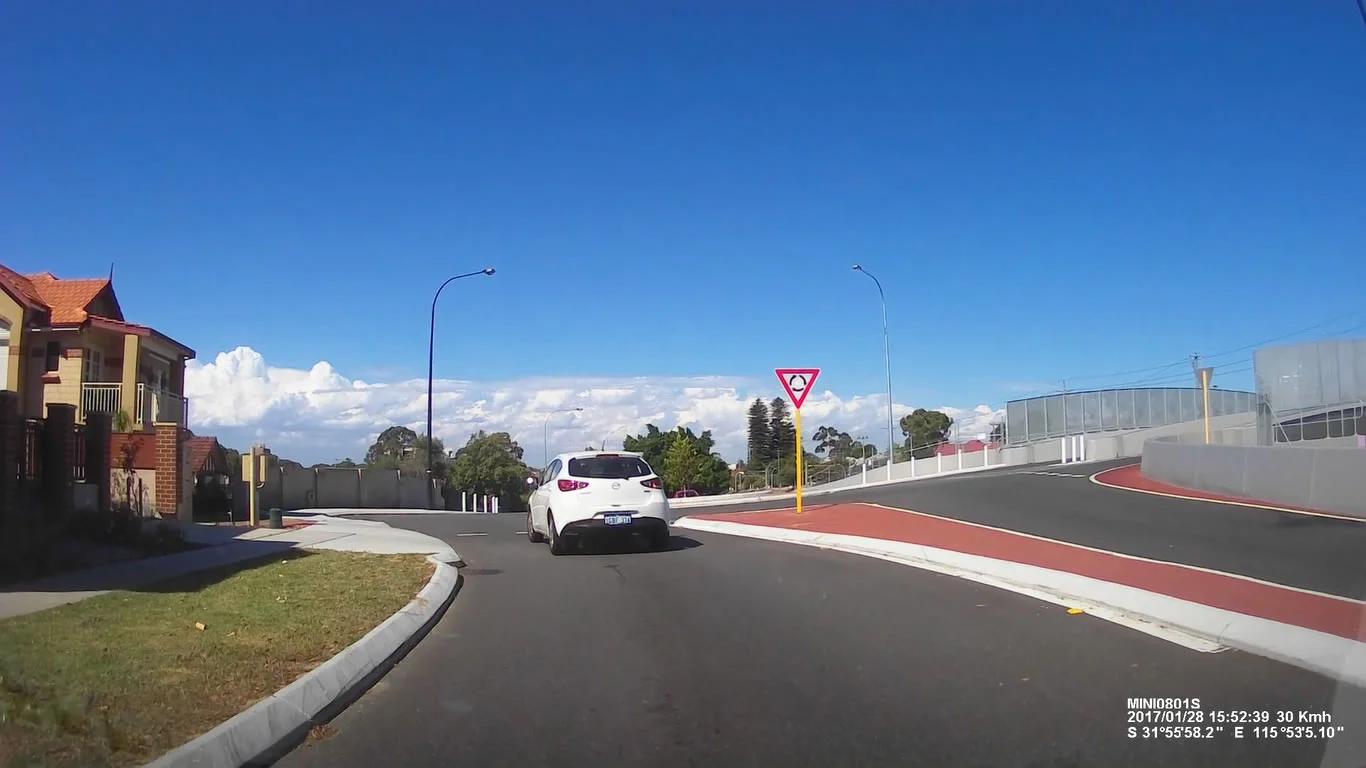

  • Daytime footage has a fair degree of saturation and oversharpening, but preserves a lot of detail and deals extremely well with exposure changes. The same applies with sunset footage, where the footage is a little on the dark side but details are held and not blown out.

Daytime footage, 1080, HDR turned off (UPDATED MARCH 2017 FIRMWARE):
Daytime footage, 1080p, WDR/HDR turned off:
Sunset footage, 1080p, WDR/HDR turned off:
Sunset footage, 1080p, WDR/HDR turned on:
Night-time footage, 1080p, HDR turned off (UPDATED MARCH 2017 FIRMWARE):
Night-time footage, 1080p, WDR/HDR turned off:
Night-time footage, 1080p, HDR turned on (UPDATED MARCH 2017 FIRMWARE):
Night-time footage, 1080p, WDR/HDR turned on:

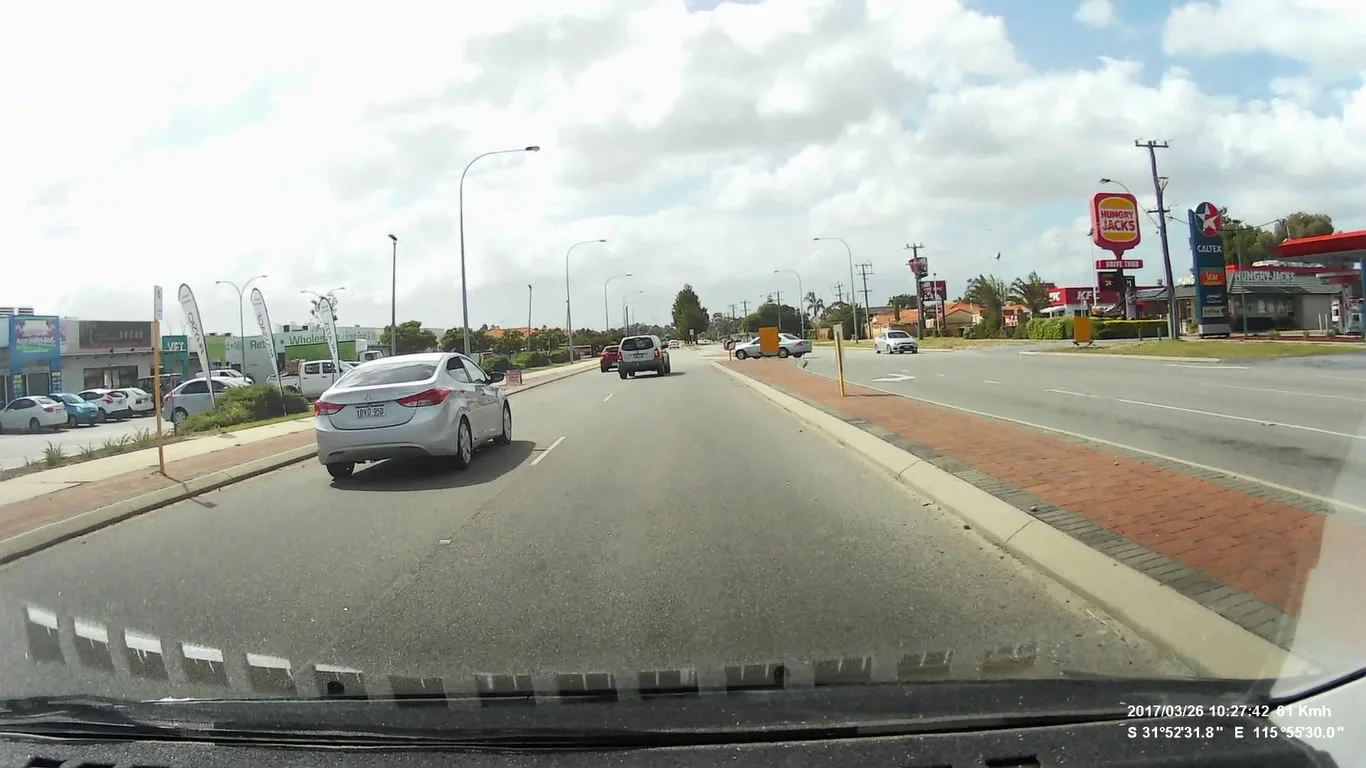

Some screengrabs (old December 2016 at bottom, Updated March 2017 firmware at the top):
