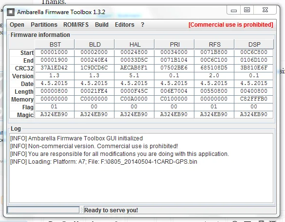

I have just purchased mini 0805 1 card + gps from amazon and the firmware on it is 20150504 V1.0. I have attached the screenshot from AFT and link to a folder with .bin and .zip if someone interested. Any idea if this is the latest firmware? Haven't tested it much yet so not sure how good it is.
