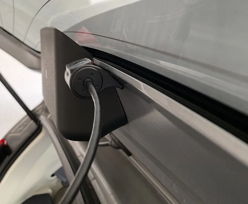

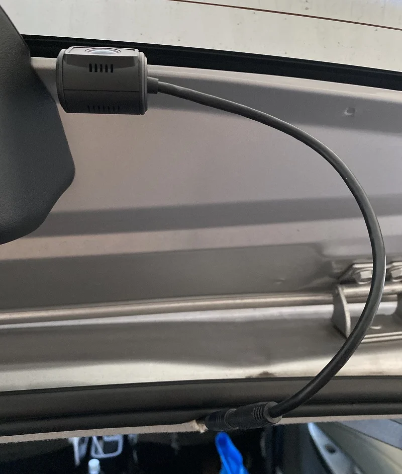

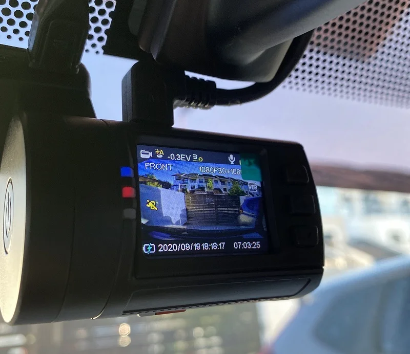

Okay, a friend got one and I helped him install it. It's certainly a bit thicker than expected, but it is narrower. Not the nearest to the glass, but well better than a brick on a stick right? Screen is surprisingly usable. UI is decently designed, but some of the items could be better explained.
The rear camera connector is a nuisance. It's not long enough, or short enough from the cable exit so it adds unnecessary stiffness where you don't want it. It would help if the cable exit was angled and rotated freely against the camera aim. This cable is also extra finicky. Pinch or turn it a bit too sharply, and you will be getting garbled image in your recordings. So give it plenty of slack anywhere you push it in.
Overall still very low profile. Driving time reliability is OK. Parking mode reliability seems poor. We ended up using motion detection recording instead of G sensor event recording (we intended to conserve battery wear). Conclusion is if you're low on budget and must have a 2-cam system, stick with the old mini 0906. Otherwise, perhaps two units of single cams would be more reliable at this price range.

An example of what happens when you pinch the rear cable. Not a pretty sight on a new dashcam you just spent 2 hours wiring up.

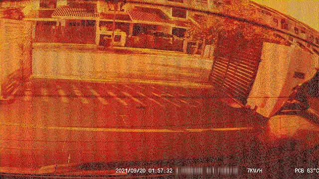

Mini 0906 Pro front camera night footage. Notice how high the PCB temperature reading is given this is at night and the car just started driving. The parking mode keeps the camera circuits pretty toasty!
