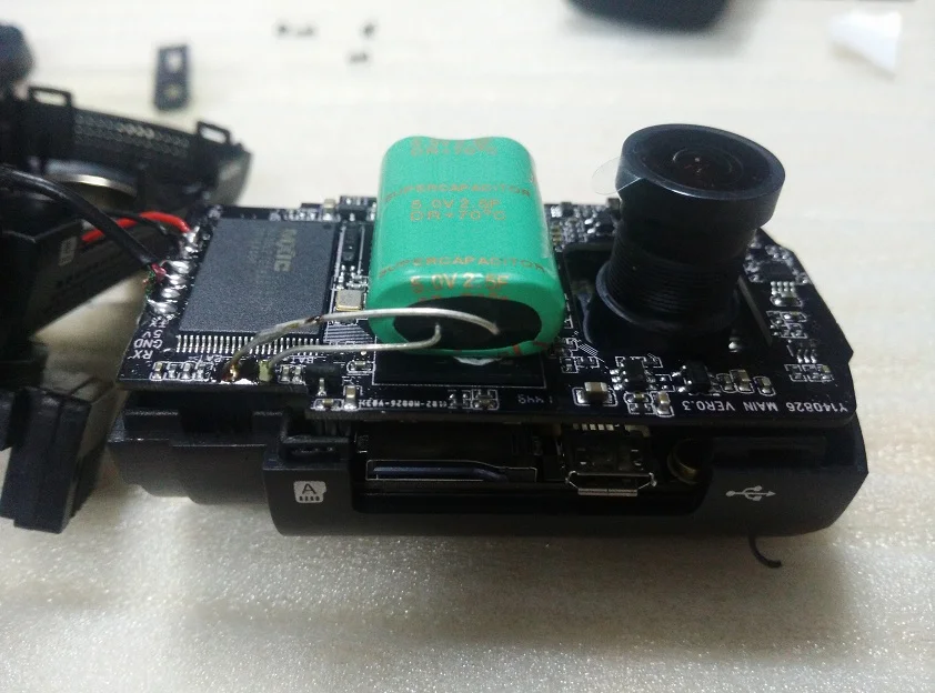

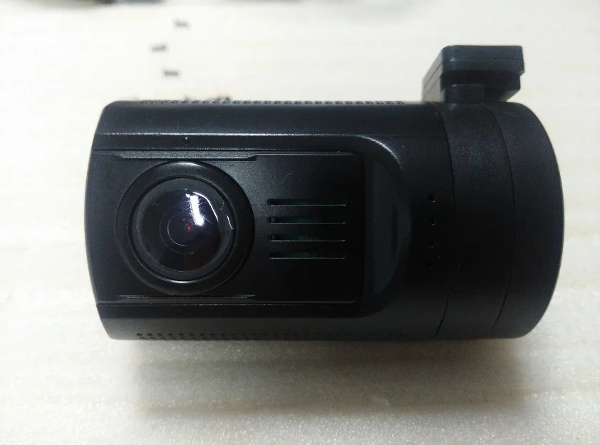

here is my unique mini 0806 on the world, for now.
I'm sure your supercapacitor was dark blue last time we saw it on your desk, being used as the heatsink has faded the colour! :D

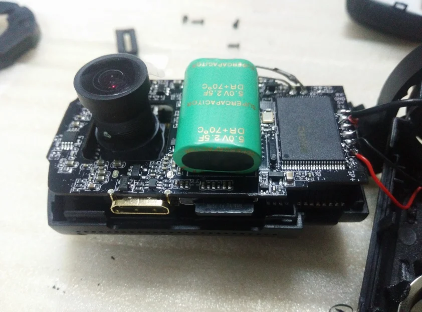

that is my personal widget, everyting same with current 0806, only changed Li Battery to a Super Cap. Just show you the practicability of a Super Cam version.
Does it actually work?
Some people may DIY that modification, but I suspect the super cap is not big enough without some big firmware changes...

The 0803 is well known for killing batteries due to heat problems, it would kill a supercapacitor too - the text on Raymans supercap says 70C, the lipo in my 0803 says 71C !
