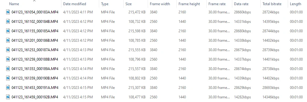

Front / Rear Camera Video Files - File Creation and Rotation Is Somewhat Offset From Each Other
The front and rear cameras each have their own processor. The creation of the video file for each camera is not synchronized as with most other dash cameras. There will be a several second gap between the timestamp in the filename for the front and rear video files. When I asked MIOFIVE about this, they stated it was decided to allow the video file creation to be as it is since trying to sync the front and rear processor file creation seemed to reduce the stability of the dash camera.
The filename timestamp values and the date modified values at always in Zulu (GMT) time. The timestamp that appears in the status line of the video will be converted to the local time based on the local time zone as determined by the dash camera based on its current location. This dash camera does not have a time zone configuration setting. It also deals with the DST being inactive or active. It properly determined that my location is currently GMT-7 based on daylight saving time being active.

I just installed the S1 Ultra this evening to do a little testing. Odd to see 4K30 for the front and 4K24 for the rear. The dashcam feels a little cheapy and it's also kinda hit or miss on whether or not I'm able to use the buttons on the side to pull up the menu. I haven't tested with older firmware though since I updated out of the box.
The first S1 Ultra I received had problems with the buttons as well. The second unit I received has buttons that have a slightly better tactile feel and work correctly 95% of the time. I would be interested in knowing how stable your front camera footage is using the front camera mount you received. The front camera mounts have been loose in the two adjustable joints in the mount. I'm on prototype #4 for an improved front camera mount. Each prototype has reduced the amount of shaking in the front camera footage. I hope to get the S1 Ultra with prototype front mount #4 installed in my car this week [car is still in the shop].
Thanks for the confirmation on the buttons. It's weird to not have a device do what it's supposed to do.
My front mount does lock down securely and looking through some highway footage today, things do look pretty solid. Admittedly it's a pretty smooth section of highway, but I'm not seeing any big bouncing or anything from the front cam.
