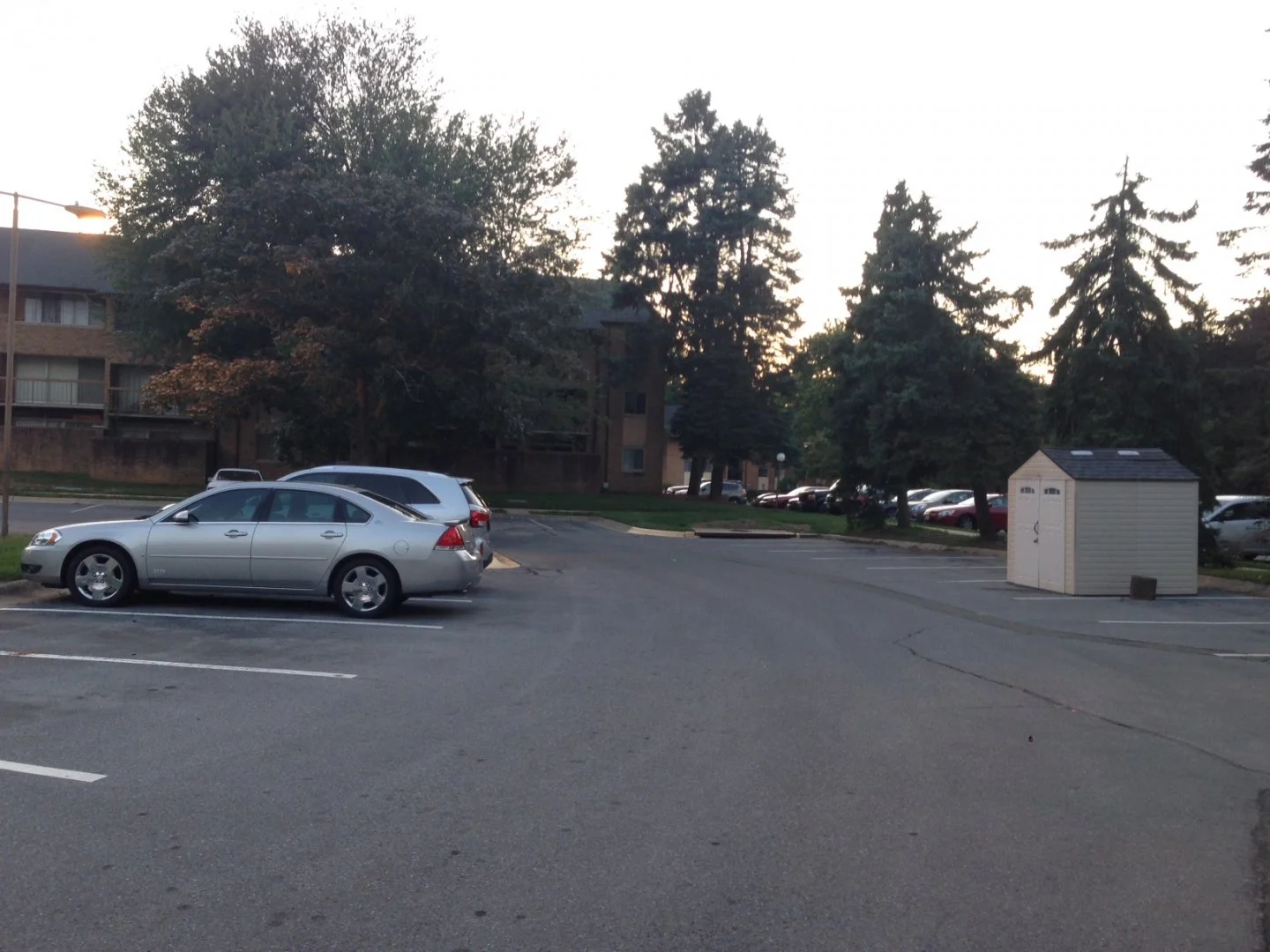

Hello!
I live in an apartment and have a shed in the furthest spot from the building that houses two motorcycles. In the last few months, it has been broken into at least three times a week and urinated on/in almost daily. The first time a motorcycle ramp was stolen but the bikes were not touched. Since then, I've reinforced the doors but they still get yanked partially open at least once a week. Someone has also been urinating on the doors, through the doors and placing random junk in front of the doors (tree stump, muffler, etc.). I need a camera that I can mount in a vehicle that will be parked across from the shed and will record with the vehicle off, preferably only when something is happening. I believe that I am looking for something with a low current draw, maybe no lights in standby mode (or I'll cover them with electrical tape), no screen or a screen that shuts off, motion detection and a long recording time. There is a parking lot light right above the space that the vehicle will be parked in so there will be some night time lighting although the times of the events seem to be both day/night anyway.
This is really the only use I will have for the camera, and hopefully won't need it after I catch the people involved (other than as a novelty dash cam since I'll own it) so I don't want to spend too much. But it is getting frustrating quickly so I'm ready to do whatever I need to get the job done within reason.
Am I in the right place? Any shared knowledge or recommendations would be appreciated.

I think the Mobius could work because it's small enough to be hidden and cheap. It is the size of a tic tac box so maybe concealed near the shed. Unless the lighting is good, any low price dash cam would be less effective than a security cam with infared.

Try these two:
1.
2.
Mobius wide angle would work also but the battery life is quite short so it would need to be hardwired.

As @GJHS mentioned a fixed surveillance type CCTV camera with infra-red illuminators would be the best thing you could use but that would require sustained 12V power to operate a typical camera and you would need a recording device to go with the camera. Also, for the IR camera to function properly, it would need to be outside your vehicle.
I think for this purpose, considering that it appears that you can park your car directly across from the shed, a dash cam with decent low light performance may well capture what you need. The photo you've provided shows a street light directly across from the shed, which would be behind your parked vehicle. This may be all the light you need and I think a Mobius could be a good solution for several reasons. Although, I would avoid using any kind of motion detection as it is not reliable in any outdoor setting from my experience, the new firmware for the Mobius can do great time-lapse video and it is highly adjustable. This could provide many, many hours of capture onto a 32GB card and ultimately give you freeze frames of the perp. On the other hand you could also do straight 720p or 1080p video and many people have had good success using 64GB microSD cards in the camera for extended capture. A Mobius with the standard "A" (narrower FOV) lens would probably be best for this purpose since you want details of the center part of your image. Another thing about the Mobius is that you can fit it with a super-capacitor in place of the internal battery for only around 6 dollars and this would be important and even necessary if you want to run the camera for many hours at a time to avoid overheating.
Another feature of the Mobius is that unlike most any other camera available, you can adjust various exposure parameters using the camera's GUI interface (on your computer). While many cameras allow you to adjust the EV and some other settings, the Mobius can finely adjust exposure, sharpness, contrast, saturation, color options and white balance and this would allow you to tweak the settings to work optimally under these particular fixed lighting conditions, especially if you need to optimize the settings for night time. The camera has switchable Wide Dynamic Range (WDR) as well as a dedicated low light setting.
Finally, there is the question of powering the camera for extended periods.
One option is to hardwire it to the 12V system in your car and there are several options available that will monitor your battery and cut power to the camera at the appropriate time so you don't come back to find a dead vehicle battery.
Another option, which is the one I would actually recommend is to buy an inexpensive high capacity external USB battery bank. There are numerous similar choices on the market in a wide range of prices but the one I've been using costs only around 20 dollars at the moment with free shipping from Amazon. It "claims" to have a 50,000 mAh capacity running a lithium-polymer pack. While the actual capacity is probably far less, I have been able to run a dash cam (not a Mobius) for just under 20 hours on a single charge. Although I have yet to test it, my hunch is a Mobius would run far longer on this battery. While this battery is a generic Chinese product sold under different names I've been delighted with the quality and performance of the battery bank for the price and I use it to run two cameras simultaneously in "parking mode" for many hours when I am out and about in my vehicle. This should give you more than enough running time for your needs in a simple to set-up, low cost package. All you would need is an inexpensive USB-A to mini-B 5 pin cable in your choice of length, such as this one.
One final thought. I see that the shed has windows in the door. Assuming the perp can no longer actually gain entry to the shed it might be an interesting option to mount a camera inside the shed facing out the window running on an external battery like I suggest for your car. In theory, this could capture a close-up of the guy's face and other important details that you may not capture from across the way.
Also, if there is one piece of advice I can offer from personal experience trying to catch a vandal on a surveillance system, Be Patient! It could take quite a few tries before you actually get the guy on camera, or get good enough footage to be legally actionable. Keep trying, adjust your technique if necessary, bide your time but eventually you'll get him.
