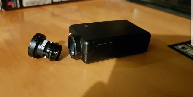

Hello everyone, I am new and introduce myself.
I am from Mexico and I am a recent possessor of a mobius 2 camera.

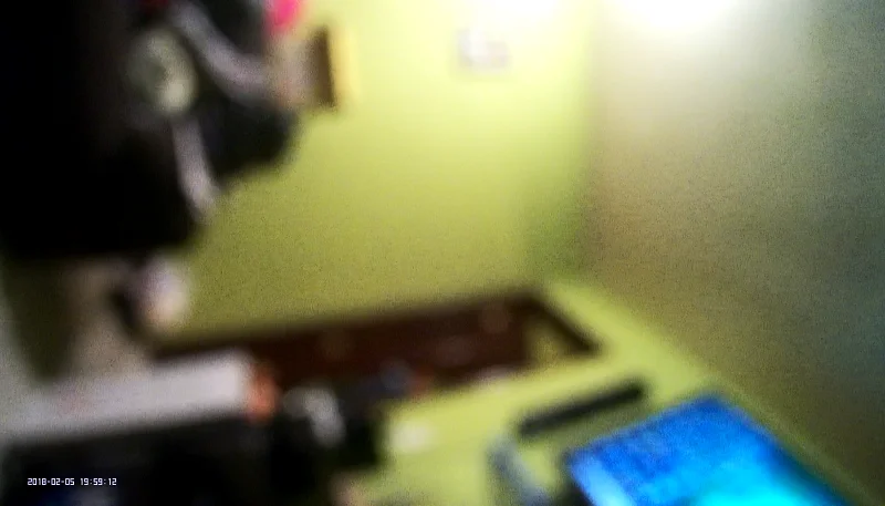

Yesterday, I wanted to make a recording, so I removed the lens cover, but I pulled it very hard and released the lens, I thought I had broken some cable, but apparently that did not happen (according to me).
Put the lens back in the hole of the camera and I thought everything was fine, but when making a recording, the lens is out of focus and the recording is very blurry:
Is the lens damaged? What I can do?
Thank you

You'll need to refocus the lens. Since the M2 doesn't support webcam mode (or it didn't from what I remember) and live video isn't supported by the mobile app.

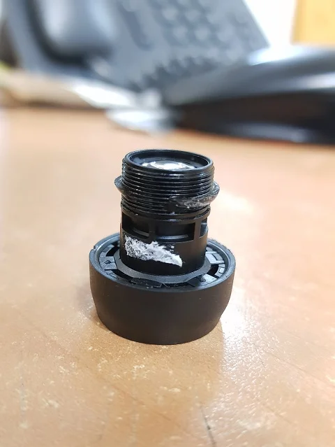

@irzea I've never seen a lens pulled out like that. It looks like the threaded lens holder has come apart, which I imagine would take a lot of force - much more than simply removing the lens cap. I'm also not sure why there is some white tape in there around the lens.

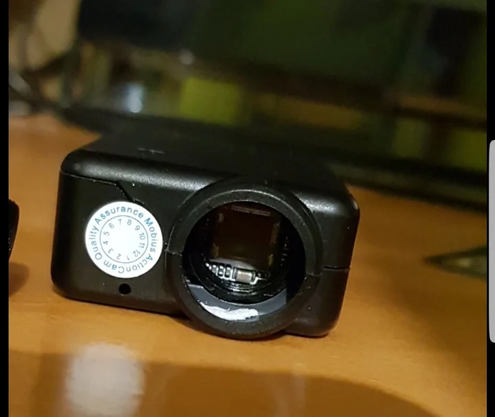

Did you buy this camera new or used?

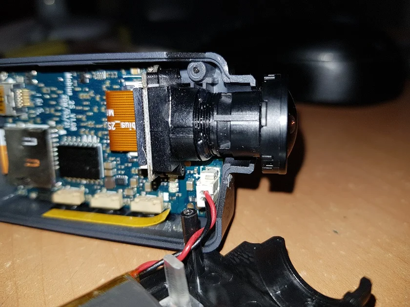

Do you have a small screwdriver that you can undo the two case screws and take some photos of the inside? I think we need to figure out what's going on before thinking about refocusing the lens.

No, I've not seen anything like this before. It appears that the lens holder is damaged. I have to assume that the camera was dropped or otherwise experienced some sort of impact (drone crash?) before @irzea .
I think @irzea has two options. Buy a new lens module that will come with a new lens or perhaps find a new lens holder (barrel) to replace the broken one. There may be a third option; maybe eletoponline365 or perhaps buymobius.com might be willing to sell a bare replacement module without the lens or just the threaded lens holder.

The construction for the new C lens for the M2 looks quite similar to the D lens for the M1. I think he exerted too much force and snapped off the front part of the plastic mount.

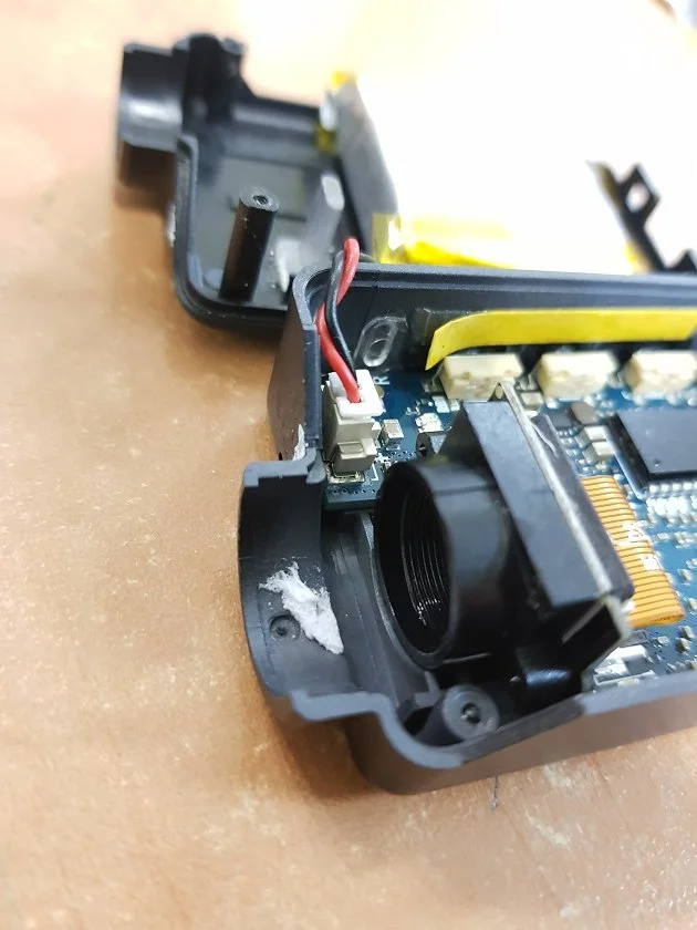

I was able to solve the problem:
I opened the camera and only had to "screw" the lens to the base.
The problem was that without opening the camera, i just put the lens and did not adjust it correctly.
The camera is new (eBay, eletoponline365), the white that is seen, is glue to hold the lens:

It really appeared from your earlier photos as it the lens module was damaged. Glad you were able to fix the issue. How did you achieve focus?
This user experience is another example of why the decision to glue the lenses into the module and eliminate the set-screw from the original Mobius is such a bad idea. In my view, just about everything about the M2 vs the M1 is a step backwards.
