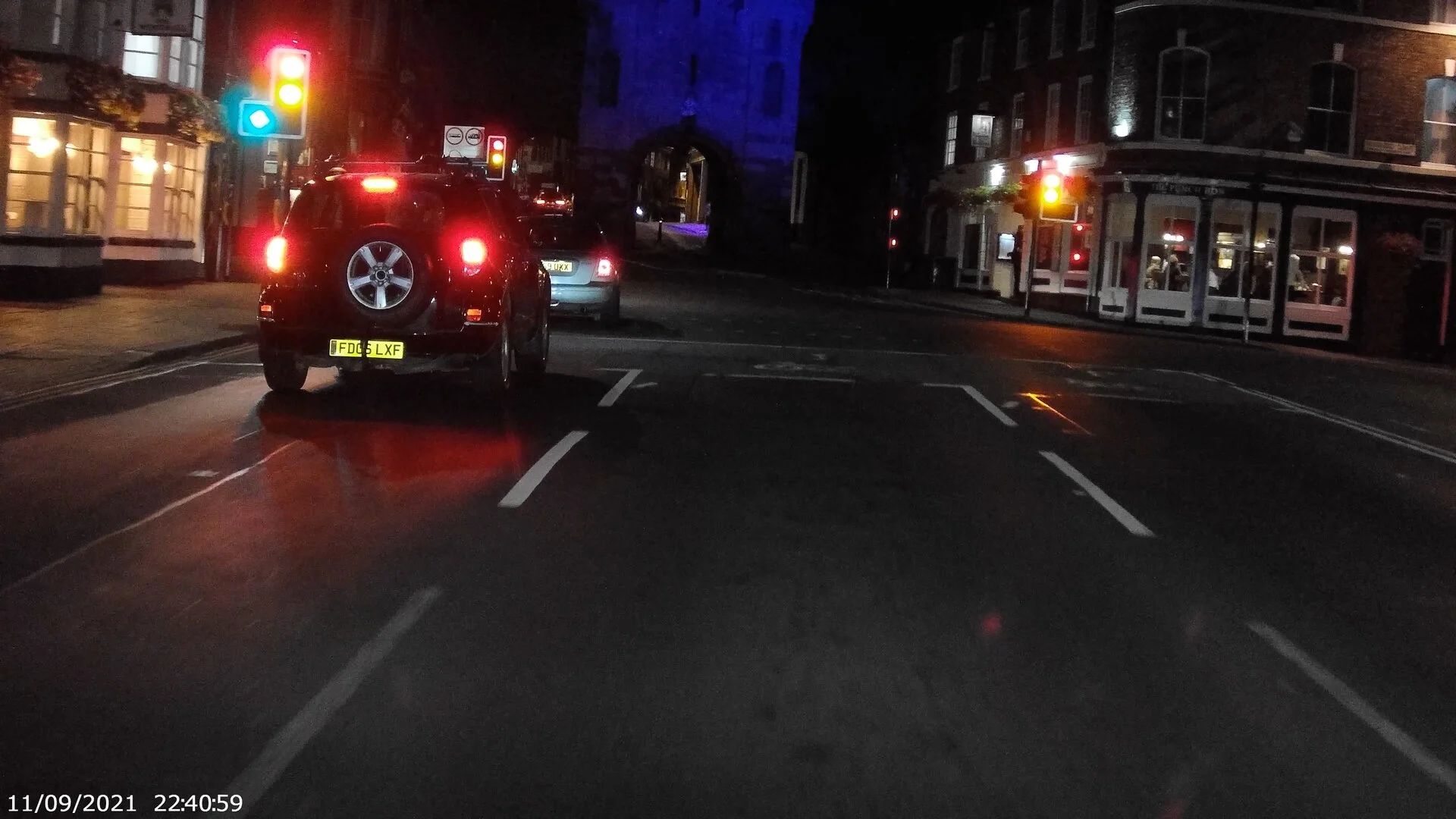

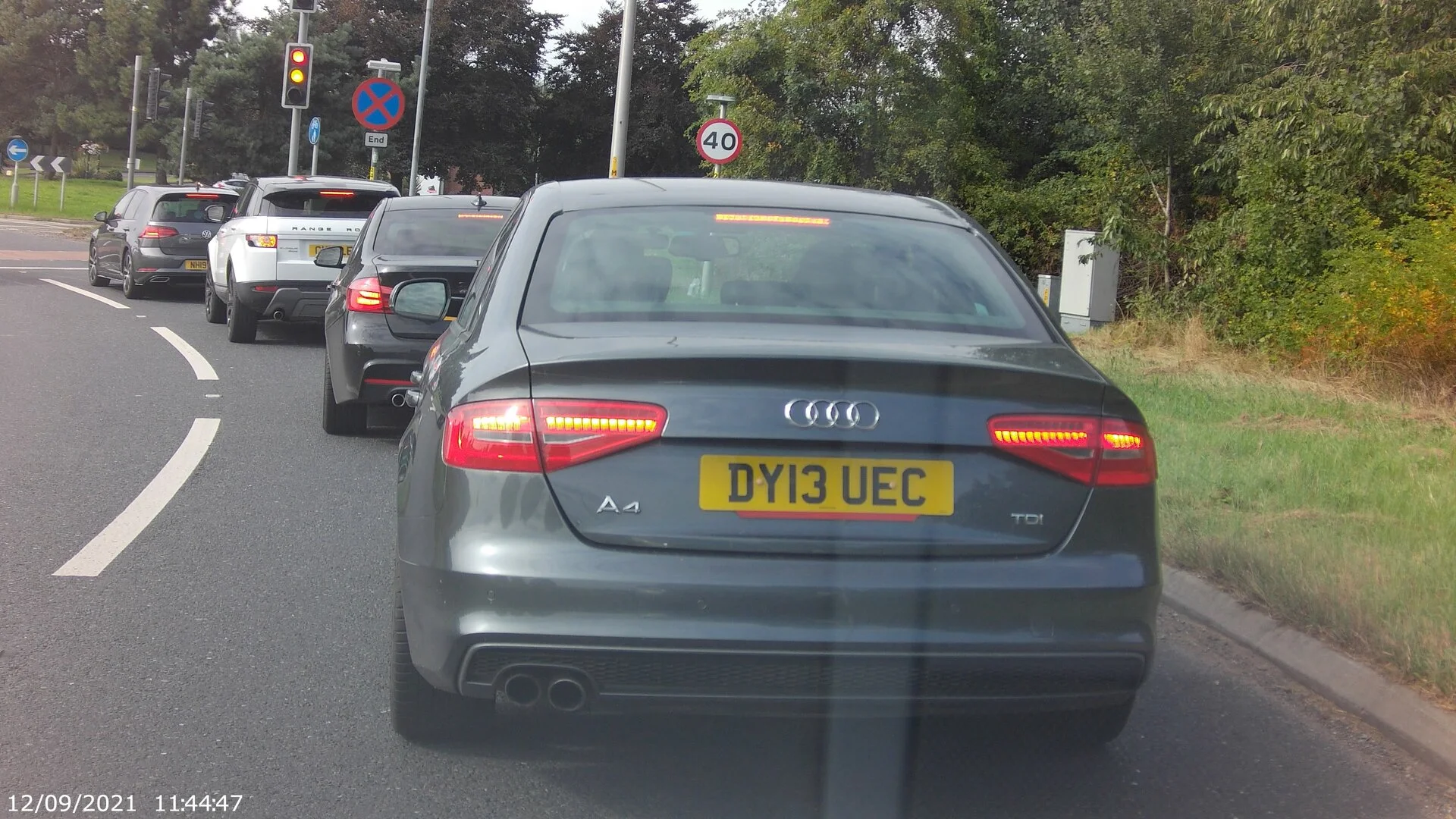

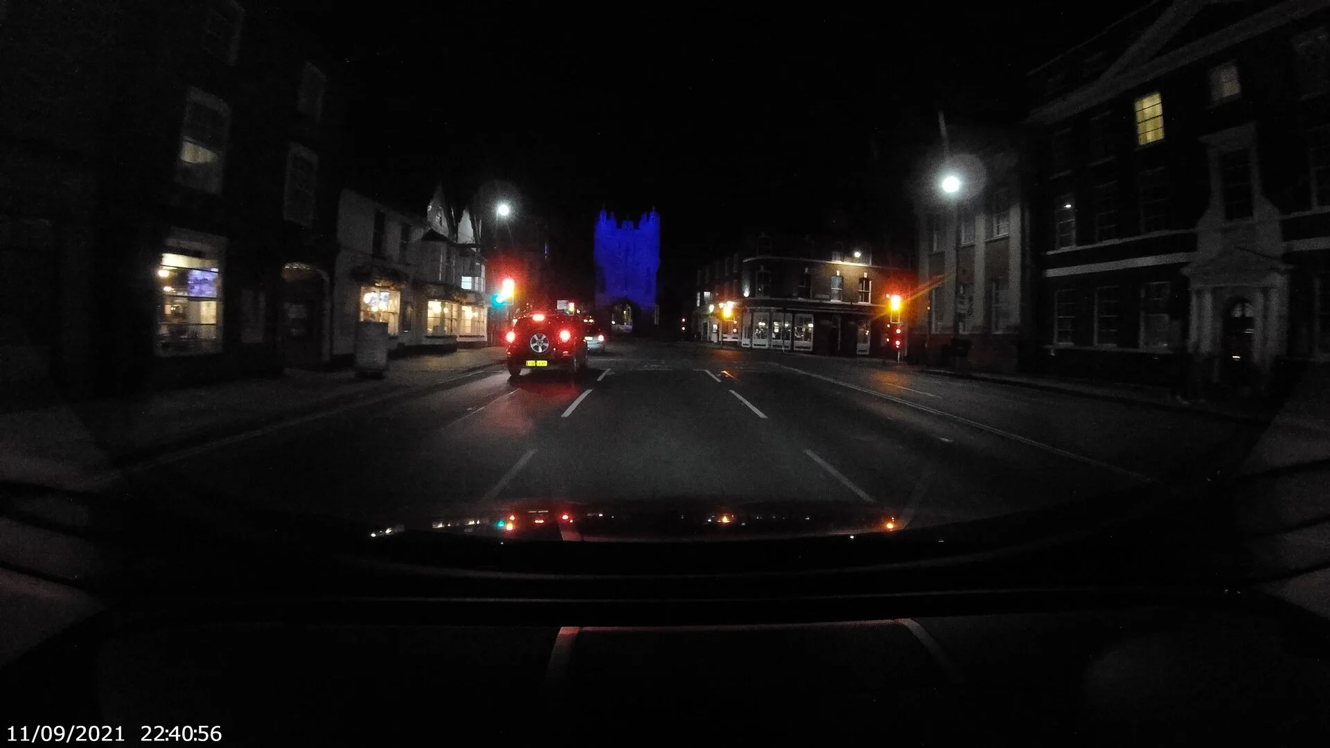

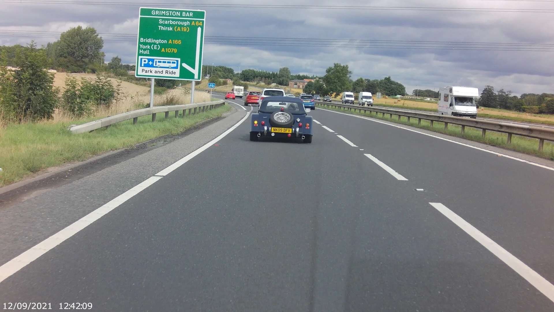

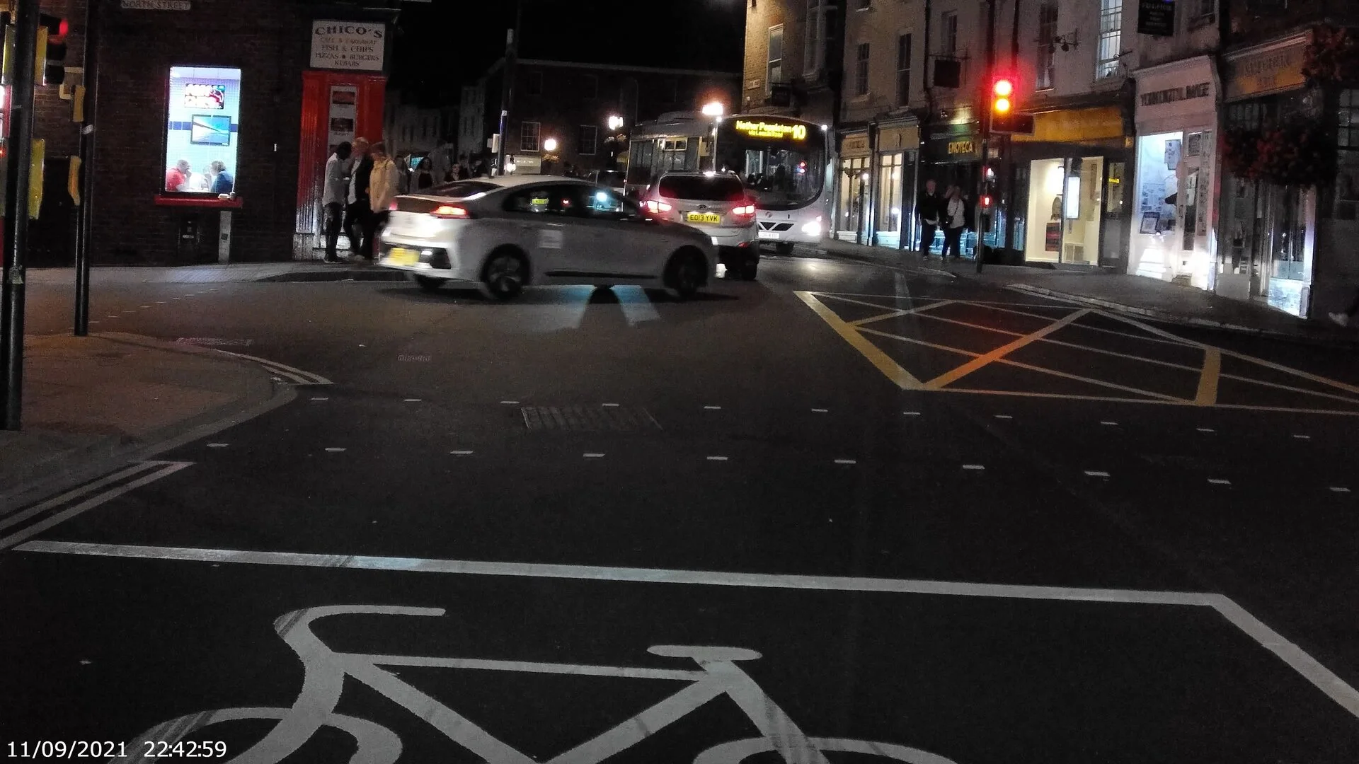

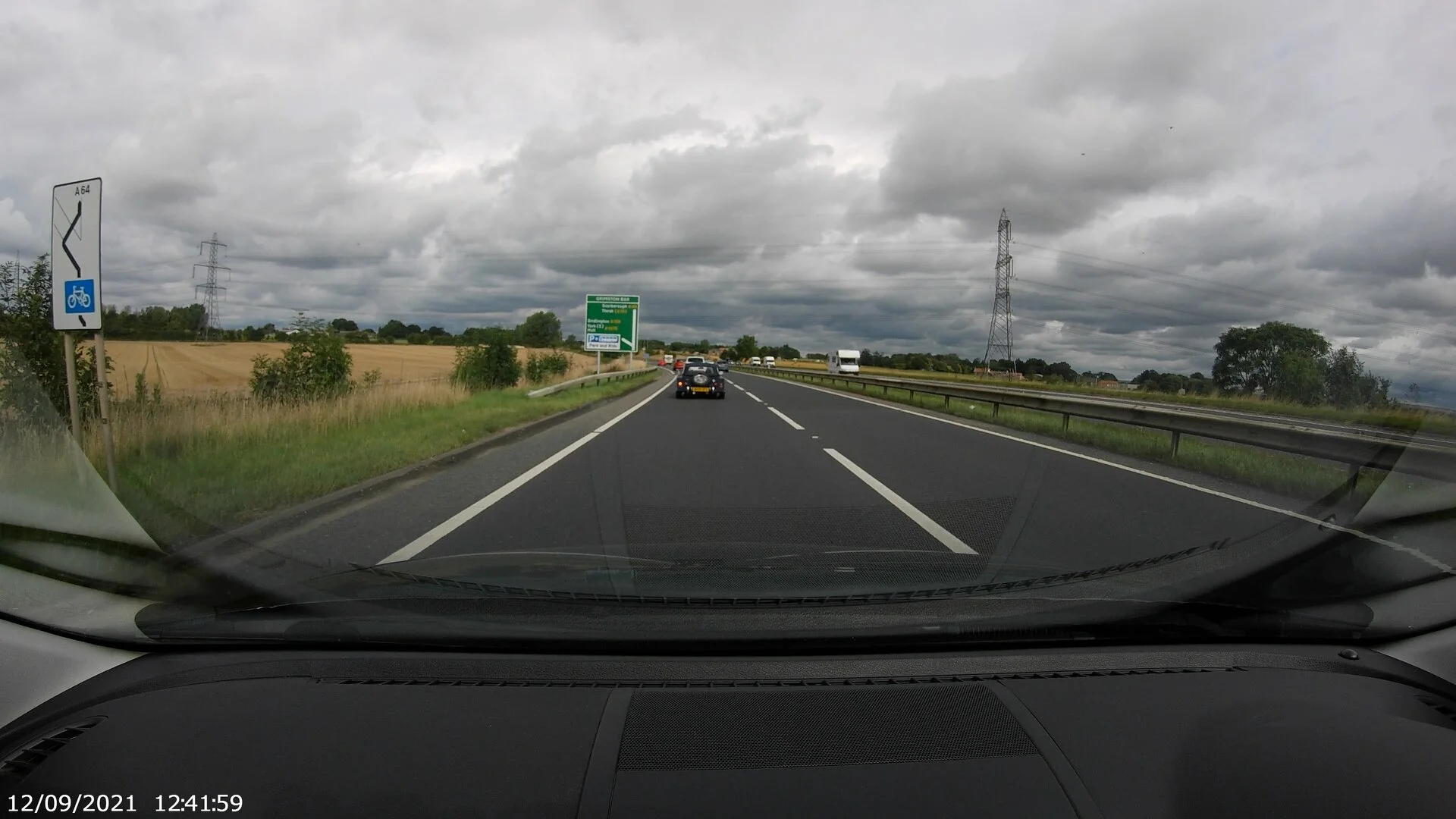

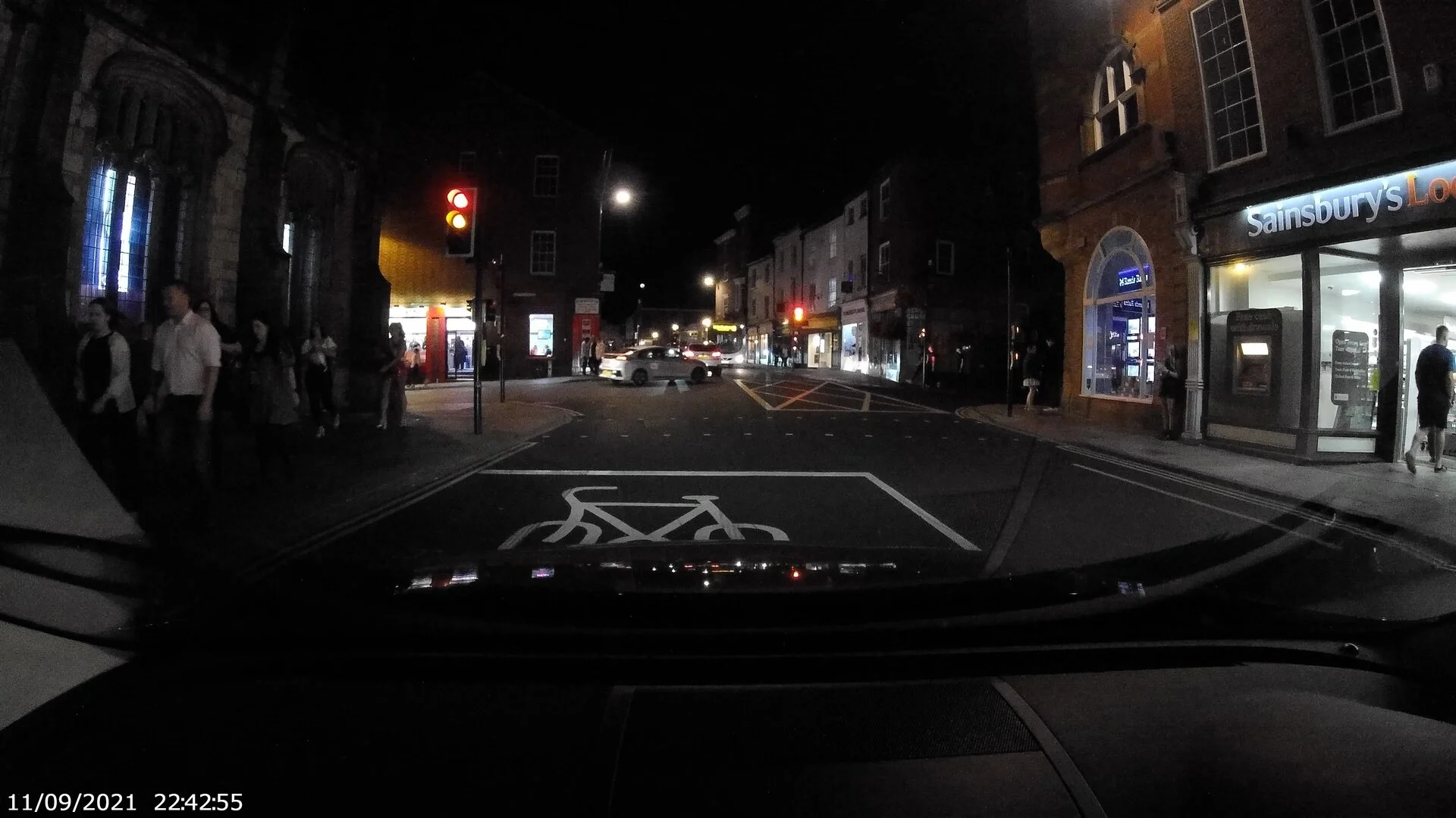

The 3.6-11mm zoom range is rather versatile when using the Maxi 4K as a telephoto dashcam. This series of full-frame screenshots show the effect of using this lens at approximately the middle of its zoom range, compared to the standard Maxi 4K with its wide-angle 4K lens.
The telephoto video works well for capturing the number plates of cars that you are following, or observing the behaviour of drivers and other road users ahead of you such as using a mobile phone while driving. The metering is much less affected by dark or bright areas because the narrow FOV is concentrated on the road and cars ahead.
Here are a few day & night compilation videos showing the Maxi 4K with the 3.6-11mm varifocal recoding alongside another Maxi 4K with the standard wide-angle lens.
Both cameras: 4K 30fps, 60Mbps, centre-weighted metering, EV+0

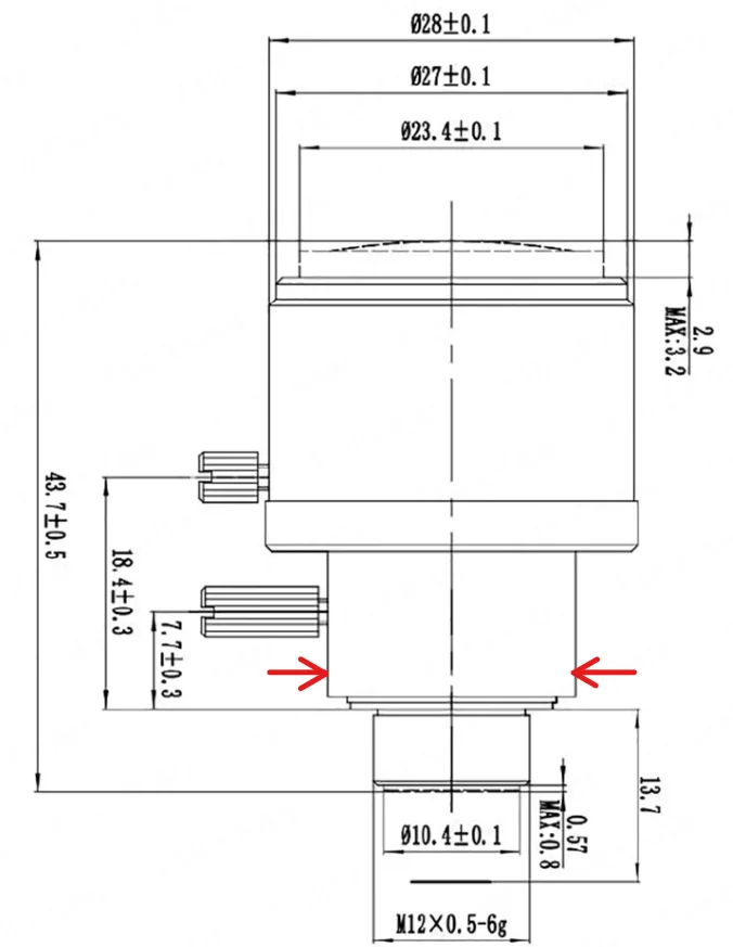

Can you elaborate further on your comment about the internal diameter of the lens surround?
Note that the release version of the Maxi 4K has a built-in lens surround with an internal diameter that is just too narrow to fit the rear section of the Varifocal lens.
Are you saying the surround is "too narrow" for the threaded rear lens barrel to seat properly or some other part of the lens?
The ID of the lens surround is 18.45mm, which is a snug fit for the 17.9mm OD of the standard lens.
The OD of the zoom barrel is 19.0mm.
Thanks for the more detailed explanation. Now I see what you were talking about.

These look great, especially the nighttime views compared to the Mobius 1.
I was pleasantly surprised by the clarity of the night-time video. The camera's wide dynamic range and tendency towards highlight priority appear to work well on reflective number plates, without darkening the rest of the scene too much.

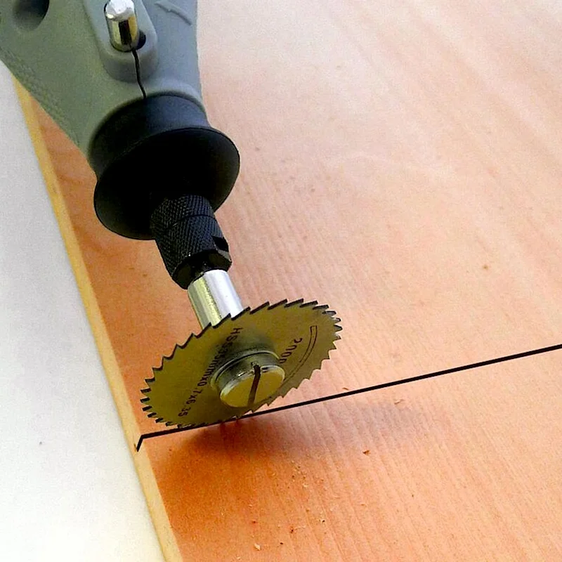

It sounds like a bit of modification with a Dremel tool would be all that is required to get the Maxi 4K innards to fit the old Maxi case. Then again, one could simply cut the lens shroud off of the 4K housing using a Dremel tool fitted with a fine toothed circular saw blade and then clean up any rough edges that may remain. These blades look like this but with finer teeth.

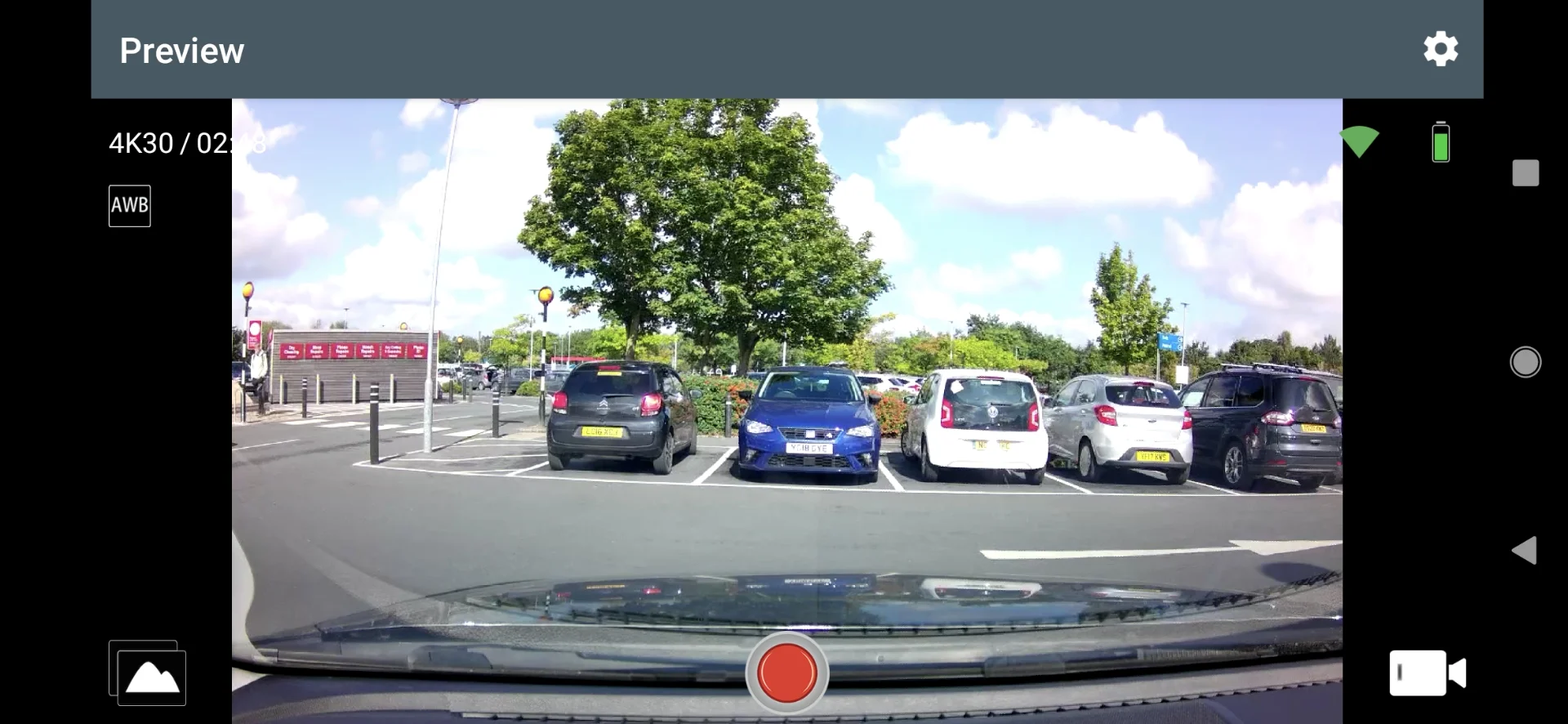

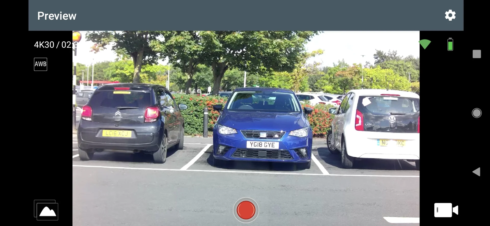

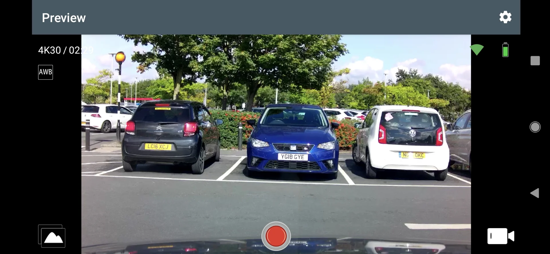

The wide and telephoto extents of this lens cover a useful range for dashcam video.
At the wide end, the FOV is not much narrower than a typical dashcam.
At the telephoto end, the FOV is approximately 1/2 width and 1/2 height of the wide view.
My preferred view is close to the telephoto end, but pulled back far enough to include the front edge of the car, providing useful context or a reference point to the video.
These screenshots were taken from the iSmart DV2 app, connected to the Maxi 4K over WiFi.
