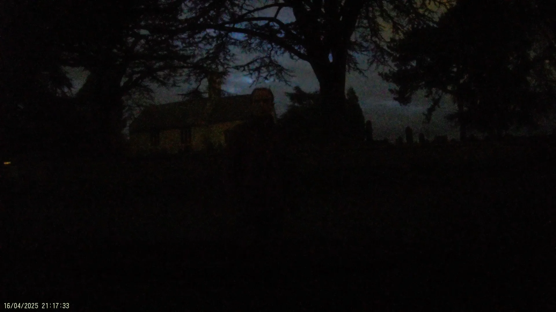

First up, the Vantrue E1 Pro with its IMX678 STARVIS 2 sensor, HDR enabled, PlatePix disabled. Almost complete darkness.
Next, the SLL1 with LFR turned off, so full 30fps. We can see the tree outline against the sky, but not much more. However this is slightly brighter than I could see by eye.

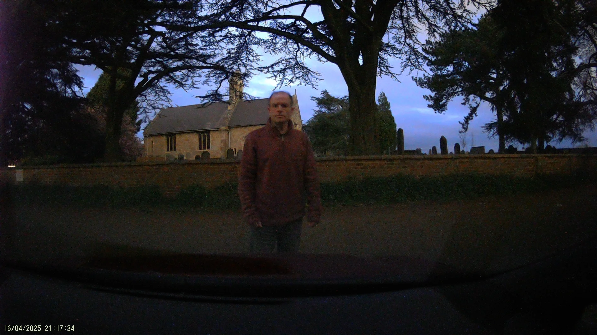

And last, here's the SLL1 with LFR enabled, running at it's lowest effective frame rate of 1fps (30 duplicate frames per second).
Yes, I did stand still for more than a second. At normal walking pace I was just a blur.

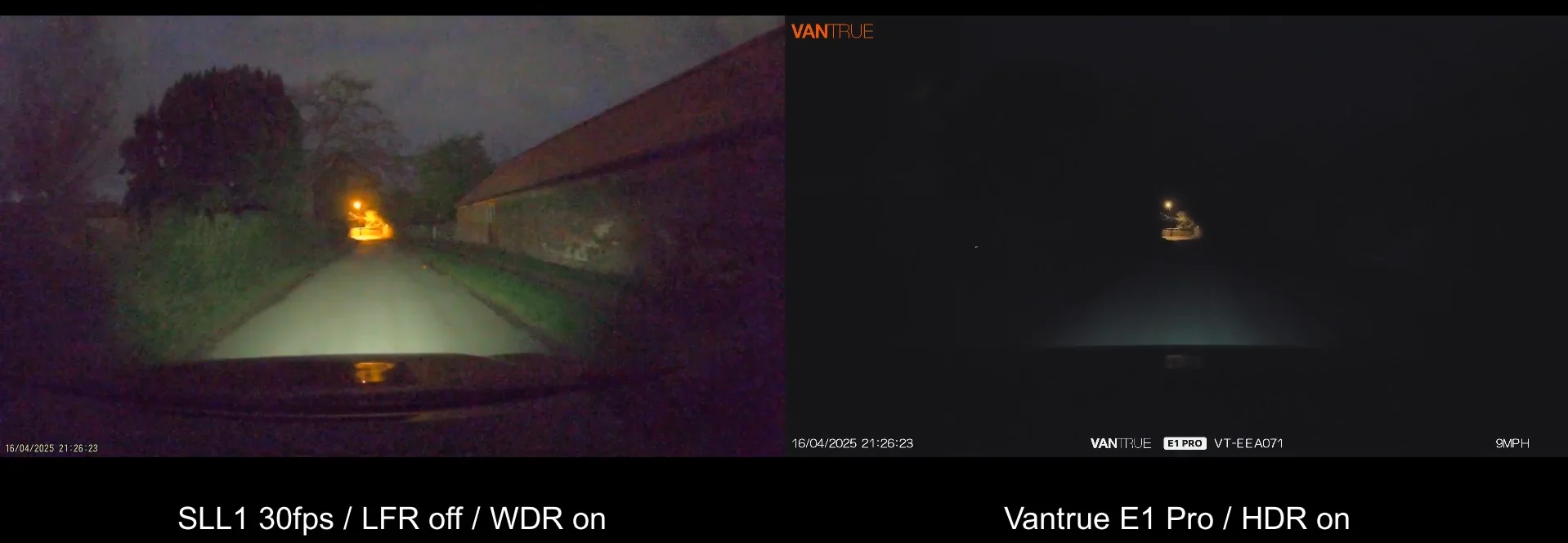

Driving away from the church, using only the side-lights on my car, the SLL1 with WDR enabled captures much more of the surrounding environment at full 30fps than the E1 Pro. Of course most people don't drive with such low power lighting, but it might be relevant for cyclists or some other situation?

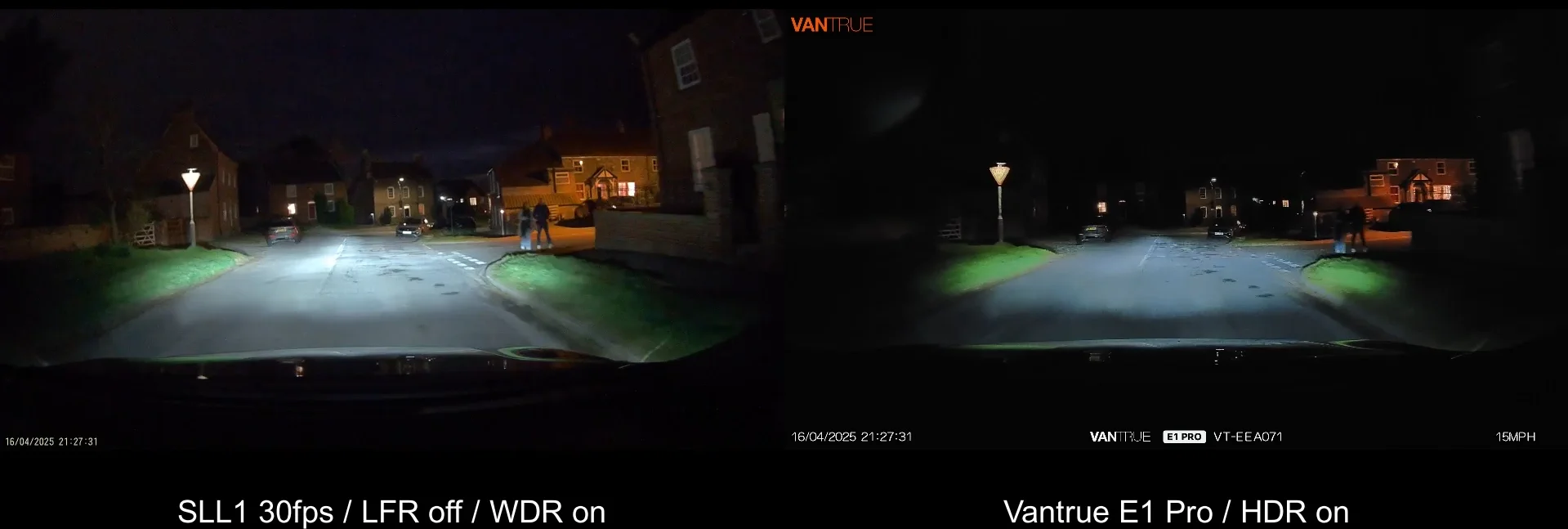

Even after turning on the normal headlights, the SLL1 has so much more peripheral illumination of roadside features. It is better at showing things like animals, pedestrians or cyclists that are outside the central headlight zone but might affect your driving behaviour. The main downside is that the SLL1 does not have HDR.

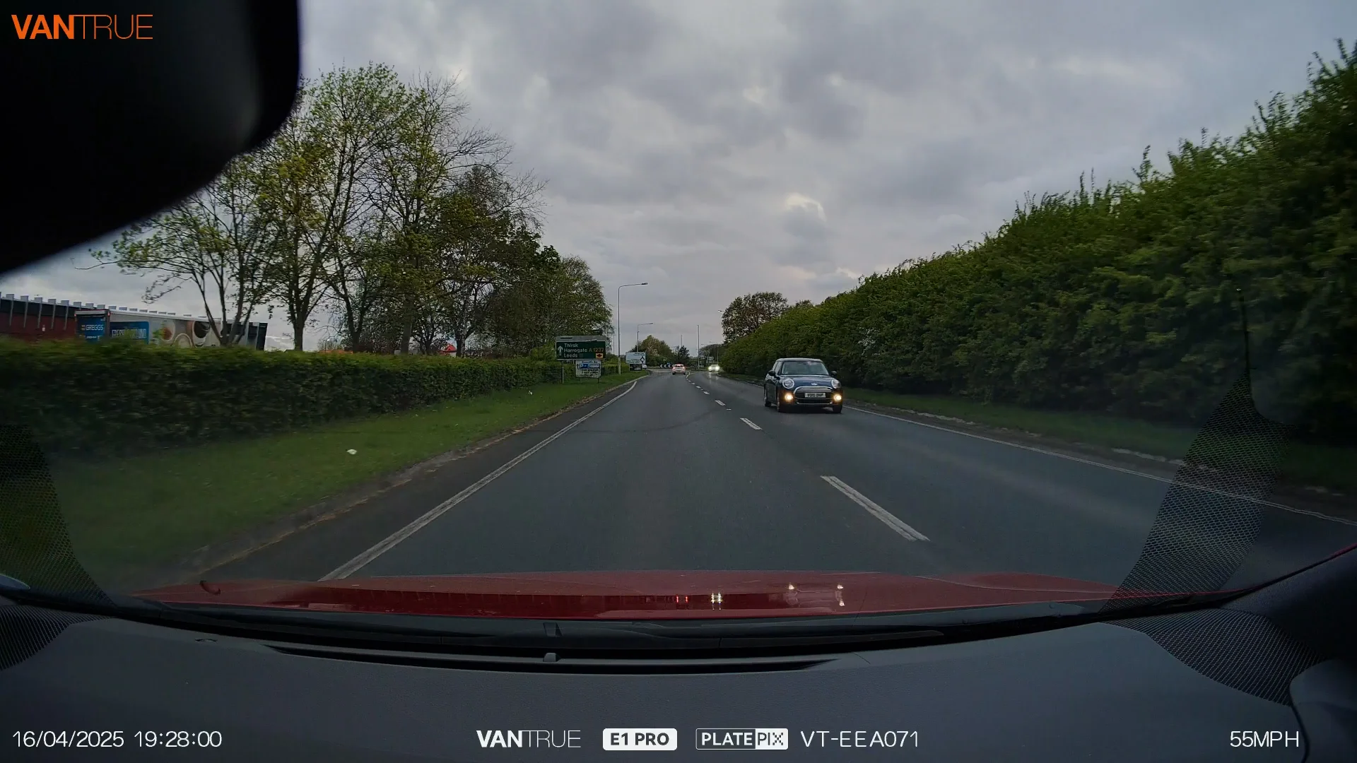

Despite recent advances with STARVIS 2 sensors and HDR at night, many dashcams struggle in poor lighting when it is not dark enough for HDR to be effective.
I recorded this sample footage about half an hour before sunset. Some drivers were using their headlights, myself included, but this was mostly to be seen. I have my Vantrue E1 Pro set to PlatePix on and HDR off during the day, so these were the settings at the time of this recording.
With its sensitive sensor and fast lens, the SLL1 proved itself to be capable of faster/shorter exposure times for each frame than the E1 Pro, resulting in less blur and more detail despite the lower resolution of 1080p compared to 4K.
Driving on a straight road at 50mph, the best results on the E1 Pro came when the subject was further away, whereas the SLL1 performed better at close range.
At slower speeds through a village, there was less difference between the cameras in terms of blur and detail.

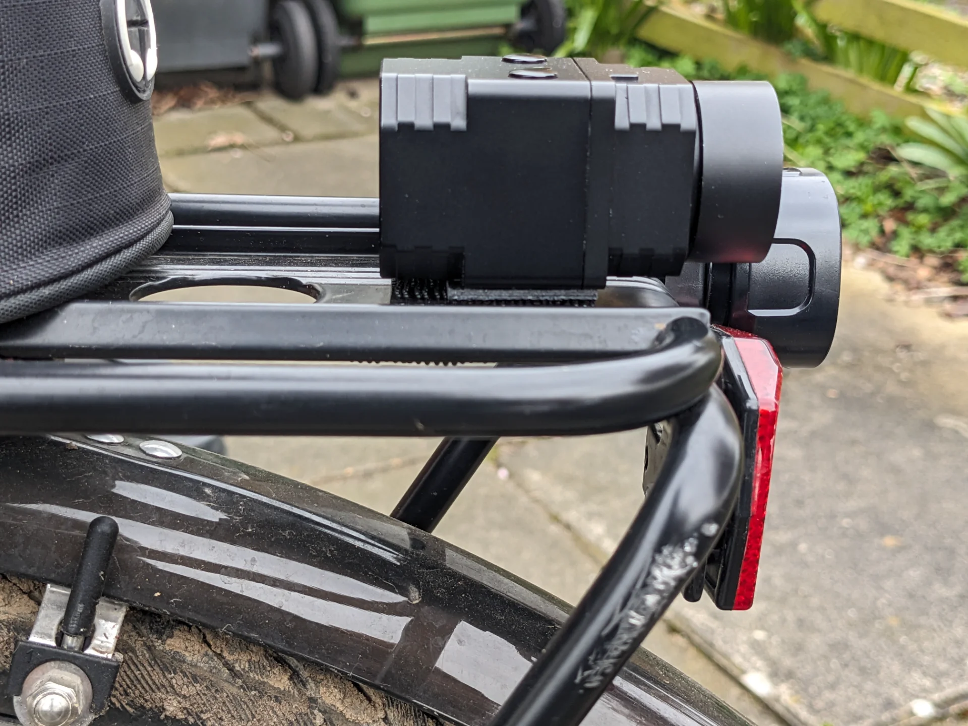

Mobius SLL1 vs Mobius Maxi - 60fps Bike Camera (1 hour after sunset)
A short comparison of the SLL1 vs the Maxi 4K, on a bike ride an hour after sunset.
Both cameras set to 1080p 60fps.
