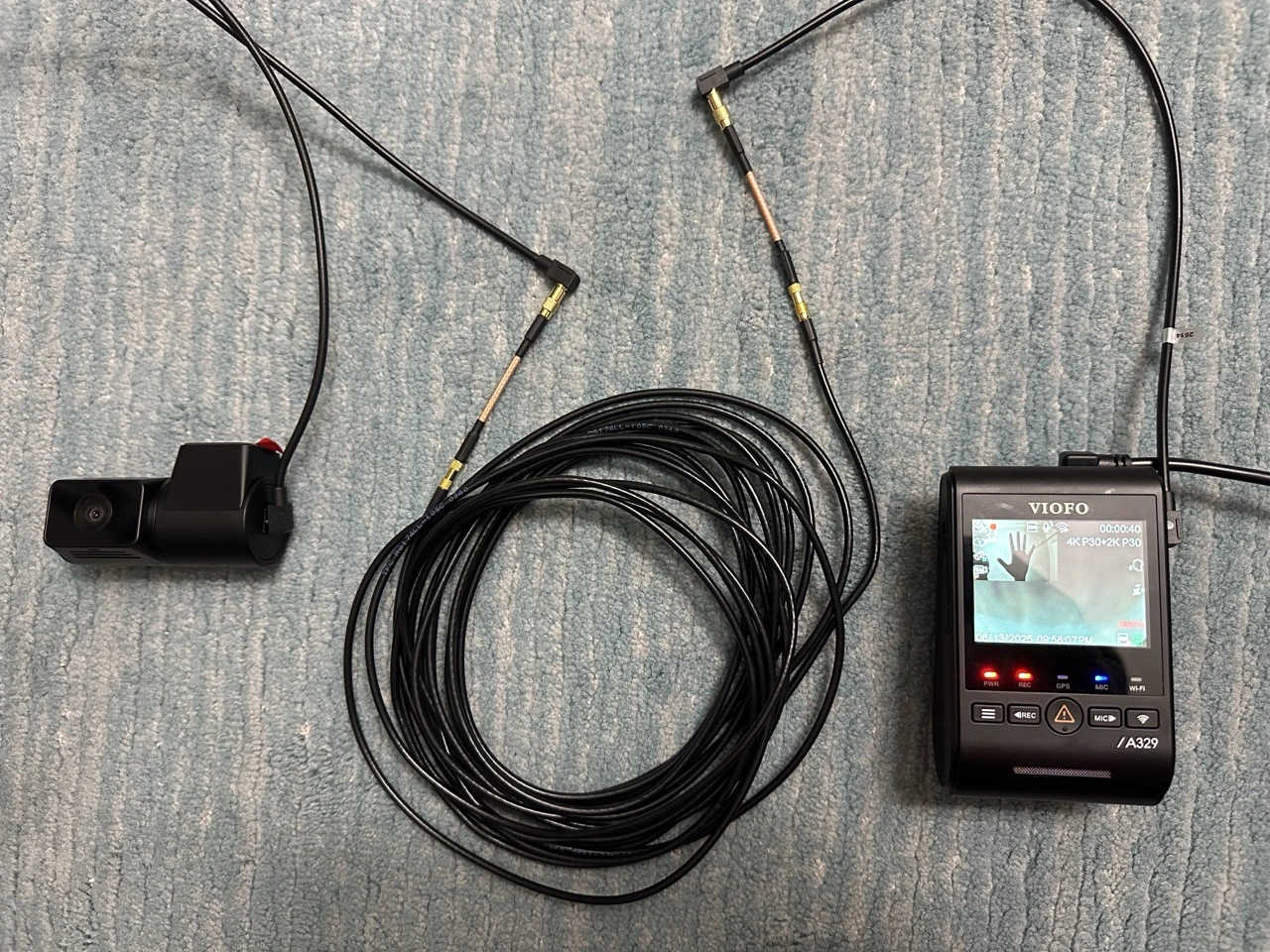

Success!!! Got the A329S front/rear cams linked via an A139 Pro cable! 🙂
I ordered a pair of MMCX Female / MCX Female adapters from eBay here, and they did the trick! The A139 Pro's smaller MMCX cable clicks into the adapter while the A329's larger MCX cables simply slide in, but either way they work!
Definitely gonna save me a lot of headache now that I can reuse my existing cable. 🙂 Thank you @lufa6977!
Excellent, but if you do encounter any issues with the camera, do consider that it may be a cable problem and don't instantly blame the camera. With the extra joins, there will be signal reflections at the joins which could corrupt data and there could be power issues due to extra cable resistance.
It is a nice test though, good to know that the coax connection is quite robust 😎
WoooHooooo! That is great news indeed. So very glad the adapter you ordered worked, now you and others will not need to rip out coax as you change dash cams. I would think the adapter will also enable different brands of dash cams to use the same, already in place, coax.
