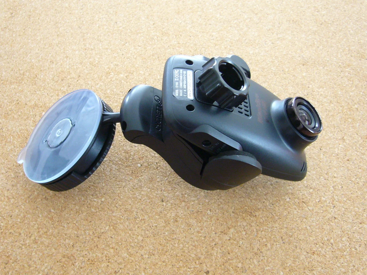

New Mount

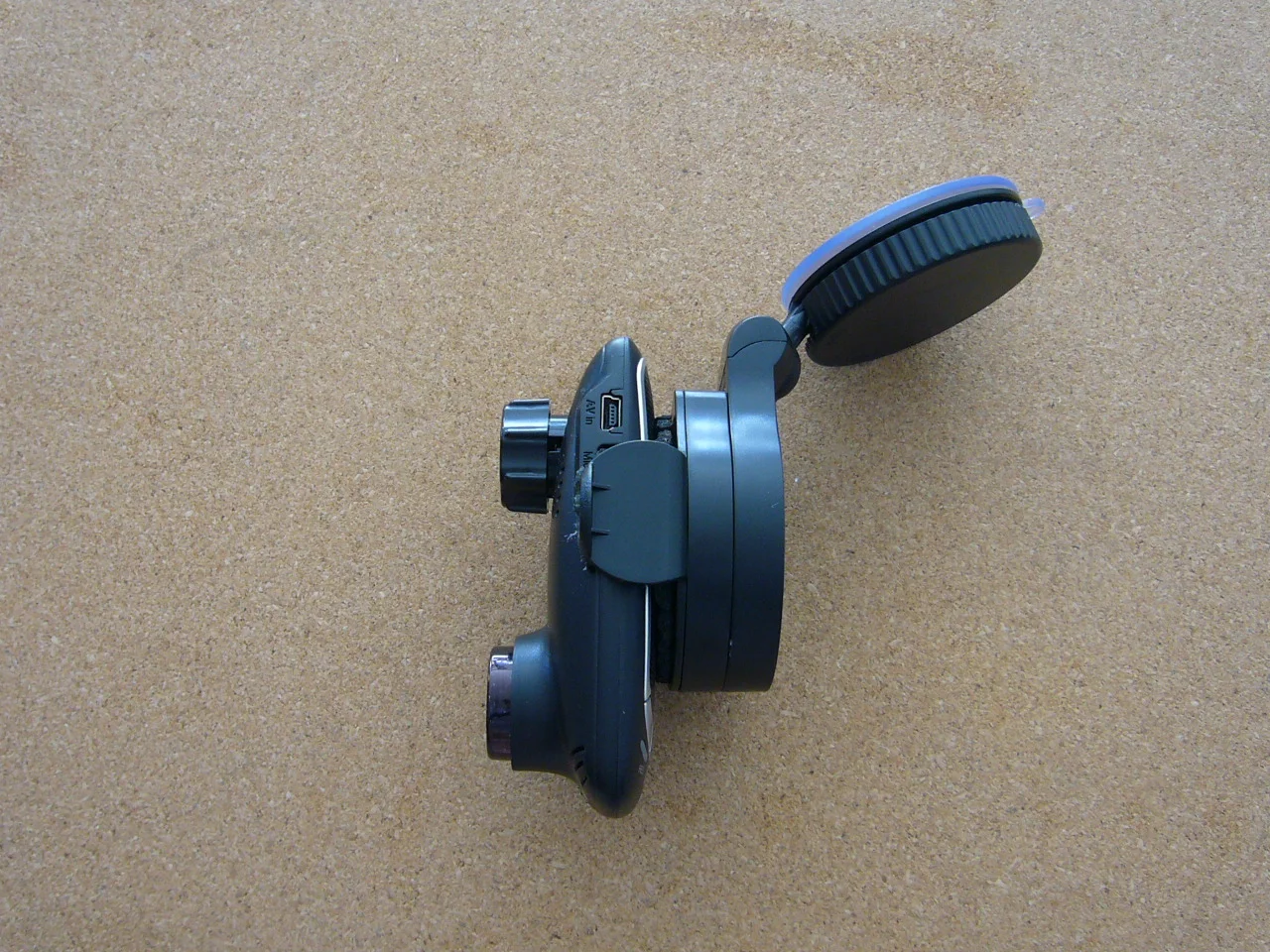

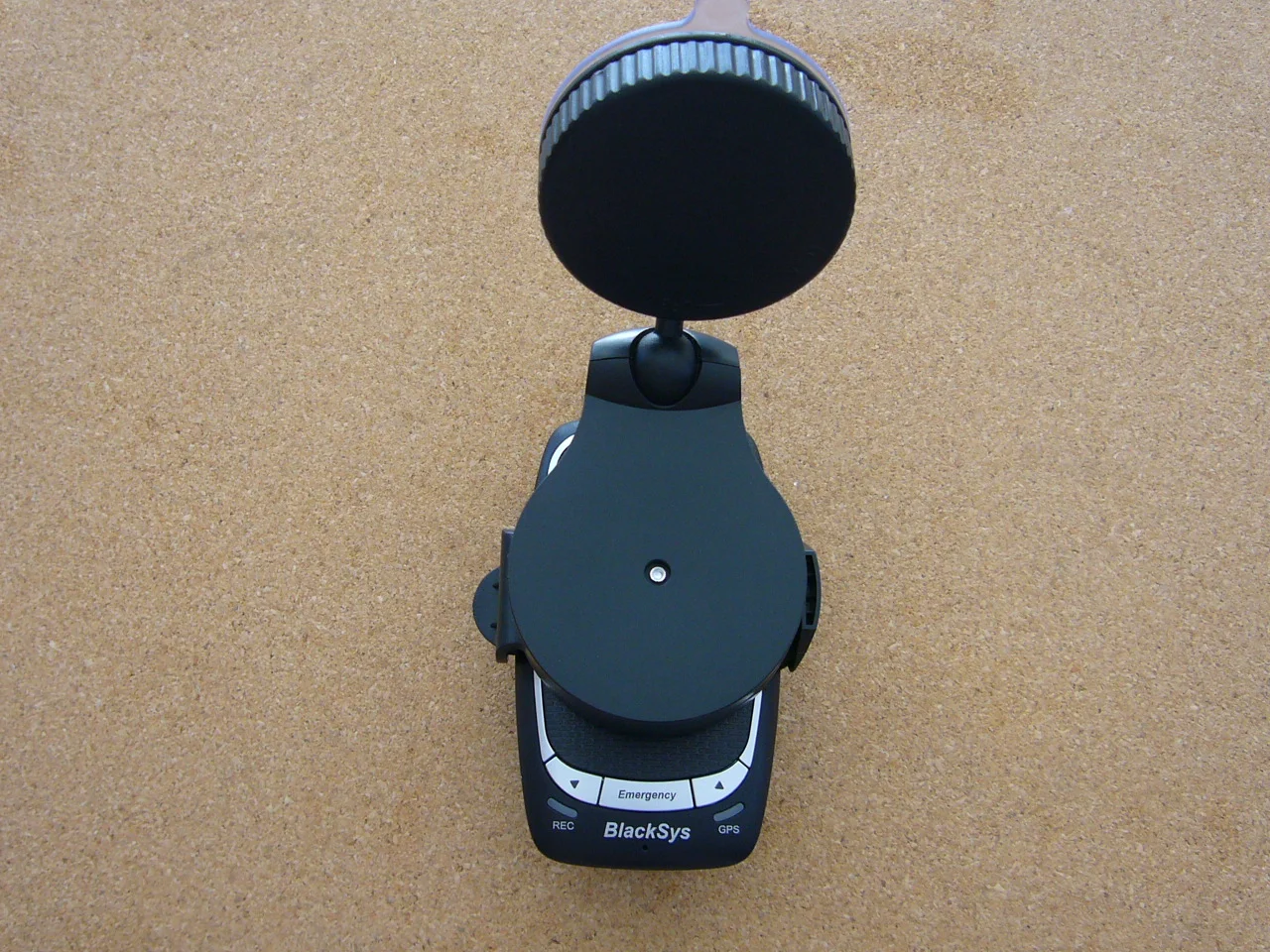

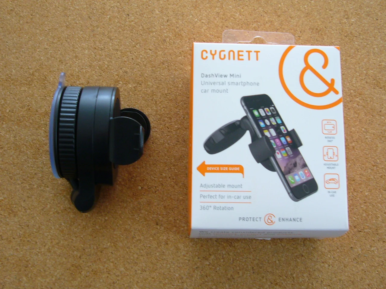

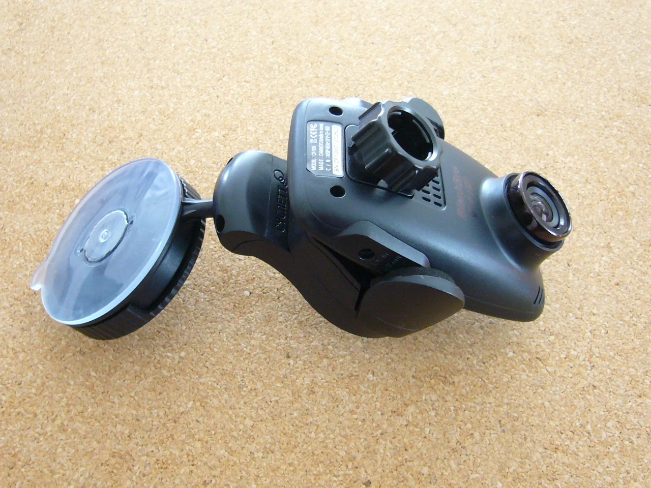

Whilst rummaging through the bargain bin of a technology store, I came across a small smartphone car mount which I initially intended to use for my Sony Z3 Compact. It then occurred to me that it would likely fit my CF-100 if the mount were turned upside down.
View attachment 22100 View attachment 22101 View attachment 22102 View attachment 22103 View attachment 22104 View attachment 22105

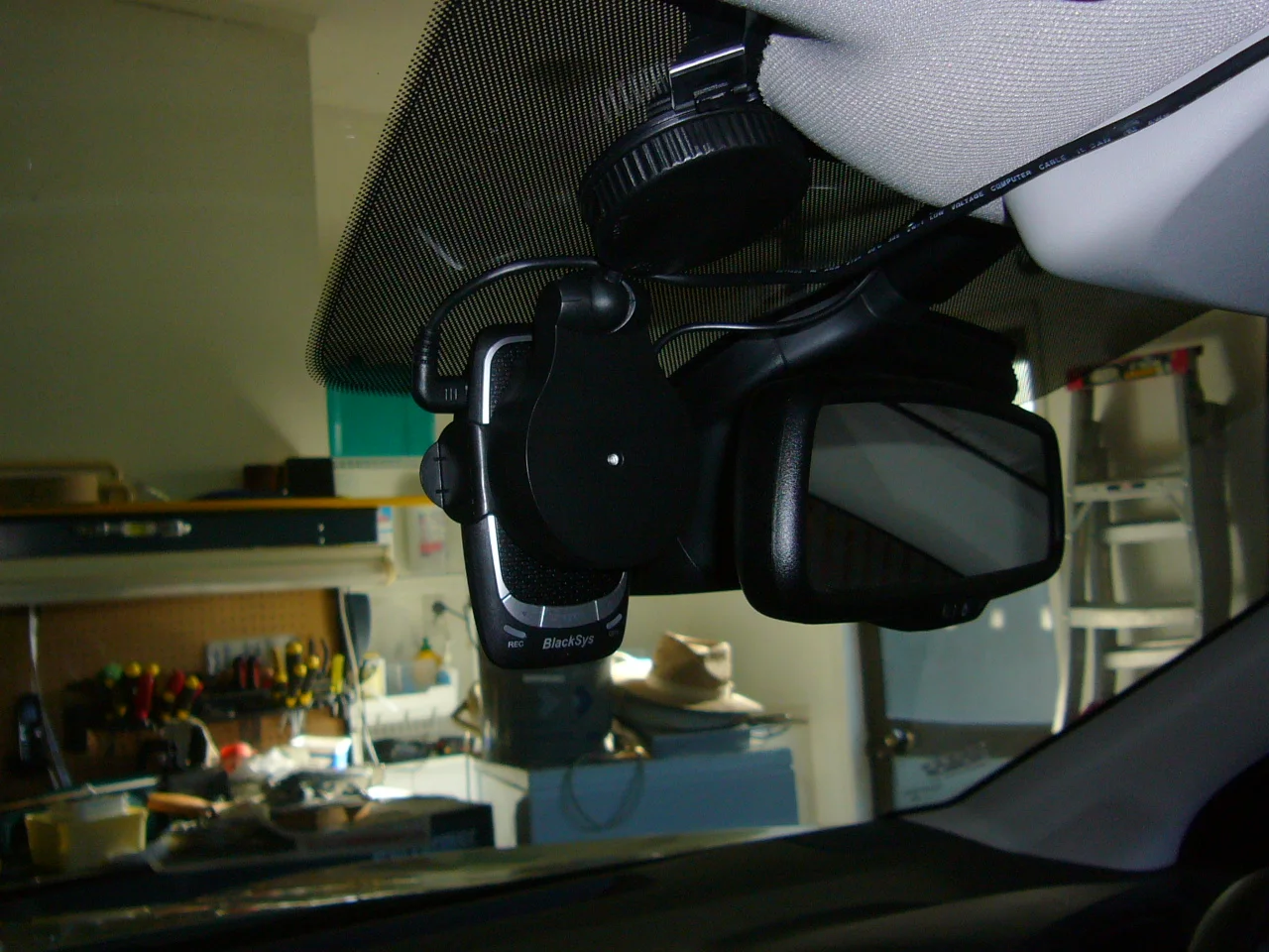

Short answer is that it does fit . So far I'm very pleased with it after making one simple modification that had a major effect - see later. Note that in the last photo showing the camera in the car, I had to move the camera to a lower position as the binnacle behind the mirror was showing up in the video. BTW, that massive binnacle has meant it is impossible to mount the camera except in plain sight.
First the good news:
- The mount is easy to fit and can be removed one-handed by rotating the round piece behind the suction cup; two hands should be used to remove the camera from the mount as the jaws are spring-loaded. Feedback on some sites suggest that the mount does not hold well to the windscreen, but I've had it on over a week and have had no issues. I made sure to wipe both the glass and suction cup with alcohol first.
- Easy to adjust. Rotates and angle can be changed.
- Camera can be positioned to allow access to the micro SD card and power connections.
- Camera is held securely between spring-loaded, EVA foam-faced jaws.
- Holds the camera close to the windscreen.
- Inexpensive. Only cost NZ$10 (<US$7).

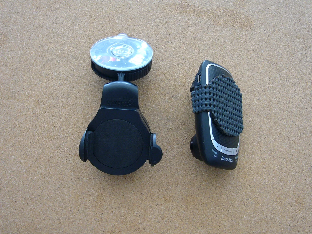

I was really pleased with how easy it was to set up but on my first drive, the g-sensor was going off like crazy! I checked to see whether the camera was touching the glass or the sensitivity setting had changed, but neither were the case. However, the EVA foam on the jaws was compressed and the camera was touching the plastic part of the jaws. When I compared before and after videos (previous mount was the original Blacksys mount attached with 3M Dual Lock), the previous was completely smooth whilst the new was very jittery.
Basically, the smartphone mount is TOO rigid and was transmitting all the road vibrations to the camera. I've largely fixed it by cutting-to-shape a piece of rubberised, non-slip drawer liner to wrap around the camera where it touches the mount - see 5th photo. The jittery video has gone and it only activates the g-sensor slightly more when compared to the Dual Lock. The liner will likely compress over time, so when it becomes ineffective, I'll just replace it.
I think the trick is to stop the road vibrations from being transmitted through the mount to the camera by "uncoupling" the glass from the camera, either where the mount is attached to the windscreen or where the mount contacts the camera. In a previous posting, I noted that there was a degree of movement in my Dual Lock mount, but in hindsight, it's this very sloppiness that appears to act as a vibration dampener. If you look at the construction of Clear Dual Lock, it has a 0.5mm of gel backing on each piece of the tape and when the two pieces are connected, there is about 0.5mm of movement. We all know how gel insoles etc are supposed to be good at absorbing vibrations, so it seems it may have the same effect on reducing the g-sensor sensitivity. Note that Black Dual Lock has foam backing so there may be less dampening??
So for those who have over sensitive g-sensors, a simple fix may be to use Dual Lock and/or put some sort of padding such as foam between the camera and the glass.
Hope this helps
