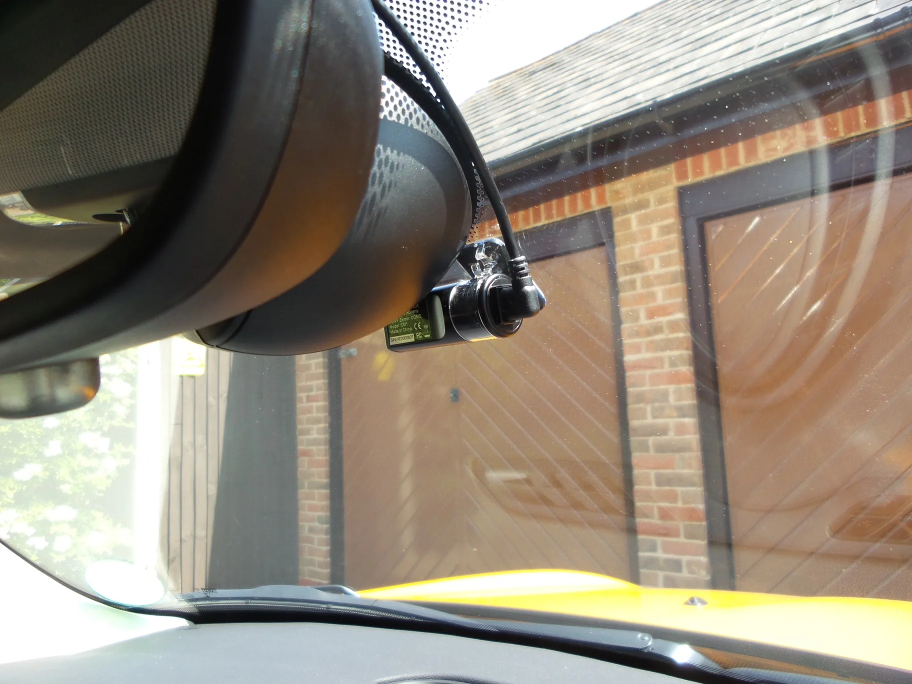

Is the underside of the sensor housing flat? If so it may be possible to affix the mount to the sensor housing.
My car's sensor housing isn't flat, so I mounted my SGZC12RC beneath it.

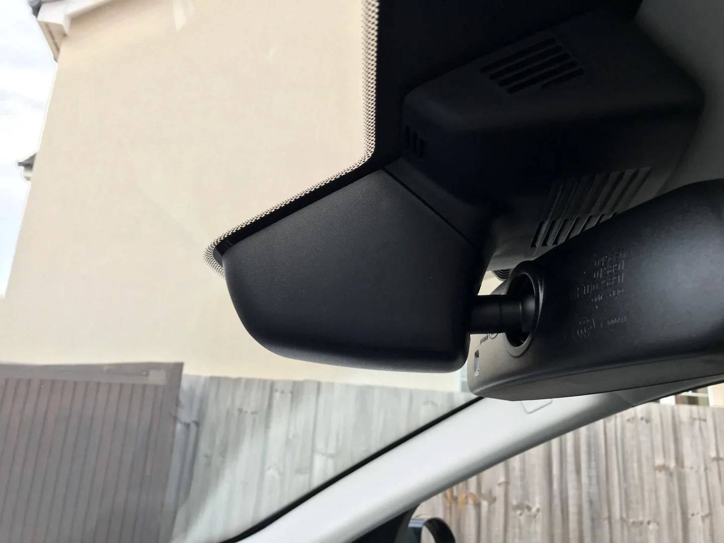

Plastic housing goes all the way out to the screen, no way to mount below it neatly, apart from looking horrific it blocks view out the windscreen:
You have a stepped area at the top, the black sections are where the GPS needs to go and ideally the mount:
en_US
On the passenger side shown here its a neat fit with mount on the black area and just enough room I suspect to fit GPS puck in, but the video output is no good as lens is obscured by the plastic housing. If lens could be closer to the screen it would likely be fine (hence question on alternate mount).
Can't mount on drivers side as it will obscure view.
Should have gone X350 before the codes were pulled... that had the lens in the middle!
That's nice and neat, but I can't get the F50 to fit there, its a bit bigger and the mount is a bit bulkier.
