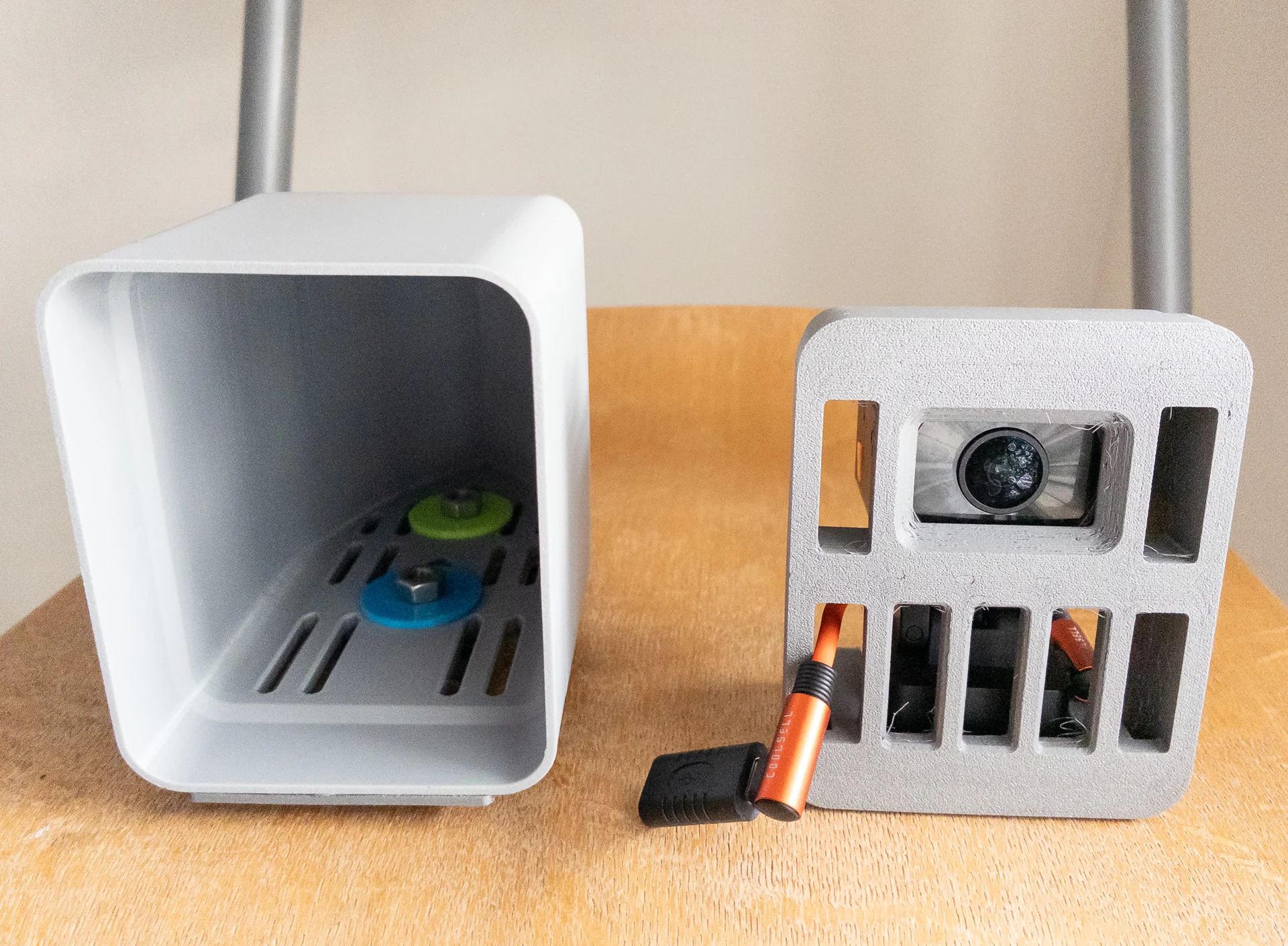

I wanted to mount my rear E1 Pro 4k outside my Odyssey so it would have a better view without light blocked by the tint. This was my solution. It attaches to the roof with magnets and is big enough for a small powerbank, but I usually just run a cable through the hatch.

What A great idea, looks fantastic and very useful. Well done
Interesting, but it doesn't seem like this weatherproofs the E1 Pro in any way. Is this only for use in good weather or do you plan on figuring that out as well for year-round use?
When the vehicle is parked, it protects the camera from rain because of the lip. It rains so rarely in Austin that I haven't driven anywhere in heavy rain. At higher speed there's enough buffeting at the rear, droplets would probably hit the faceplate and go into the holes, but I don't think it would be enough to damage the camera. It can be waterproofed by not having holes in the faceplate, but then heat would be an issue. I think the solid front, top, and holes in the bottom and rear are a good compromise between waterproofing and cooling
Creative solution! How strong are the magnets? I'm not sure if it'd stay on in case of a crash?
These are the common M6 magnets available on Amazon. Each has 6 small neodymium magnets. Two of these is overkill and it takes a lot of force to pull it off the roof. My previous design was smaller and used one magnet, and even that was overkill. I don't think this thing is going anywhere in a crash unless the housing itself was hit
Good to know. With that said, however, wouldn't moisture still be an issue, and also what if the rain hits it at just the right angle to get in? Either way we assume that's not that much of an issue in Austin than it is in, say, Seattle.
