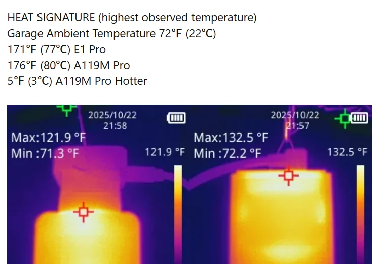

got to say that @Hack_man really gave me some solid insight, mainly that both cameras are strong options, but the A119M Pro is probably the safer pick for my heat conditions, especially since the E1 Pro tends to run warm.
If anyone has additional info or long-term experience, please feel free to share
Thank you for your interest in the Vantrue E1 Pro.
We’d like to clarify one point regarding heat performance: under the same conditions, such as Wi-Fi turned off and the screen turned off—the E1 Pro actually runs cooler. You can also see this in the test data from the reviewer you shared.
By default, we keep both the screen and Wi-Fi switched on to provide a smoother out-of-the-box user experience. However, if you are concerned about heat, you can manually turn off these features, and the operating temperature will noticeably improve.

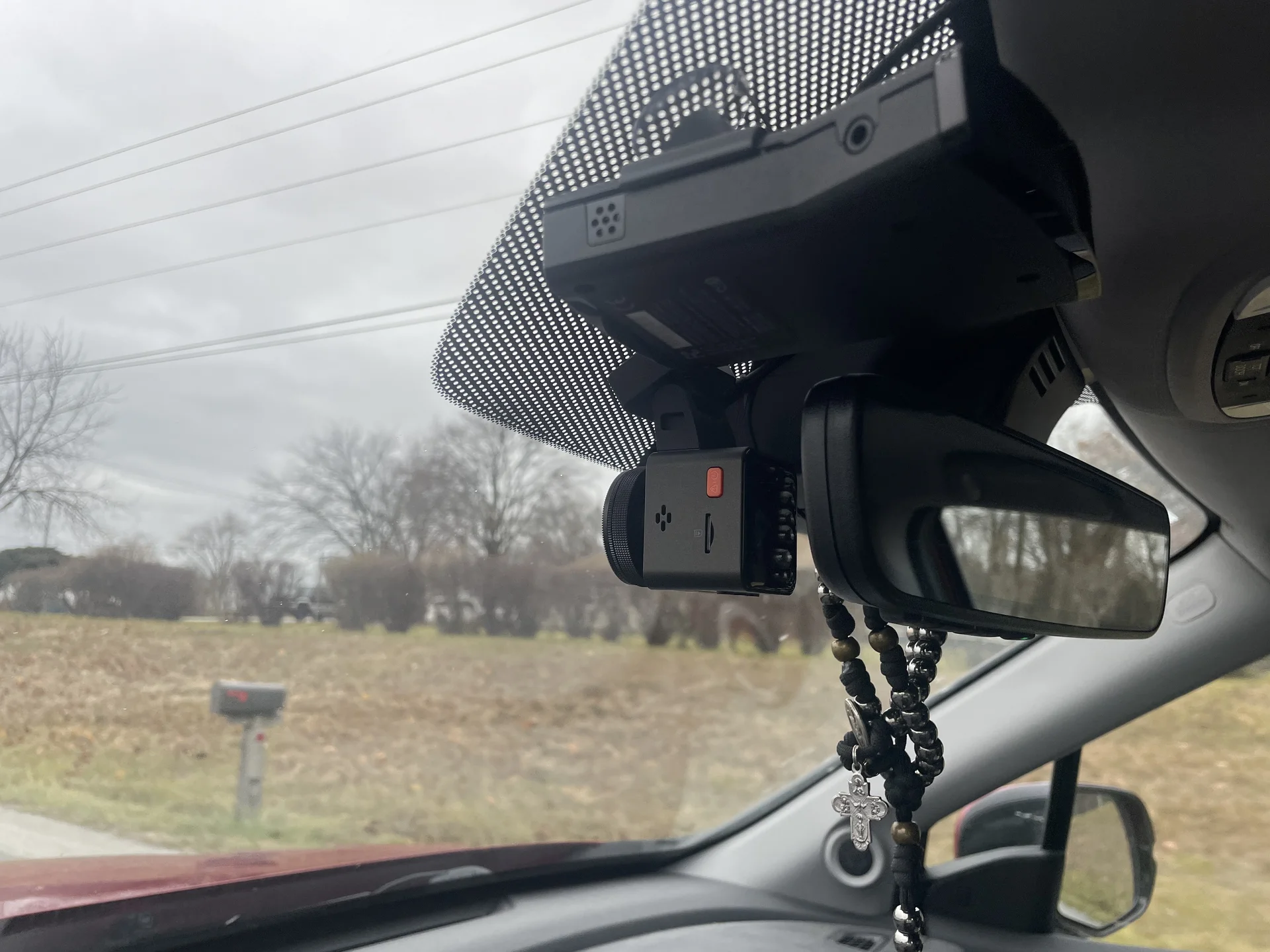

My view. Only the top of the mount is visible. As my truck has lots of electronics up at the rear view mount the slightly narrower mount and slightly smaller size were important to me for mounting so that the camera is not visible while driving.
FWIW, you will notice the mount of the E1 Pro is about 1" to the left of the electronic's housing in my truck's upper windshield.
When I record video I 'see' just a tiny sliver of the corner of that housing. So that is the closest I can mount it to the centerline of the windshield and the camera's view is just below the shade 'dots' on the windshield. These cameras have a wide angle of view so I could not move it farther to the centerline. And given this is a modern truck with lane keeping assistance, auto braking, blah blah blah, the various senses and optical imaging systems in that housing take up a lot of space.
I probably could have fit the Viofo A119M Pro in the same spot, but given it cost considerably more $ and the only real advantage I could see is WiFi 6 instead of WiFi 5, it simply was not worth the added cost to me. There was a $66 added cost to get the Viofo and the Vantrue E1 Pro, with hardwire kit and 256gb card was under $150 delivered to my door.
