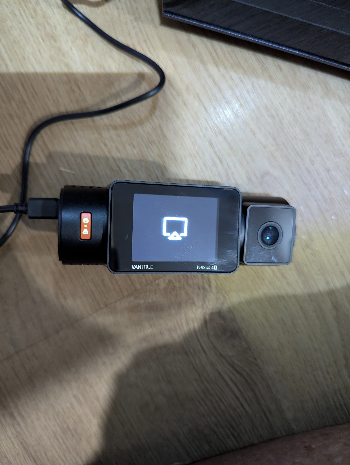

That new rear camera looks much more stable than the old hinged type.
Also looking at the end the new rear camera it needs a new cable too.
