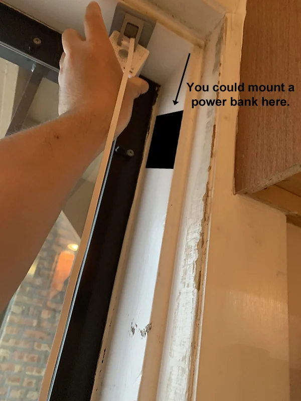

This thing stats on top corner between the security door and main door. The only problem is the cord. When I close the main door, it touches/hits the cord on top or bottom. Can't properly close the door.
So I couldn't finish setting this up today. I may have to keep thinking or maybe get a handyman for help.

That is a fairly expensive camera , plus I notice they don't even say exactly how long it runs on a single charge even in the specs section of the web site. This would be an expensive way to to try catch a squirrel on camera.
As previously suggested, why not just buy a small power bank and mount it on your door frame using 3M VHB tape. Actually, a better solution for this situation would probably be a different 3M product called Dual Lock Tape, also sold as Scotch Fasteners. The product works similarly to Velcro but is MUCH stronger.
You can buy a small 5,000 mAh or 10,0000 mAh power bank for about 20 or 30 dollars. The 10,000 mAh power bank would likely run the WyzeCam for up to 24 hours or longer before requiring a charge. You would connect the camera to the power bank using a very short USB-A to micro cable or just use the one that came with your WyzCam.
You could buy a small Anker 10,000 mAh power bank like this or something similar. It's about the size of a deck of cards and probably weights a pound or so. (maybe less, since they tout how lightweight this PB is.)
After you catch the squirrel or other culprit leaving food at your door, the power bank can be used for other things like running a dash cam when you are parked somewhere.
The combination of your new WyzeCam and a small power bank should provide better performance (runtime) than that expensive IP camera and be a lot cheaper. Plus you already have the WyzeCam.

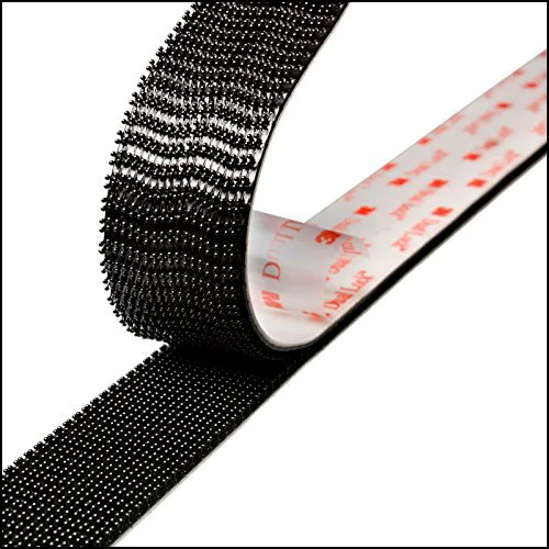

You would attach it to the door frame using several Scotch Fasteners like this.
These come in black or clear and can hold a lot of weight if applied properly with enough tape coverage to handle the weight of the power bank.
Dual Lock Tape comes in rolls or individual squares or rectangles. Probably several 1 x 3 inch strips should do the job.

Thanks for the advice. I do have Anker power banks and may try that . This is a good affordable cam so I won’t return it even if I decide now to use it for this purpose .looks like a good cam for indoor use and even in use in car with the power bank such as when renting car. I got 25ft cord on amazon for $8.
Attached with Anker astro e2 2nd gen. It has 16K juice when charged I believe . I had it fully charged. I don’t know how long this will last. Hope it doesn’t fall on us . The tape seems quite strong cos not easy to remove. I will look at the other tape

That looks OK but that's not how that tape works! The tape is double sided; it is sticky on both sides. That means that you need to remove the protective plastic with the "3M" printing on it from the tape and use strips of tape between the back of the power bank and the door frame. In other words, it would be the same as the typical 3M VHB tape that comes on dash cam mounts for attaching to your car's windshield. The way you used it will work but it's messy to remove and you are wasting a lot of expensive 3M VHB tape! It will be a real hassle each time you need to charge the power bank.
Please consider getting some Scotch Fasteners like I mentioned above. It will make your life much easier when you want to charge the power bank each time because it works like Velcro and so you can remove the power bank and then snap it back on.
Also see this document: "How to use 3M™ VHB™ Tapes".
