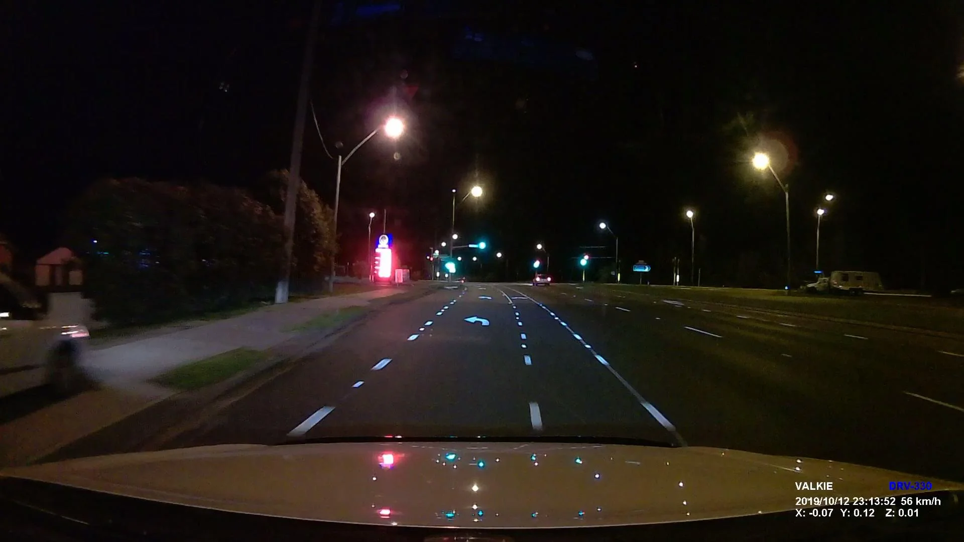

Hi All;
I have just purchased a new Kenwood DRV 330 dash camera
Very happy with the video quality, both day and night.
I have downloaded the Route Watcher II from Kenwood, a brilliant bit of gear, but very limited.
The problem I have is that I want to be able to edit and copy videos, including audio
But the audio only works with the Kenwood route watcher software (HTML file I think holds this information)
I have tried several various editing programs, but while they all do a very good job at editing the video, I get no sound at all.
Am I missing something?
Is there a trick I need to know or perhaps a program that can keep the sound?
I love the quality of the Kenwood video, I have had a few Dash cameras, and this is by far the best.
But this audio thing annoys me no end.
Please help
