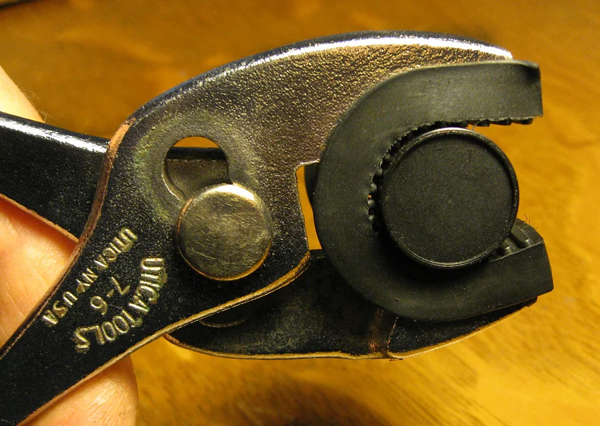

yes some times you have to use pliers on the lens to grip it good enough, i use a thin pice of leather in between the lens and pliers when i have to go there, and off course not grip the pliers too hard and crush the lens.
I use one just like this.
You can try applying some gentle heat with a hair dryer or heat gun. Just be careful not to cook anything.
Yeah exactly, I'm the kind of guy that actually would..... Hahaha, no kidding though, I'll think about it for a few days, and maybe try the F1. 2 lens on the X....

Its not so much about applying more force, its more getting a little better grip on the lens, holding the camera or mount assembly while unscrewing have never been a problem for me ( use hands in that end )
yes.
Yeah, it's about getting a good grip but also about being able to apply force without damaging anything.
most times the first time i try to loosen a lens with the plires the lens slip on the leather, so i apply a little more pressure to the pliers and that normally do the trick.
I have been wanting to replace my leather with a pice of rubber, but i keep forgetting to cut a little pice off from my friends excess garden pond liner.
I like that pond liner as it are a harder type of rubber, so it only being 1.5 mm will not be a problem though i intend to use it folded over so i have 2 layers.
So far i have not crushed a lens this way. ( knock on wood )
I have a pair of those pliers and that amount of force will never be needed
Just use common sense and remove as much rubbish before starting to twist the lens with your BARE hands
I dont have brawny Aussie hands, so some times i need tool aid.
