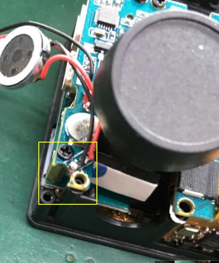

If there is really a heat issue, the screw is probably touching a component. If you can fix it, then we can send you a picture and you can solder instead of using the screw. Or you can maybe send it back to us and we can fix it for you.
I can solder if necessary. Please send me a picture and instructions on how to do the repair. Thanks.
NOTE: SJCAM DOES NOT recommend removing the faceplate or doing work by yourselves. There is a connector cable attached to the Faceplate so be careful not to break/tear it when lifting the faceplate.
If it isn't the board, then it may be the sensor part of the unit.
The picture shows that we are now soldering instead of using a screw on that corner. If you have a screw, then it could be touching the other soldered part of the board.
If there is no touching in between, then it could be a sensor issue. These units do get hot depending on length of continued use / weather, etc. If it is unbearably hot, the we recommend opening a ticket at support.sjcamhd.com and we can maybe begin a RMA process.
Again, Damaging the Board and/or removing the faceplate could void your SJCAM warranty.
