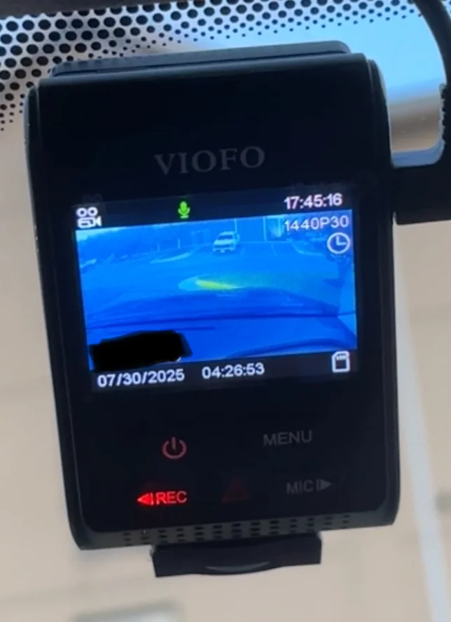

I installed the A119 yesterday. It’s plugged into the adapter. It sometimes comes on when the car is turned on and some times doesn’t… or it will come on and then go off… or I can manually turn it on and it goes off within about 5 seconds. Any help would be appreciated. I attached a picture of the screen when I turned it on manually. It only stayed on about 3 seconds.

I’m using the usb adapter that came with it. It has 2 inlets and plugs into the accessory plug on my dash. By going off, I mean it shuts down. The rec light goes off and the unit powers down. I’ll check the Privacy Mode, but why would that setting cause the unit to turn off intermittently?

The power cable you're using does not appear to be the Viofo cable that came with the camera. Is this an aftermarket cable? Is so, test with the supplied cable.
I installed the A119 yesterday. It’s plugged into the adapter. It sometimes comes on when the car is turned on and some times doesn’t… or it will come on and then go off… or I can manually turn it on and it goes off within about 5 seconds. Any help would be appreciated. I attached a picture of the screen when I turned it on manually. It only stayed on about 3 seconds.View attachment 83397
How do you power the camera? Please use the original car chager that came with the camera to supply power from your cigarette lighter directly to test.
