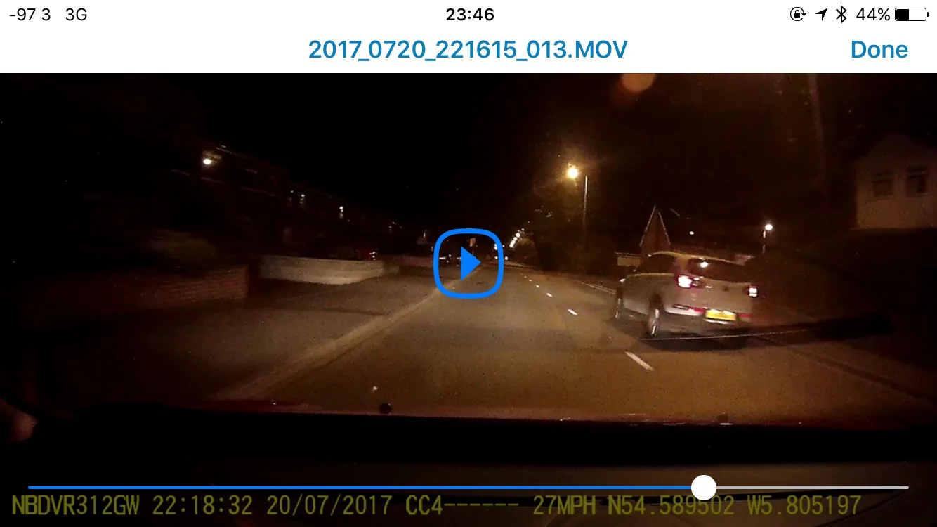

IMG_6779.PNG I have rotated it several times, in the day time the dash reflection isn't there but the night I do get some. Here is a more recent picture after some more fiddling tonight.. you can still see the reflection of the dash and no way of reading the number plate. Daytime isn't much better.

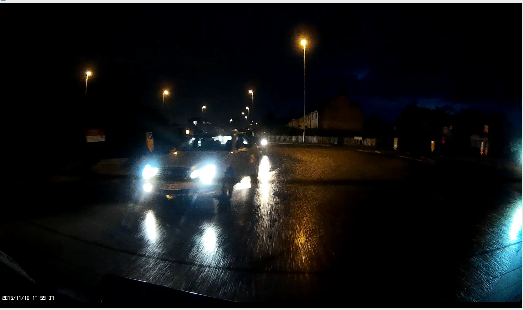

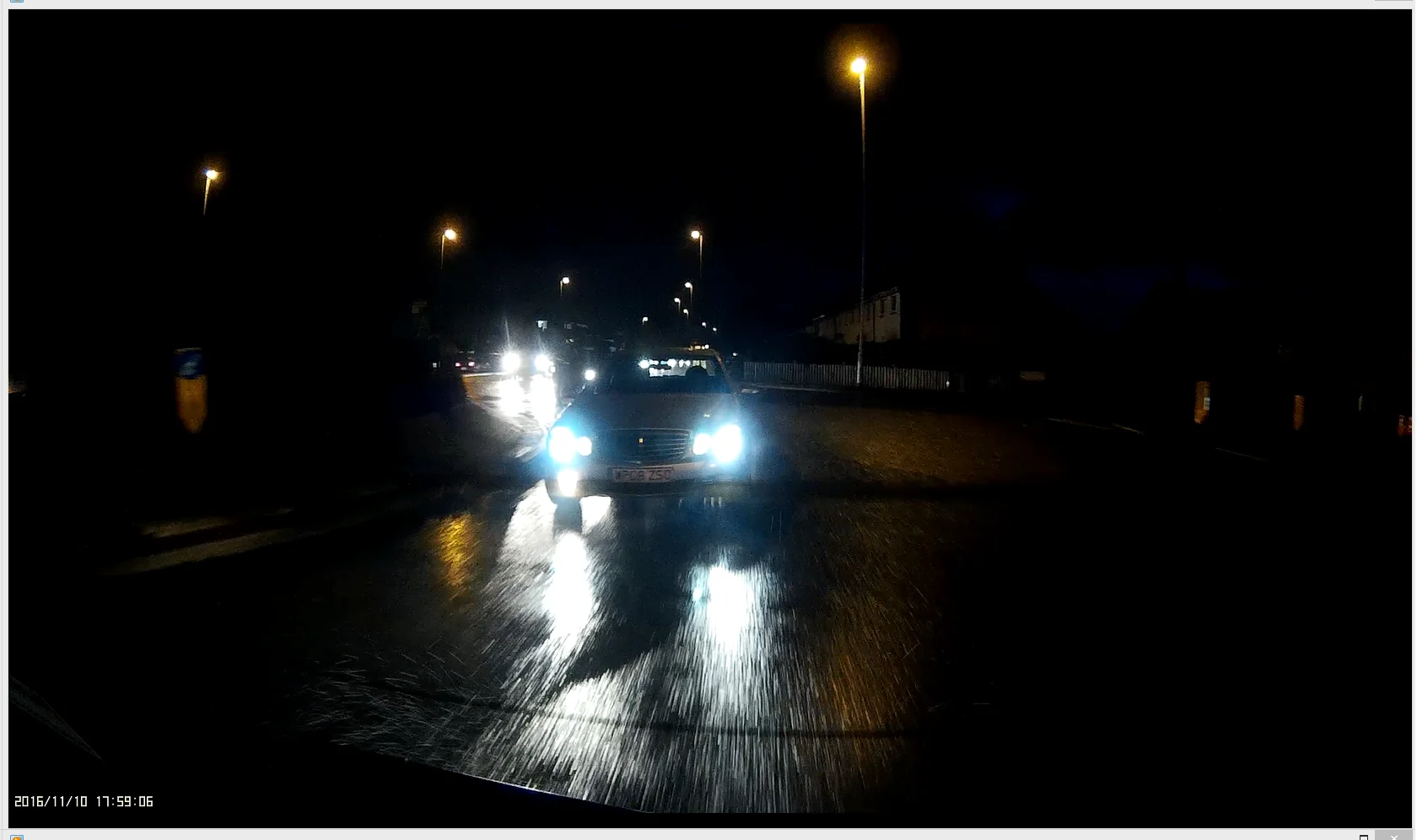

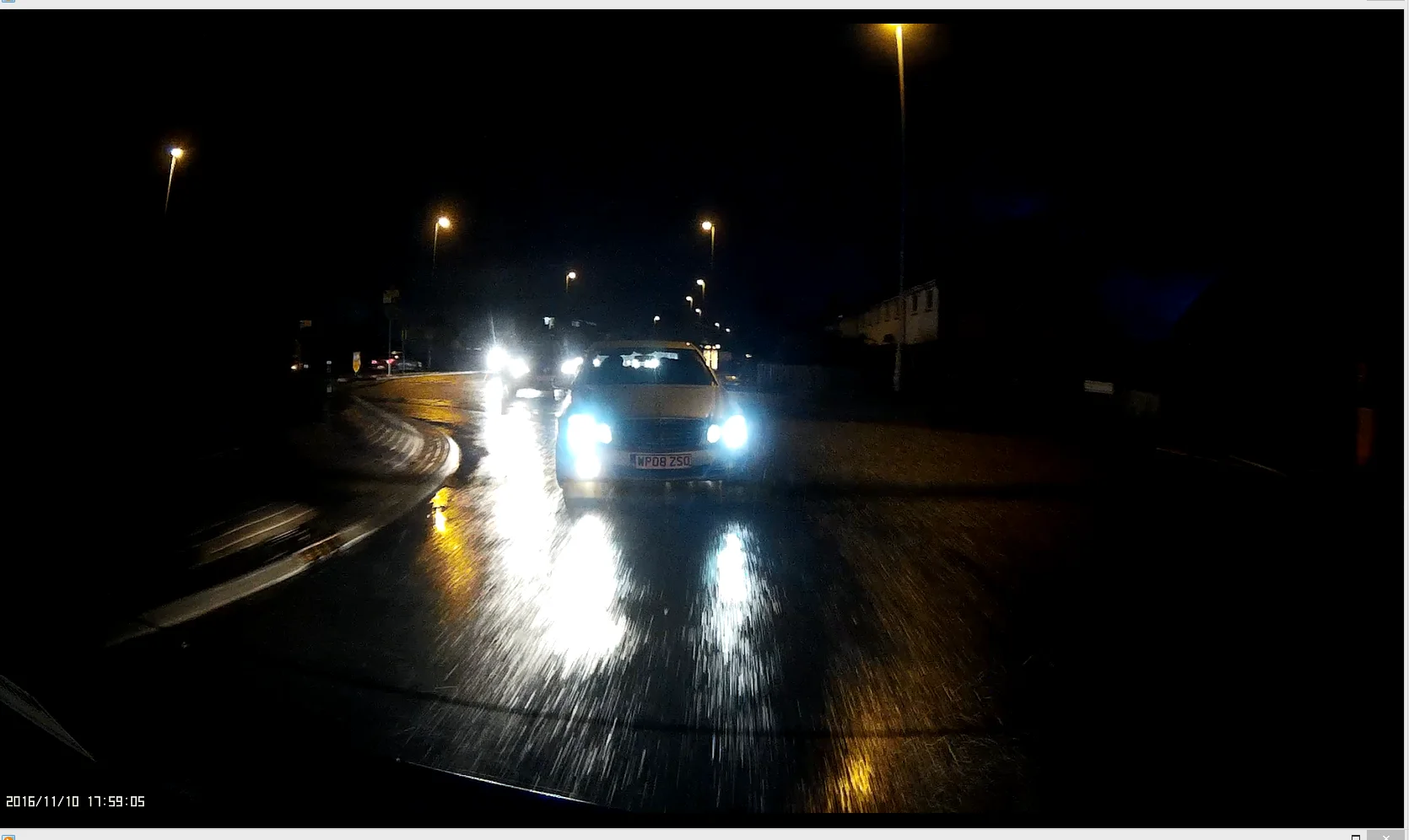

As promised: some screenshot captures from my wife's Mobius 1 (C2 lens) mounted in the rear of her car. From the pictures you posted earlier I suspect the NB312GW is using the same imaging sensor.
Images were taken on a dark, wet, winter evening on her commute home, with approximately one second between images (see time stamps).
In the first few pictures my wife is turning around the roundabout which causes the image of the car behind to move across the sensor and motion blur loses detail.
In the middle pictures the car is following my wife and the image of it remains mostly within the same few pixels on the sensor, allowing its plate to be read.
In the last few pictures the car following my wife starts turning and as it moves across the sensor's pixels, motion blur causes loss of detail again.
