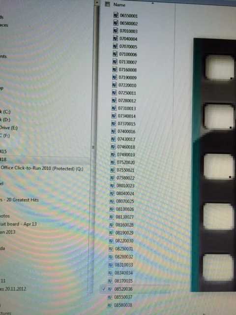

Well I know this is a old thread and mine is a 402g on firmware R08, BUT I had EXACTLY the same happen to mine a few days ago, It recorded the whole 2 hours before no problems in the 3 min sections as it should, then I had someone hit my door so just left it running ON CAR POWER and when reviewed it failed to record that 3 min section and the next couple of sections after, it was only when the unit was restarted it functioned correctly, run file recovery, nothing, it had not attempted to record anything to the SD card, The only thing different was the rapid stop after and the ABS braking kicked in so perhaps the G sensor overloaded the firmware or something so it crashed being able to record. Nextbase was not interested, Karen the customer manager said Graham the designer would be keen to talk to me, well he doesn't seem to be so they are not interested, its not the SD card as its a genuine sandisk 32gb bought from a approved supplier and has recorded every file in the past just fine. very annoying you buy this unit in case something happens and when it does it fails to record, what a product!
EVERY FILE except 8:40, 8:43 8:46
Factory settings except G sensor turned off as was fed up of it automatically marking files which it would then never delete and just leave clogging up the SD space
