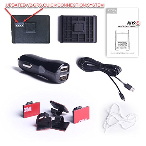

Any pictures of it?
This one?
But no updated picture of the back of the camera? Or is the back unchanged?
V2 camera Back looks the same but isn't compatible with original V1 GPS mount. (And the other way is true as well, new V2 GPS mount is not compatible with V1 A119/A119S) designated pin out is different per contact. The serial number will say V2 on the back.

This is why EVA compression foam was also added. Just add a stick on piece and it's solid. (Not shown in photos yet)
This still blows my mind... WHY would they redesign the mount and NOT make it backwards-compatible????
I think need complete new mount design.
There problems not only with contacts between mount and camera, but plastic part which connects mount and camera too need improvement.
My guess is that it was to increase over all power stability moving power connections to the most stable part of the mount. (Assuming here)
My guess is that it was to increase over all power and stability moving power connections to the most stable part of the mount. (Assuming here)
This solution reminds of how a battery slots into a mobile phone and convinced me to buy the V2
The GPS is powered on top and doesn't need another cable
