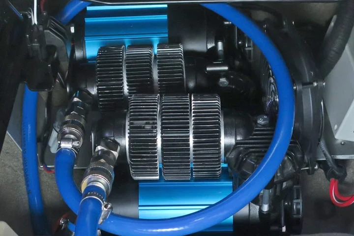

These custom external and internal heatsinks on an air compressor makes a massive difference. The outside heatsinks have silicone thermal paste between the surfaces. The internal RC heatsinks do not have much contact but anything is better than nothing.

Trial & error... lots of it. My earlier heatsink trials with RC heatsinks (blue) & added 2 other heatsinks. Then the earlier photo was an improved version.
On the right of this photo a high volume 120mm fan added to compressors to increase cooling effectiveness.

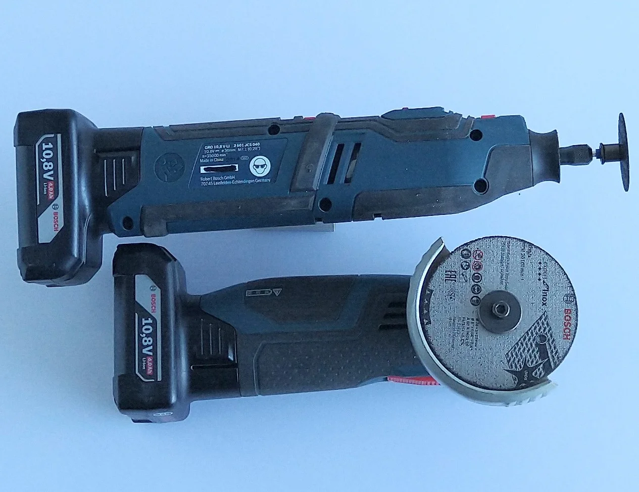

If you want to cut heatsinks to size these tools work a treat. The 76mm angle grinder's first cut through 60 x 3 steel pipe is 2 minutes. Handy for all sorts of things including overhead work like grinding back rusty archbars to save your arms after an hour!
